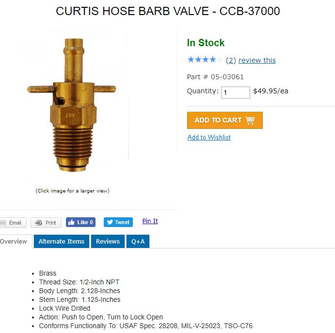

I am servicing the fuel system on my Piet.
1. External drain - for water testing.
The tank is mounted in the nose over the passengers feet.
Water testing the tank means the risk of spilling fuel in the cockpit..
Does anyone know of a drain with a nipple that can purge the fuel to the outside into a catch pan?

Kenneth; one more thing. If you are thinking of the kind of water drain such as you find in many certificated aircraft where you pull a knob in the cockpit to allow the contents of the lower part of your fuel system to drain out onto the ramp, you might want to rethink that. Yes, you can certainly find spring-loaded valves that are actuated with a knob and cable in the cockpit, but you'll never know what came out of the drain unless you can inspect it, and it is no longer considered to be safe or environmentally responsible to just allow fuel to dump out onto the pavement or apron under the airplane. If you can operate the valve manually (fingers), here's one way to do it with a drain hose that you can route outside the cockpit:
