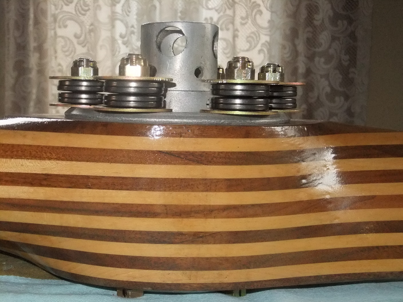

Good subject, Oscar.
Marc Zeitlin has developed an installation system using Belleville washers.
Information here:
http://cozybuilders.org/Prop_Bolt_Bellville_Washer/
I've used this method on several props in Minnesota with extreme temperature / humidity swings.
Here is a picture of one of the installations:
(Yes, I know it isn't safety wired...)
