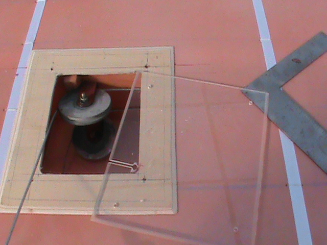

I am seeking information and suggestions for wing inspection holes and covers. Where are you locating them, how are you creating them, etc. I have some pictures showing glued in rings but not cut out with covers and other pictures that don't show any at all around the strut mounting area. I saw one at Brodhead in past years that had Plexiglas covers over a plywood frame that had been attached inside the wings. I would really like to hear how that was done. Any suggestions would be greatly appreciated

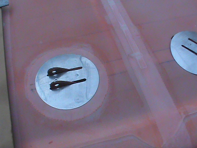

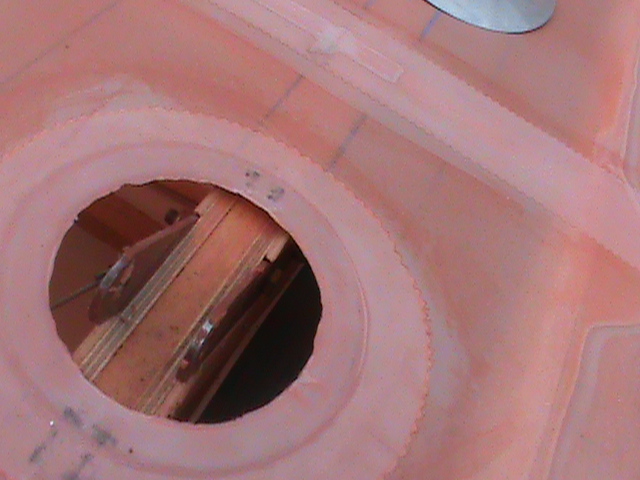

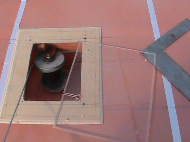

First off use a clevis on all your cables, guys short cut on the bay cross cables in the wings and the thimbles stretch or flatten out and the cables loosen up. I put an inspection hole on each out board strut connection to check the bolts on the spars, little tricky but worth it. and my new piet has better inspection ports on the pulleys see pics
