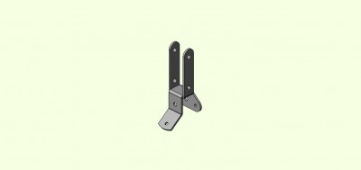

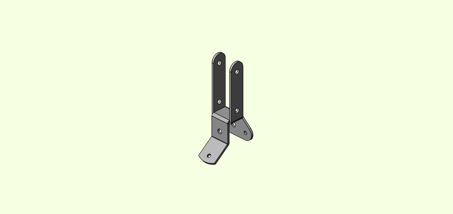

A few years ago, I "captured" all of the Pietenpol sheet metal pieces, including simple pieces, and welded brackets using SolidWorks. After all of the Solid models were completed, I took them to a shop I've dealt with in the past, and they made a complete set of Piet metal pieces to prove out the drawings. These "proof" pieces were NOT made using 4130, just some 1020, or whatever they had laying around, as they were not to be flown.
The drawings were something I've spoken with EAA about, and my contacts there reached out to Don Pietenpol, who was not interested in working with me. They also referred me to Doc Mosher, but nothing came of that either... Perhaps I'll offer drawings at Brodhead in the future; not sure yet.
My drawings were made in sets; one was for the Aileron brackets, another for the Jenny landing gear, and yet others for tail feathers. All of these were made using proper orthographic projections rather than the crude sketches put together 90-ish years ago. DO NOT DISS ME WHEN I CALL THEM CRUDE SKETCHES! They have stood the test of time, and while they convey the correct dimensions, etc., they exhibit poor draftsmanship. Orrin Hoopman may very well have been self taught, and I'm NOT dissing him either, simply stating observable facts.
One item missing from all of the original prints, and F&G manual, is the grain direction to be used for the pieces. In case the reader isn't aware, bending with the grain is a NO NO, as it produces micro cracking which can produce failures at a later date. My prints have grain directions shown so the builder can fab the parts properly. I've attached a couple of samples to review.
Saving the original work into .dxf, or .dwg formats would be pretty simple, taking a few hours to make a complete set for the airplane. Question is, would anyone be interested in them? If so, I've thought that the entire set would go for around $120., with a license to be used by only one builder. These might sound expensive, but the files would also come with drawings showing all of the details and notes... and printing cost alone is around $70. Since there are 36 pages, this comes to around $3.30 per page.
Take a look, and please give me some feedback, but remember, I'm not disrespecting either Bernard or Orrin, only stating that the original prints were a mess, and I've cleaned them up adding length to marginal fittings, and edited them extensively.
Finally, to answer Gene's question... Ken Perkins had a relationship with his community college, where he took the Waterjet 101 Classes over 20 times, making and selling waterjetted parts to many on the list. Since he is no longer with us, his pieces are no longer available.

Re: Waterjetting
Tom; nice work. If the sample "turnbuckle fitting" is the part I'm thinking about, it is PRECISELY one of the awkward conditions that I've encountered on my airplane. Either (or maybe both... I don't remember) at the top of the forward lift struts and the cabane struts, if you put a bolt through the hole in the fitting with the head up, as is the general recommendation so gravity will hold the part in, you have to have the bolt already inn the hole when you install the fitting because there is no way to insert or extract it once the fitting is in place. If you install the bolt later, it has to go in from the bottom, contrary to good practice, and you need to have the washer and nylock nut in place over the hole as you insert the bolt because there's no other way to do it. Same thing with a couple of places where fork-end turnbuckles are installed using clevis pins, because there is no way to install the clevis pin from the top... you have to install them head-down and then try to get the washer and cotter pin installed in a tight wedge-shaped space.

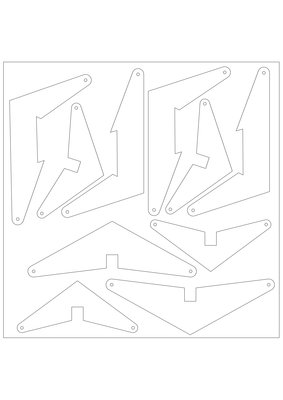

Ken Perkins water jetted the steel parts for several years. He made many sets of them. He would take a water jet course at the local community college (with the senior citizen discount) and cut out multiple sets. Before anyone asks, I don't have his drawings. He had them on USB drive and it wasn't found when he died. I'm not aware of anyone having problems with his parts. The comment on grain direction is correct, you have to be aware of the grain direction.

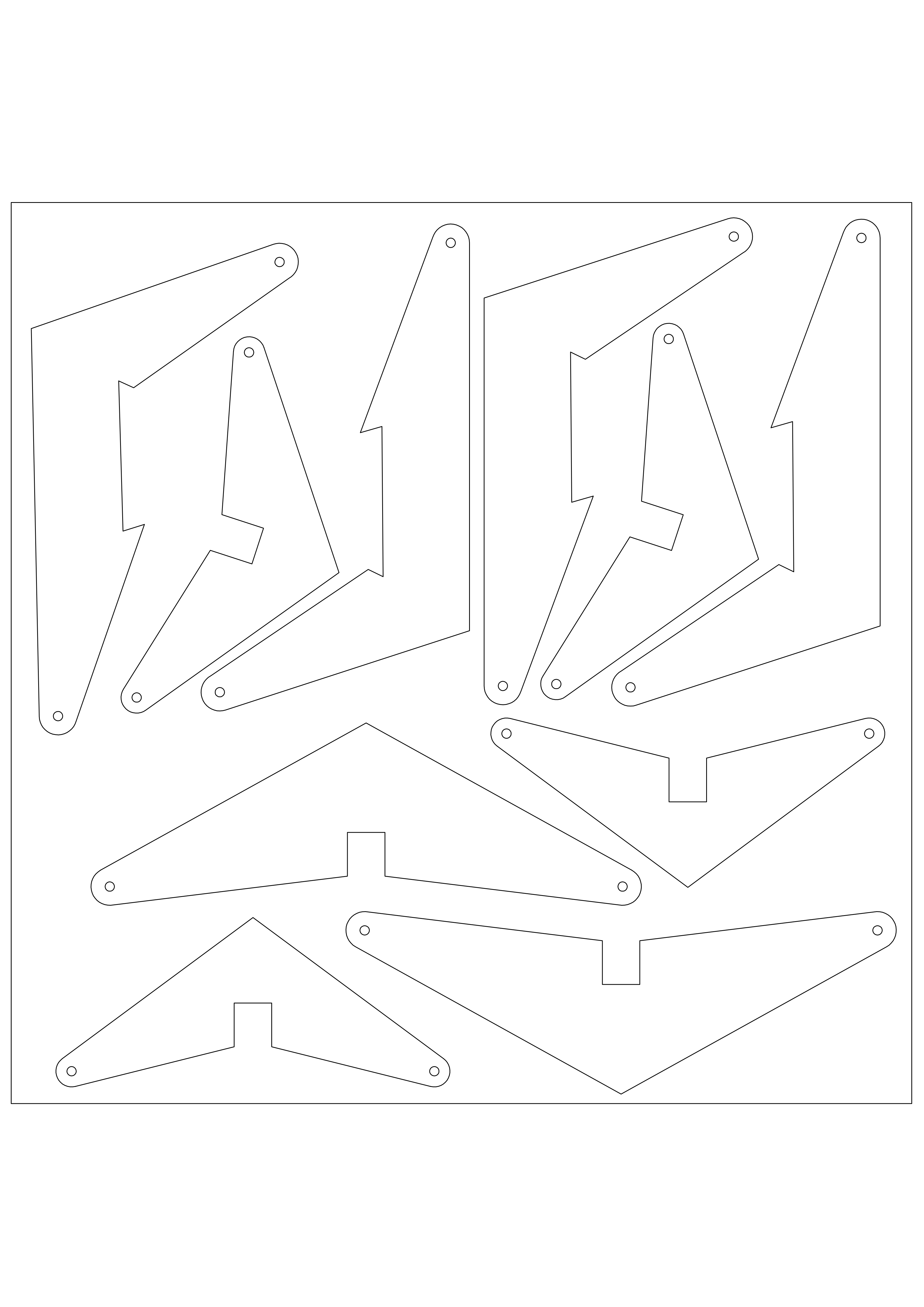

Re: Waterjetting
Oscar,
I was going to send this in to Pat Weeden for a future Newsletter but this has come up on this forum, so I will post it here AND send it to Pat. This is simply a repeat of a post I wrote on the Pietvair Forum not long ago. I try and exercise my "dual citizenship" on both this and the Pietvair Forum so I hope that this helps -
______________

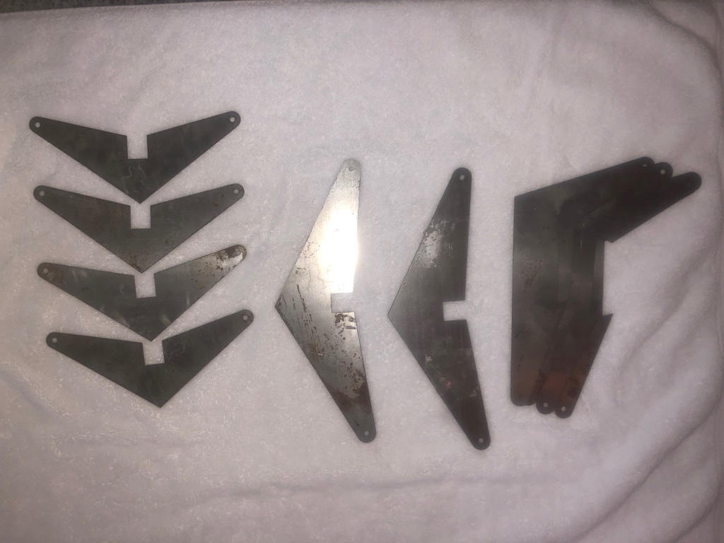

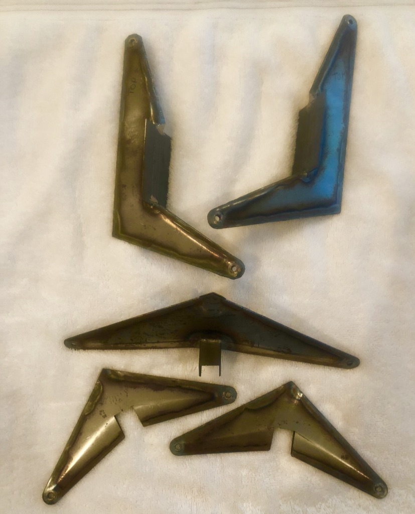

I was not happy with the horns I was cutting and forming in my shop, so I searched out for a source from which to purchase CNC waterjet cut horns, and only found one source on the Internet -
www.icarusair.net/parts/
I spoke with the guy, Steven Richards (Cell - 806-777-3966), and he seemed very nice. They cut them from .025 Chromoly with the tabs attached. He had a delay in his production, and I wanted .032 chromoly horns (although I am sure that .025 is sufficiently strong). So I went in a different direction.
I had drawn my horns in pdf, and liked mine without the tabs (I plan to do like others and weld in a U-channel instead of bending the tabs.), so, long story short, I sent the pdf file off to a graphic design guy in Bangladesh (posted the job and requirements on fiverr.com), and got the CAD file back 3 days and $20.00 later. Here is the pdf of the finished file. You can see that I was able to fit all 10 horn halves on an 18X18 sheet -
Not to drag this thread out, but I then found a guy online that allowed me to drop ship him the metal, he water jet cut the horns from the .dxf file I had made, and shipped them back to me. Here is what I got -
I formed them in my shop, then took them down to my welder, provided him a short piece of 3/4" X 3/4" X 0.49 rectangular tubing (ACS Part #03-12800 with one side cutoff to make it a U-channel that fits perfectly) as well as two 1" X 3" pieces of steel for the aileron horns and he welded them up, as shown below -
I spoke with Darrin at LS Brackets, and said he would do the same deal for anyone else. Here is the contact info for them -

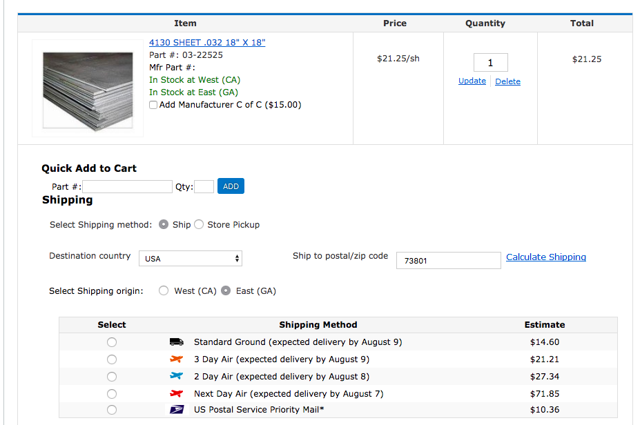

Here is the pricing -
Metal ordered and drop shipped from Aircraft Spruce direct to LS Brackets in OK - $31.61
Waterjet cutting charge ($55.00) and return shipping ($12.50) - $67.50
So, for a hundred bucks you can either have the Icarus Aircraft horns with tabs cut, or mine without. I have attached a link to the CAD file below, in the event you already have access to a CNC machine where you live. Feel free to download the file by clicking on the link below and use it. I would caution you about laser cutting these, as it hardens the edges and makes it harder to weld, or so I am told.
https://drive.google.com/open?id=1Dvc10 ... 1ao1C8laLP
You probably are thinking, "Terry, why did you go through all this just to get your horns cut?" I would have to say that I am much happier with the CNC metal cutting capabilities than my own personal abilities. It was definitely worth $100.00 to me to do it this way. YMMV.
One last thing - the plans show that the holes in the horns are 3/16" diameter. I ended up drilling them out to 1/4" and welding in 1/4" tubing that has a 3/16" inner diameter just as others have done.

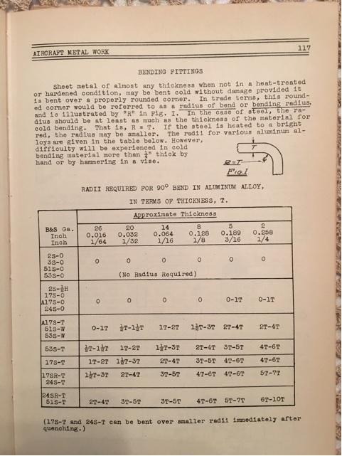

Re: Waterjetting
Tom,

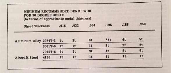

Bending sheet metal with the grain isn't actually a "NO NO", it just has to be approached differently. When bending with the grain, a larger bend radius must be used than when bending transverse to the grain. However, for optimum strength, and the sharpest possible bend radius, bends should be made transverse to the grain. Speaking of bend radius, I noticed that the drawing TBF9001_AX illustrates a bent part, but the part drawing doesn't show a bend radius. With the grain direction as shown, the part should be bent with a minimum inside bend radius equal to 1.5 times the thickness of the part.

Re: Waterjetting
Bill, et al,
Sorry it has taken so long to put this together, as I've been on two trips and gone thru a total hip replacement since the last time I was able to post...

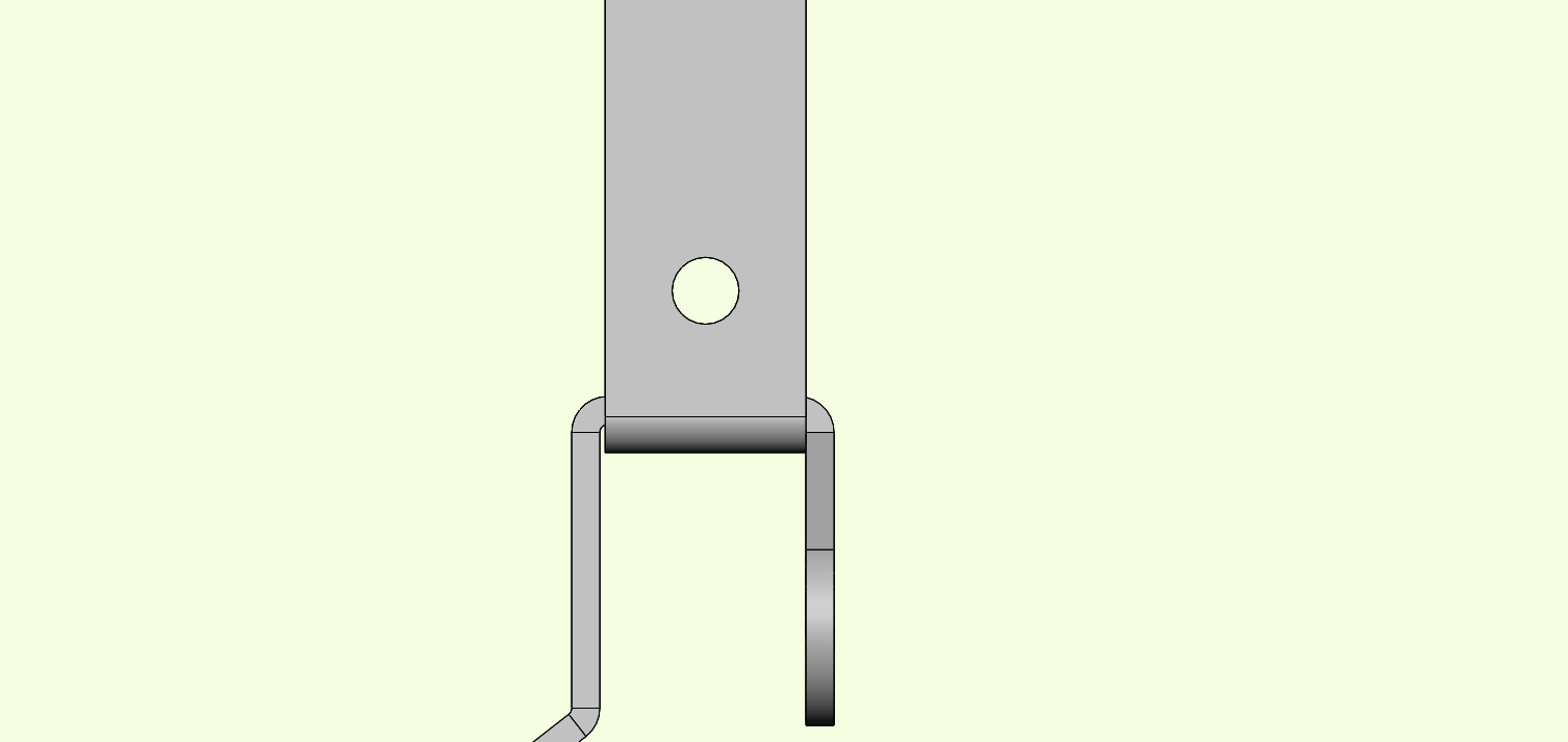

In response to your comments regarding the bend radius shown on the prints I uploaded previously, please note that these were hastily added, and were Revision AX, the X implying pre-production. Guess I should have chosen the prints more carefully, but, oh well, at least I get a chance to clarify in this post.
As seen in the A Revision print for the small angle bracket, TBF9001, attached, the radius of the bend is clearly called out. This is carried throughout the entire set of prints I captured in SolidWorks to create the pdf's, and dxf's that I mentioned in a previous post. With over 140 design files in my Piet Metal Fittings folder, I've got a substantial time investment in the package I've put together.
As far as the comment on the bend radius, I'd defer to the USAF, FAA, and historical references shown in the attachments. The first of these is from Sportplane Construction Techniques, Bingelis, p 44, 1998, and the second is from Aircraft Maintenance, Brimm & Boggess, p117, 1940. Both of these pretty clearly suggest the minimum bend radius for 4130 is to be "1T" i.e., one material thickness. That's not to say 1.5T cannot be used, but a larger bend may make it difficult to make a tight assembly as shown in the UCF4001, the Upper Cabane Fitting. Worse, a larger radius may create an eccentric load, or interfere with the bolt head. Increasing the radius should be done on a case-by-case method ensuring that the results derived are the results desired. Note on the Cabane fitting the angled leg has been extended - as Oscar point out - to ease insertion of the bolt.
Hope this helps...

Re: Waterjetting
This is the info I used when working on certain large aircraft.
