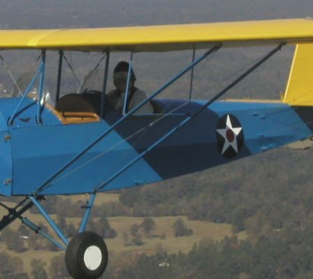

Tbopper; those are jury struts. They're very simple braces that help prevent the wing struts from buckling under negative-G loads and also help prevent the struts from getting into any sort of harmonic vibration. It is generally agreed that it's best to place the jury struts either above or below the midpoint of the wing struts so that it's even more difficult to create harmonic vibration in the struts. The ones you're describing form a "U"-shape and that's the way they are on my airplane (see picture). Mine are simple 4130 steel tubes with flattened ends, attached to tabs on the undersides of the wing spars at the top and to bolts that are welded into the lift struts at the touch points on them.

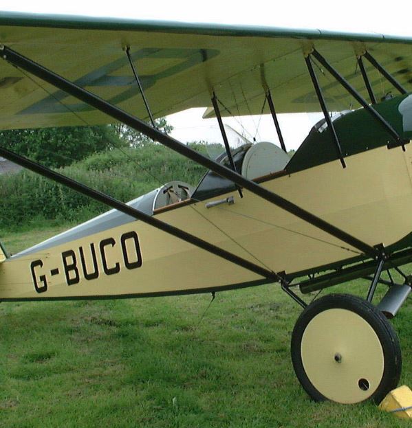

There are older Piets flying with no jury struts at all, as well as some with just the verticals from each strut up to the underside of the wing spars (no cross-piece between them), and I believe the UK Piets are approved with just the leading edge vertical jury strut as on Alan James's beautiful G-BUCO, here:
download/file.php?mode=view&id=643
