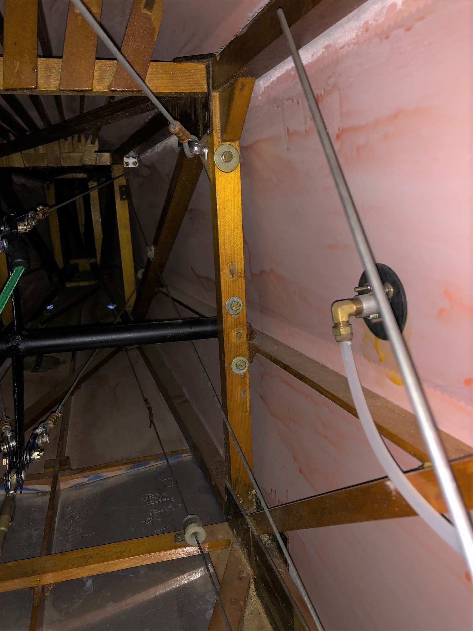

Here's how the rudder cables are routed on 41CC. Series of five pix below. I'm not sure why or how the server manipulates the pictures, but despite my best efforts, some of them get rotated a different way than I want them to. Sorry about that.

Fourth shot shows the two cables headed back into the tailcone. The rudder cable passes through a nylon fairlead on the diagonal member because the cable has to be offset a bit to miss the elevator bellcrank walking beam. Then right before it exits the side of the tail, there is a Micarta fairlead that steers the cable to the outside of the fabric to clear the wood upright. The tailwheel steering cable also passes through a fairlead on the floor crossmember before heading out the bottom of the tailcone where a small patch of light is visible.
Last shot shows where the rudder cable exits the tailcone on its way to the rudder bellcrank, clearing the leading edge of the horizontal stabilizer.

Oscar, thank you so very much for the time and effort to post these wonderful photos. They definitely clear up a number of questions I had, and I truly appreciate it!
