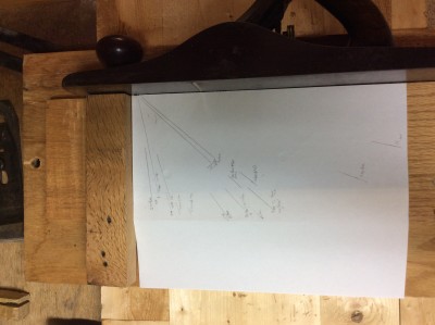

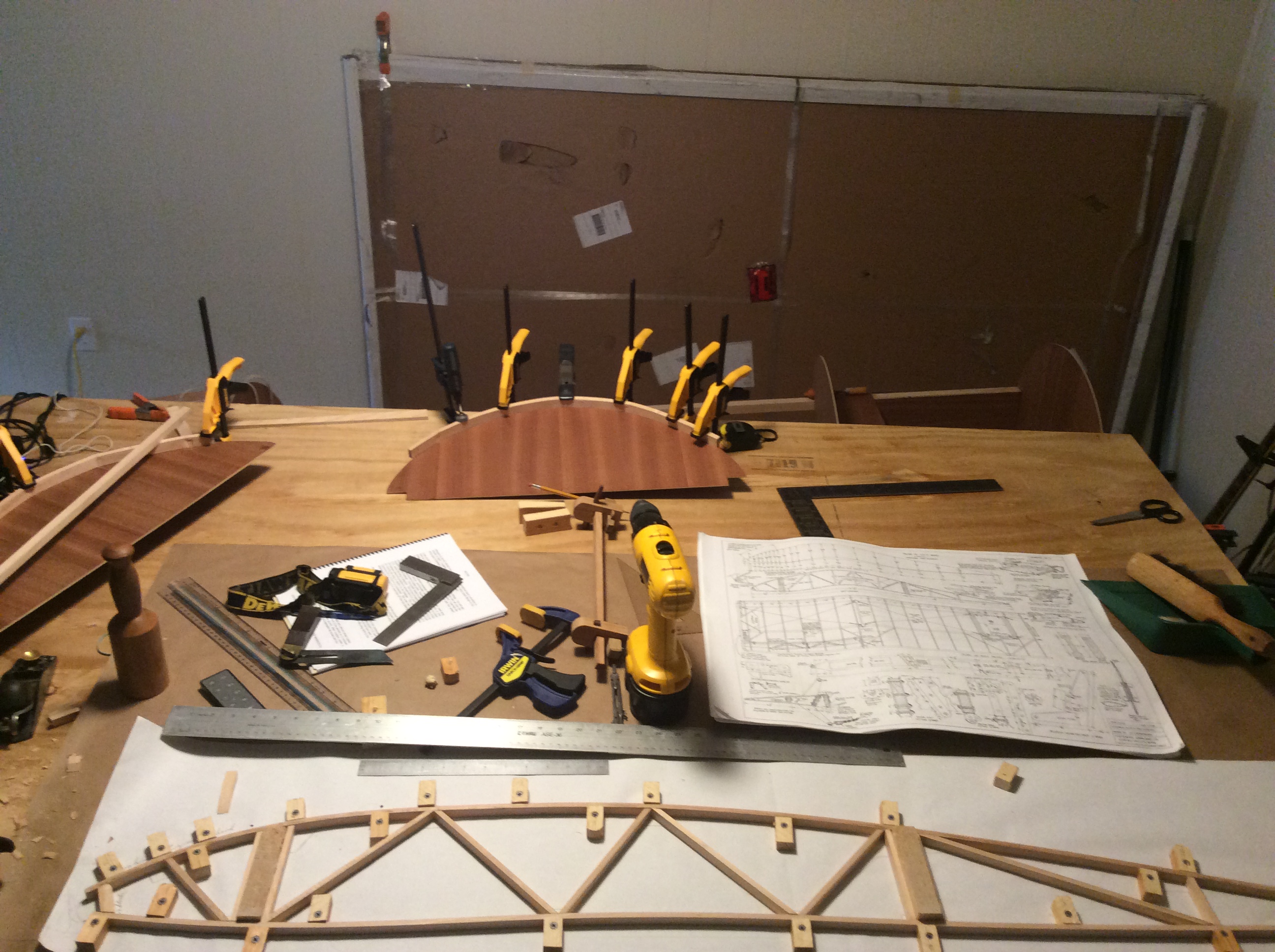

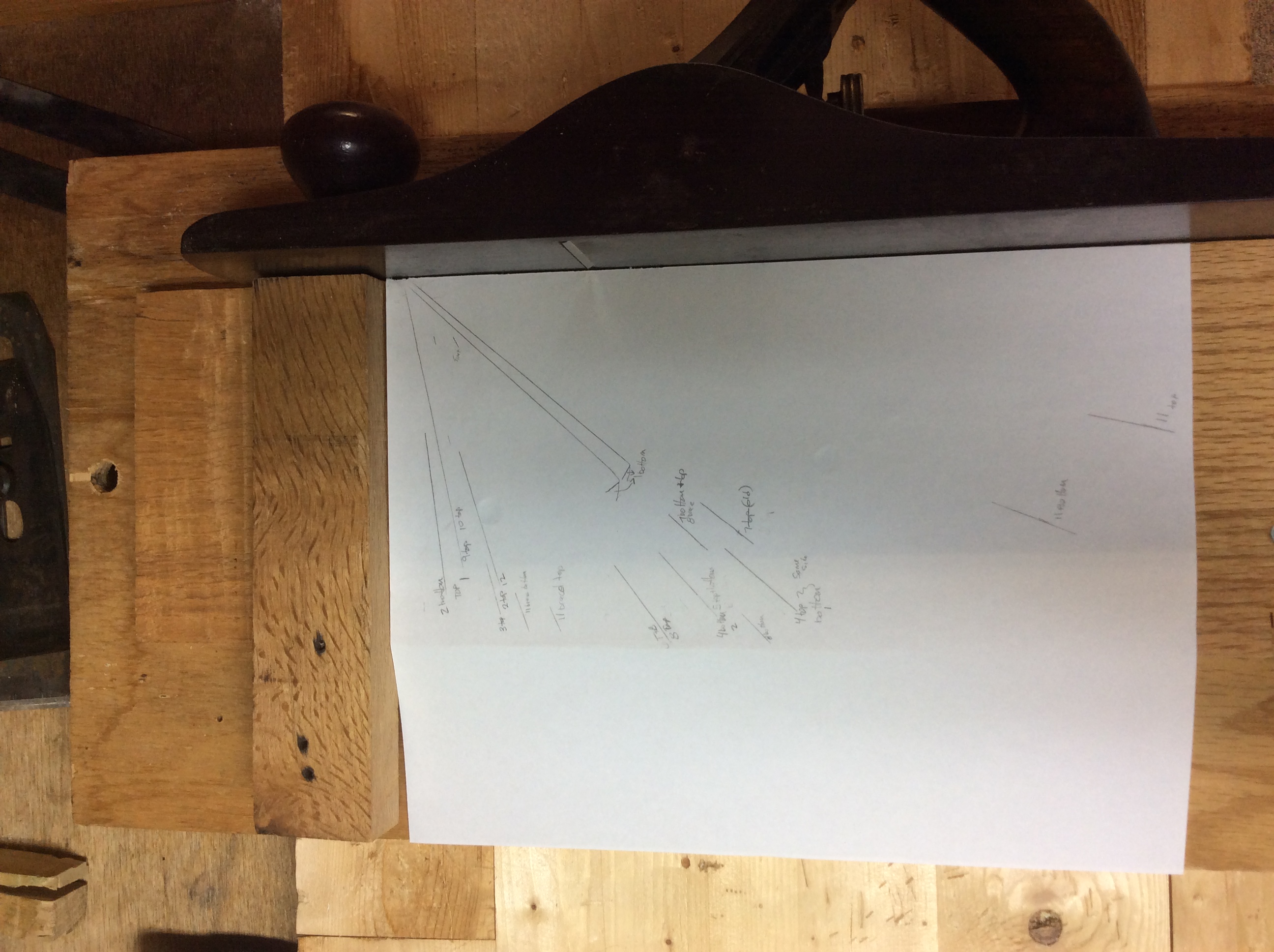

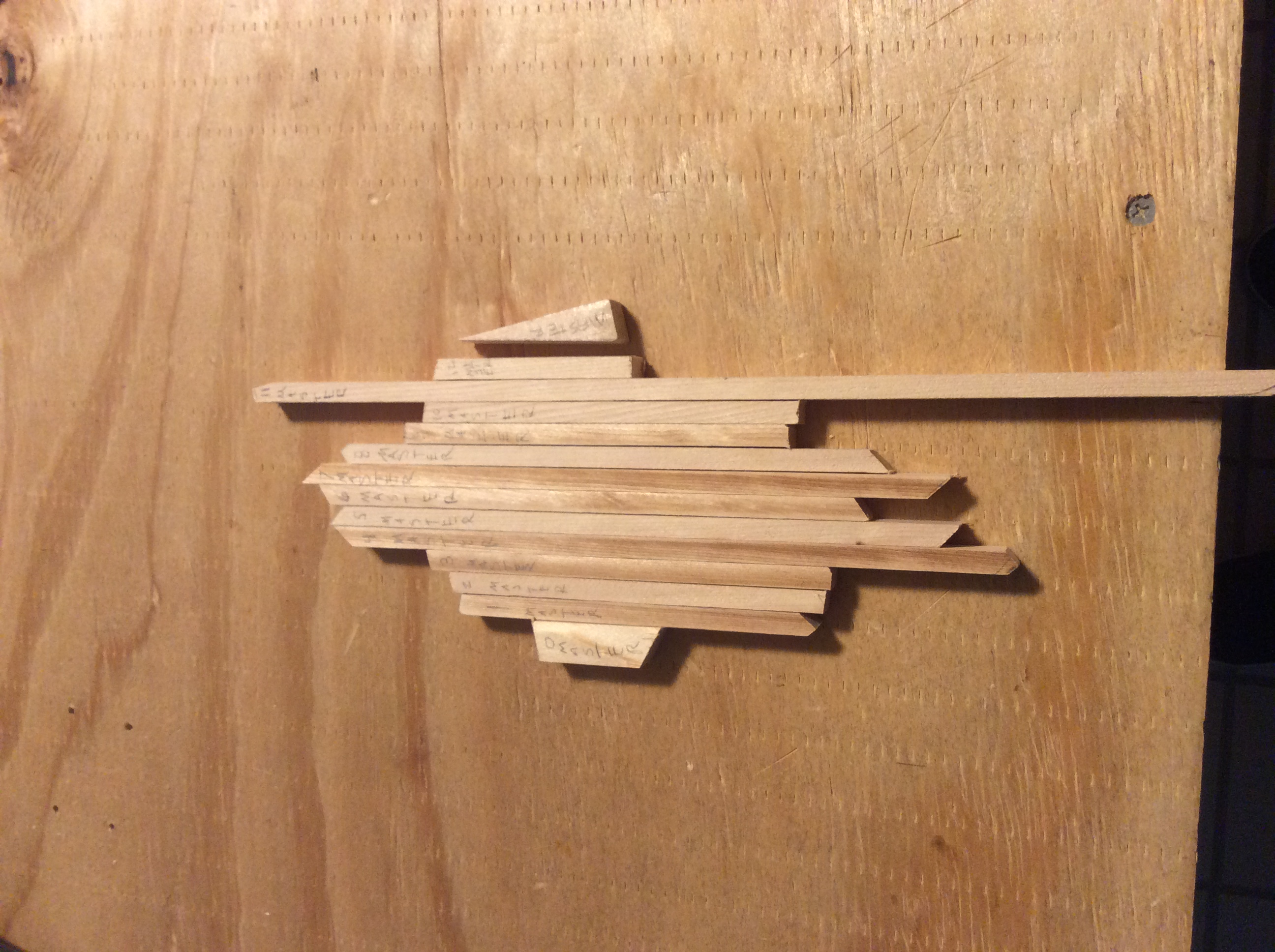

Oscar, thanks again for the reply. I am onto rib #5 today. I spent a few hours on the first rib getting the truss members exact and then used them as the templates to mark future truss members before cutting. I then use a shooting board marked with the exact angle i want for each cut. This has worked well so far and i can go from an empty jig to epoxy drying in 2.25-2.5 hours. with a little slop included for any clean up of the ribs I think maybe 90 hours of build time on ribs. not sure how that compares with other builders experience. I put this out there as a data point for those who build in the future.

Wow! I've never heard of a shooting board before, looks like the perfect tool for the job.
