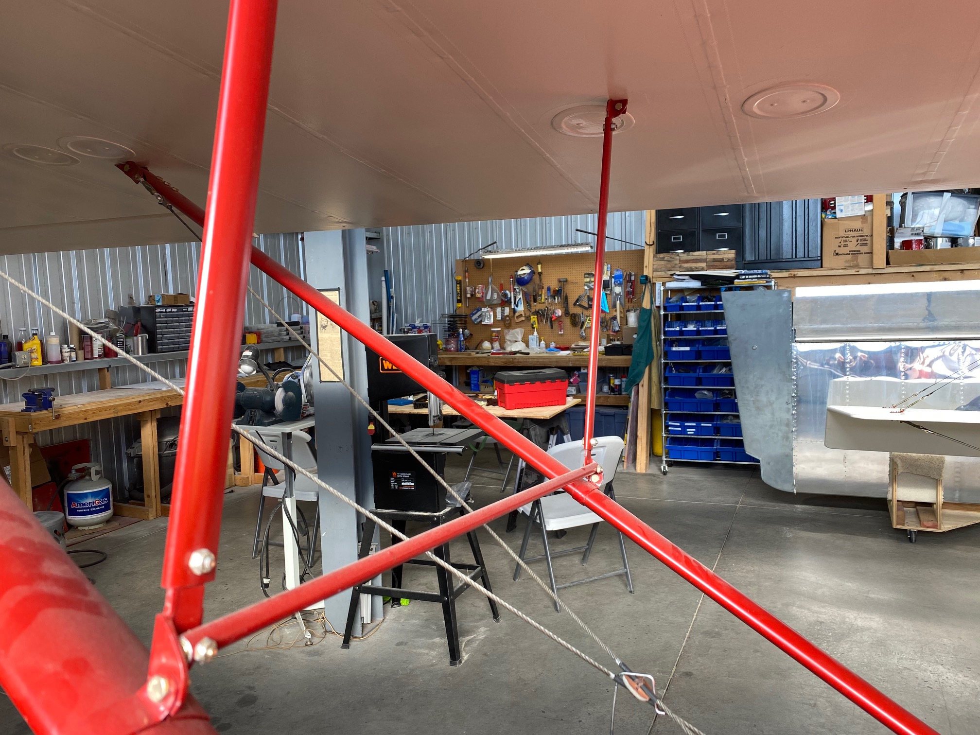

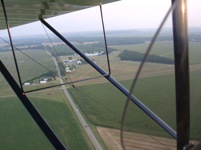

Buddy; here you have one of the flagship Air Campers in the fleet... Mike Cuy's beautiful airplane. See if you can tell what size tubing his jury struts are, but they sure don't look anything like 3/4"!
Posts: 684
Re: jury struts
I'll be at the hangar sometime today and will put the calipers on the jury struts on 41CC to at least get you the OD of mine.

Posts: 684
Re: jury struts
Just checked the jury struts on my airplane (which I didn't build). The verticals are 1/2" OD steel tubing, while the horizontal connector between the verticals is 3/8" OD.

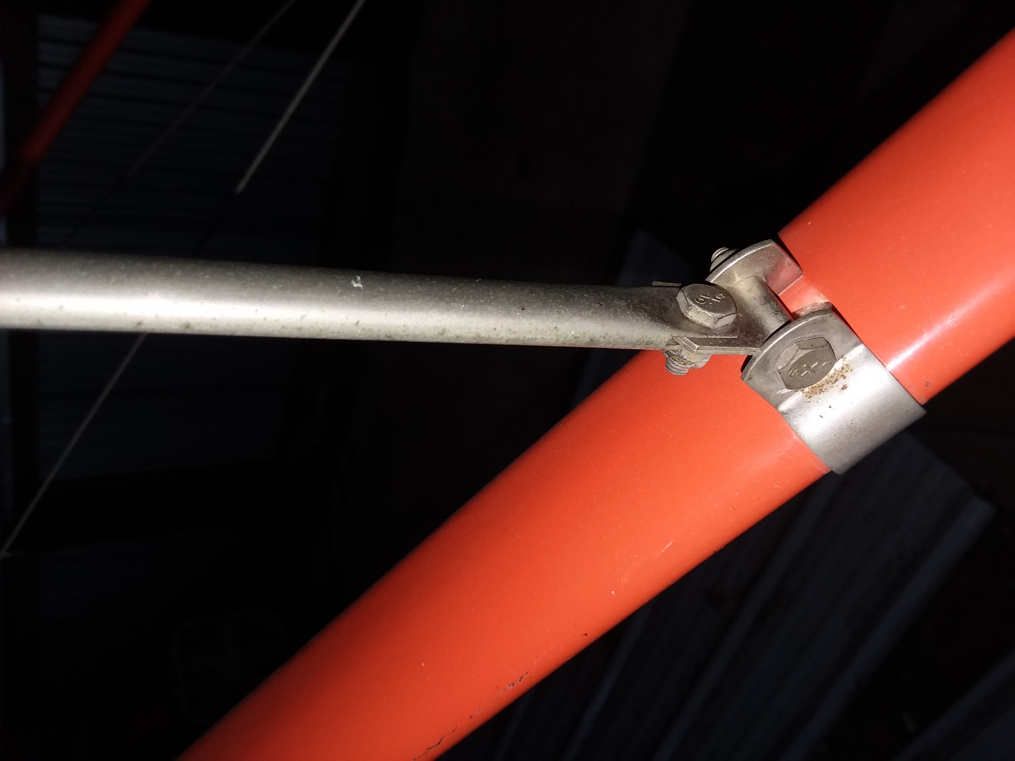

N34KP's jury struts are 3/8" x 9/16" steel streamlined tubes. I don't know where Ken found them. He told me once he'd bought them 20 years, or so, ago when he was buying stuff for his Great Lakes project.
A.E.D. metal products have odd size and small streamlined tubes in different materials.
https://www.aedmotorsport.com/store/mat ... streamline
