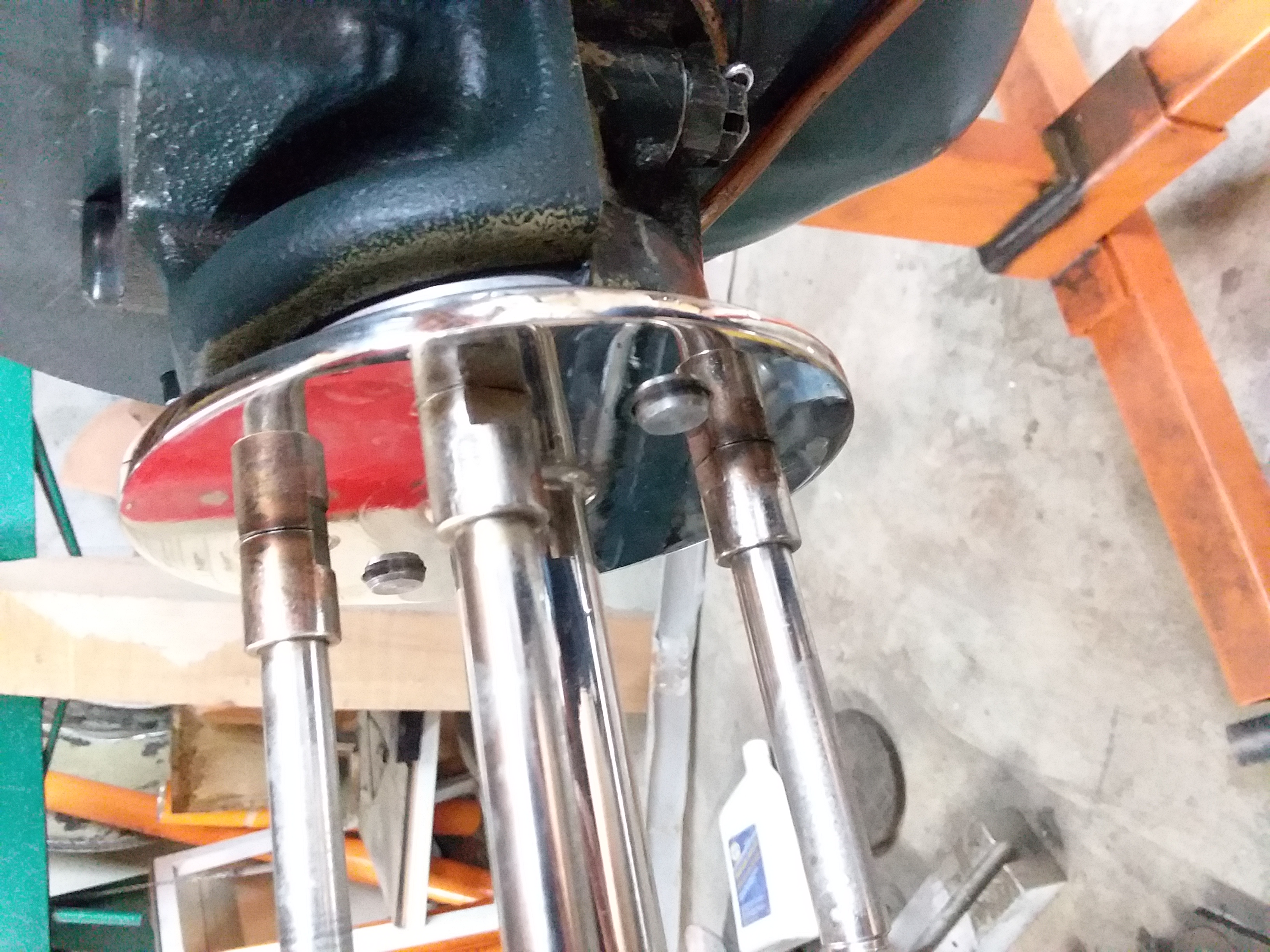

Thanks for the info and the pics Richard. hope to gain as much info as possible before making a powerplant decision. where can i source a prop hub? and any particular magnetos, carburetors? any other non obvious tricks to share? Paul

Ken Perkins built this Piet. He made the prop hub per the plans. The prop is an Ole Fahlin prop Ken ordered in the early 1980's. Ken made a few 6 bolt SAE 1 hubs that would fit the Model A crank, I think Dan Helspur's Piet might have one, but I'm not sure. I don't have one. I don't know if anyone is making them. This Piet is flying with a Zenith carb, from a model A. Currently it has a Slick 4301 magneto installed.
