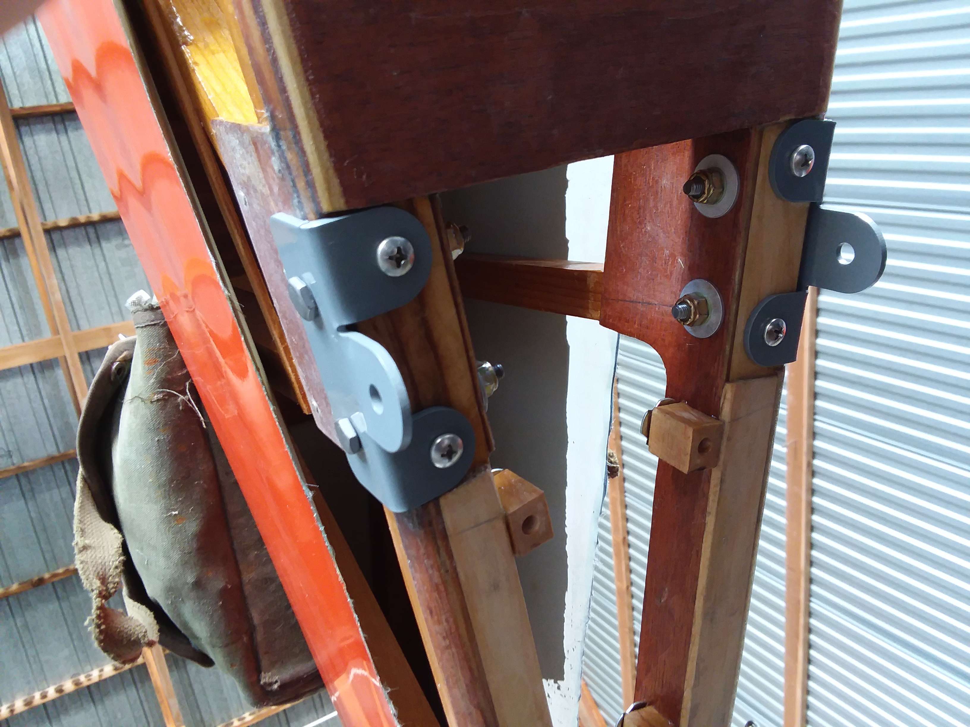

I had my fuselage in the hanger a few gatherings ago and I was told I needed to move the tail wheel back.
It is time to address that and I would like to know more about this and how far back do I need to go?
I would really not like rebuilding the whole assembly.....
Thanks
Dave

The forward brackets should be on the station. Just move it to the station and plug holes.

Gotcha thanks!
