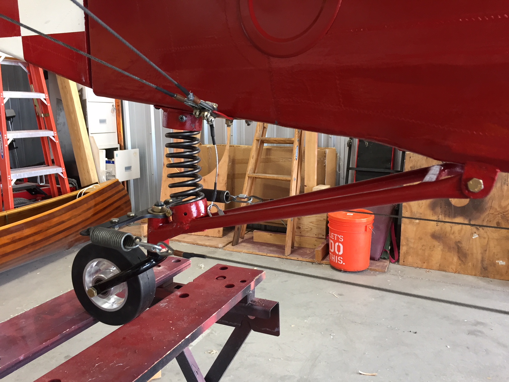

Here's what I bought from McMaster-Carr in July 2018. Picture attached. It's been working fine. I like the amount of give as I touch down.
Spring-Tempered Steel Compression Spring (pn# 96485K141), 6" Overall Length, 1.938" OD, 1.438" ID, $11.45
Die-Spring Cage (pn# 1878K57), 2" Long, 2" ID, $8.30 each.

Thanks Ken! Great photo! What tailwheel is that?
Re: Will this spring work for A frame tailwheel
Looks like an Aviation Products (API) tailwheel. I hear good things about them. Also, Ken, I notice that you have some bellcrank extensions on your tailwheel. Was this done to slow down the response a bit? My Piet had similar extensions on the Scott 2000 but I found nothing in the logs during the airplane's test period indicating why Corky may have added the extensions. I flew the plane like that for awhile but now I'm using a Matco with no extensions and don't find much difference in handling.
My tailwheel is the Lightweight Tail Wheel from Flyboy Accessories. It's a full pound lighter than the original tailwheel I had on my Piet. That might not sound like much but even a little weight saved on a long arm makes a measurable difference to the location of the CG.
I'm using the Doug Bell Tailwheel Fork. I like the geometry of the DB forks, as it helps the tailwheel ride up and over potholes and ruts in fields.
Yes, I added the bell crank extensions. I found that before I added the extensions the ground handling was way more "enthusiastic" than I wanted. The cable mounts for the extensions are now exactly the same distance apart as the cable mounts on the rudder horn. Now, the rudder and tailwheel move the same amount for each rudder pedal application.
