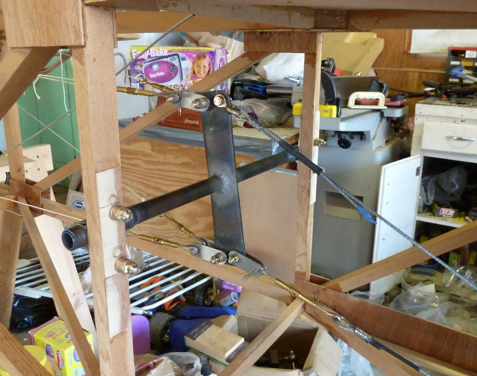

Posts: 646
Re: Elevator bellcrank cable connection
Browsing around Westcoastpiet, there are plenty of different setups at that bellcrank. Here's Chris Tracy's.
Posts: 166
Yes, that's it. I see a shackle on the top right. I'm trying to figure out how to best connect the cables. I'll look around for photos.

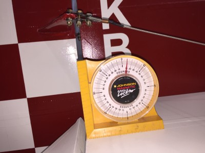

Posts: 130
John,
I haven't found a picture of my elevator bell-crank assembly. Here's one taken of the rudder horn that might give a sense of the flexibility provided by using combinations of motorcycle connecting links. (Disregard the angle-finder. This was taken as a set of photos when I was dialing in the H-Stab angles of incidence.)
Posts: 166
I can see the set up clearly. Thanks!
