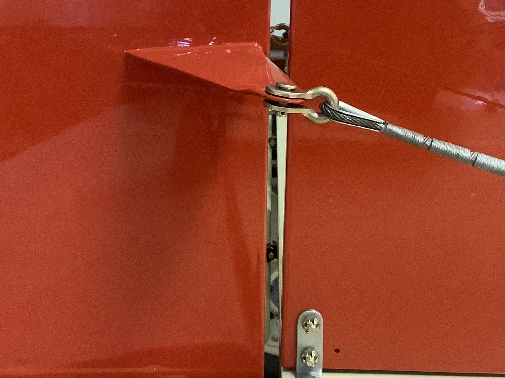

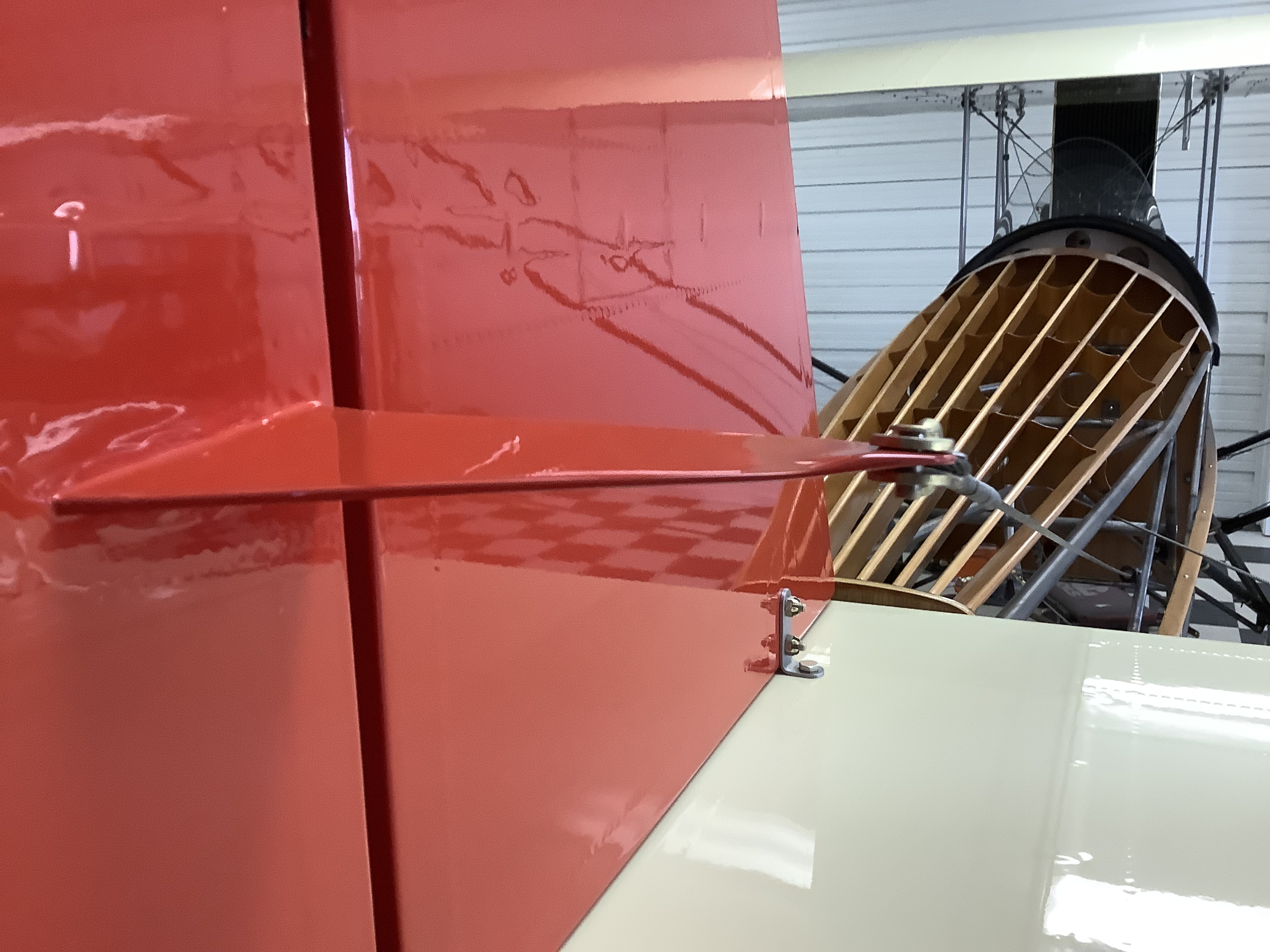

I twisted just my ends a little for better alignment. Not the whole horn.

Yes, I see, and many thanks. This is a nice solution without bending the entire horn!

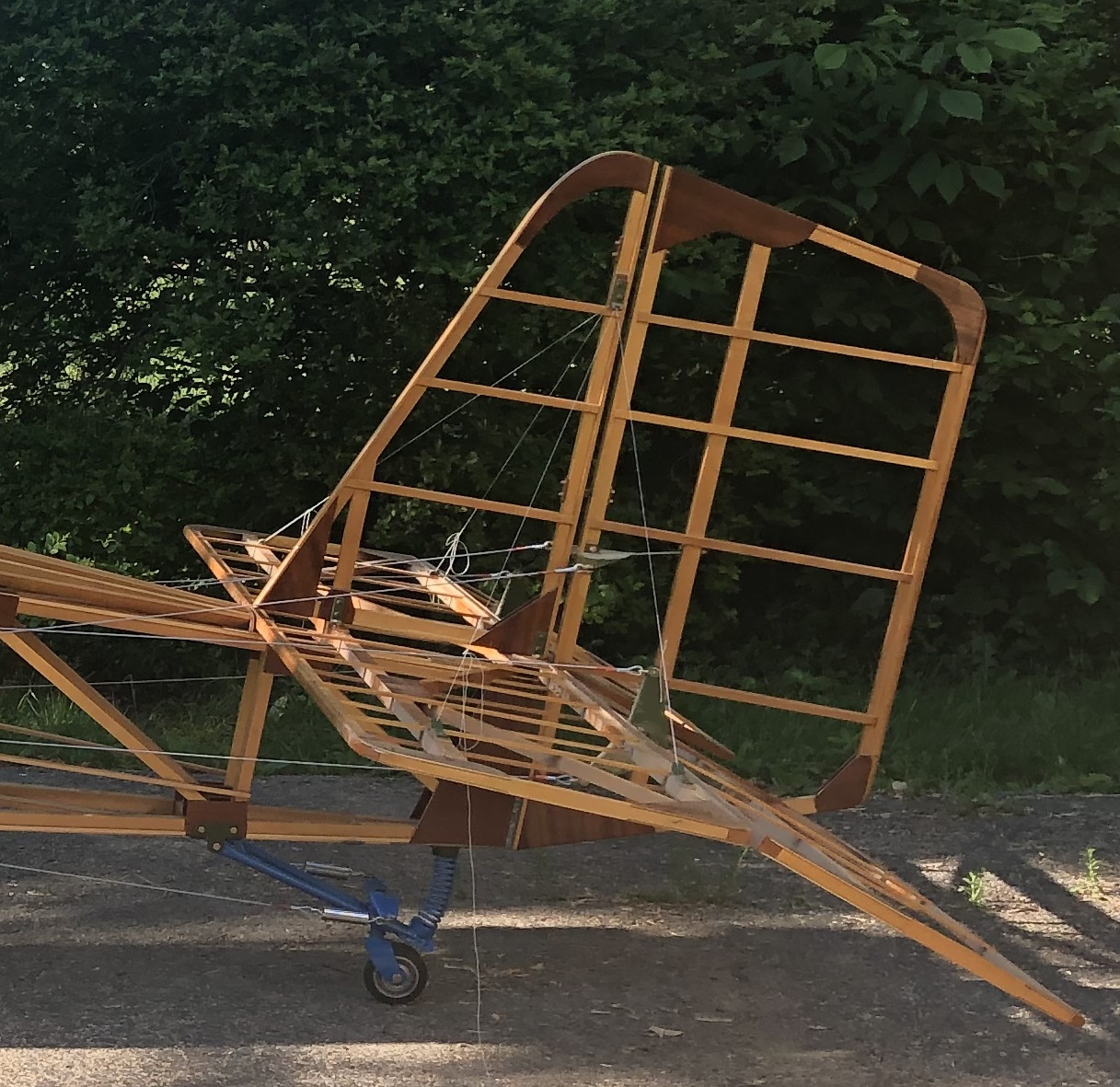

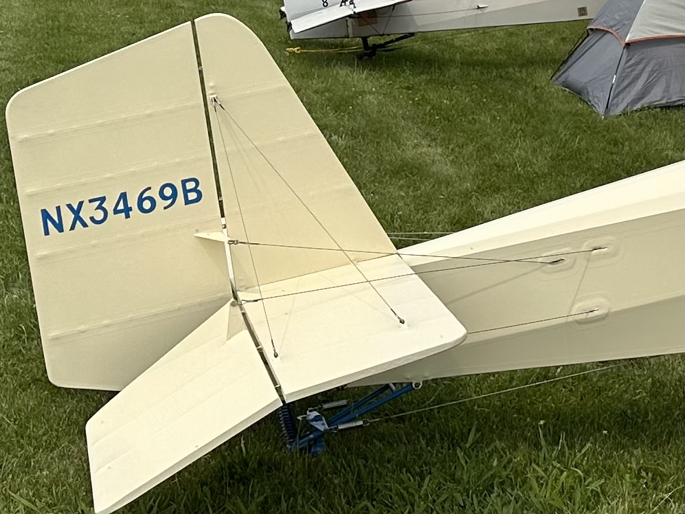

If you look real close at drawing number seven then it appears to be slanted down. Of course drawing 2 shows the thing being put in straight. And in pictures of the last original it looks straight.
I went and did mine tilted down and aimed it right for the rudder bar. Then later I realized that the cables should probably run under the seat. Which meant I didn't quite tilt it down enough but it was already done. So what I wound up with was it being tilted somewhat down. Seems to be working and so far I haven't wanted for any nose down trim but I'm sure there's a zillion other factors that go into that.

Yes, that’s what I’m talking about! I’ve seen this and wondered if there was any adverse trim. You answered my question perfectly!
