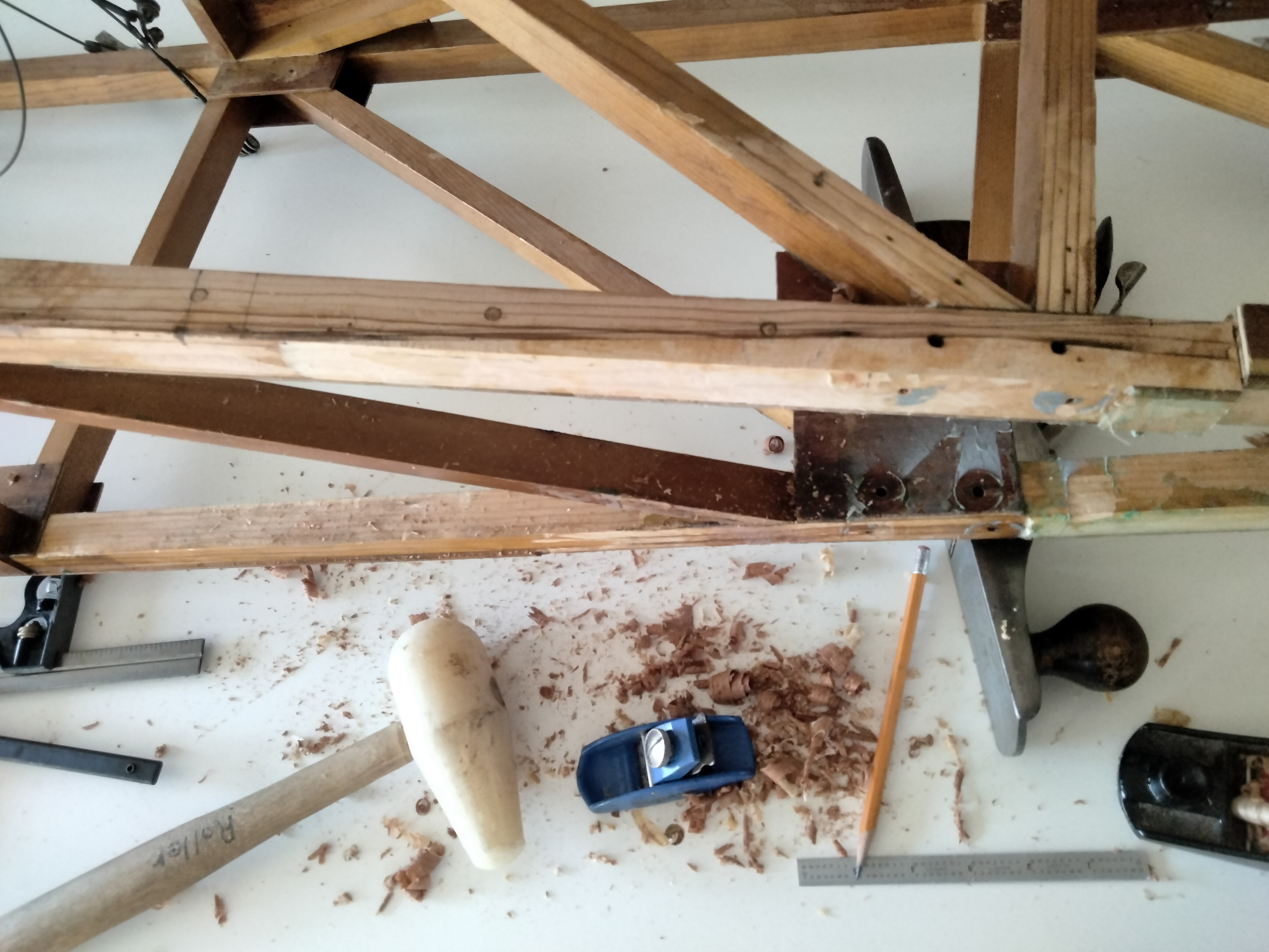

Finally got up the nerve to try the first scarph. This is the lower left longeron, just forward of the tail post. 15 to 1 slope. Done with wood chisels and hand planes.

Saw it on facebook.. it'll get you another Attaboy here. :D
Re: N34KP's rebuild
Seeing no other attaboy posted here yet, I'll raise my voice with one. Nice work, Richard! And with the simplest of tools, too. Carry on...
Re: N34KP's rebuild
Count me in with another attaboy!
