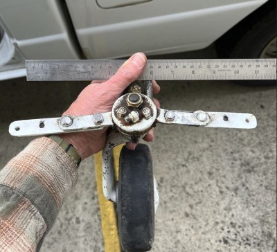

A bit of background. My rudder horns are built to plans with the holes spaced approx. 10" apart, as you indicate in your message. I repurposed a standard Van's RV tailwheel for my Piet. The horns on those have the holes about six inches apart (I don't recall the precise distance, though I'm happy to measure it). As mentioned above, I have one cable running to each side of the rudder that Y's off aft of the pilot seat inside the tailcone. The second cable on each side runs to the tailwheel horn. This means that rudder pedal inputs are the same to both the tailwheel horn and to the rudder horn. The lever arm represented by the horn distances was what I needed to address. One more note. I have rudder pedals, not the rudder bar as called out in the plans. I am happy to chat about that, but I don't think that difference is relevant to the tailwheel/rudder issue.
When I was originally doing taxi testing, At slow taxi speeds, I found that I was having to use what seemed like excessive amounts of rudder pedal inputs even for relatively small turns. That was annoying but not dangerous. At higher taxi speeds, I found that when the rudder began to be effective, I was way overcontrolling the rudder inputs due to the amount of inputs needed to deflect the tailwheel. I added extensions to the tailwheel horns so that the holes would be at precisely the same distance apart as on the rudder horn. I don't know if they needed to be exactly the same. Once I made them that way the problem disappeared. So I largely forgot about it ... until this thread.
I've attached a photo where you can see the extensions.

Ken; those tailwheel control arm extensions that you have are pretty much identical to what Corky added to the Scott tailwheel that used to be on the plane. Now you've got me started on this and I'm going to have to go measure the spacing on the Matco arms that I'm now using, and the Scott arms with extenders that are still lying around the hangar somewhere. Parts for that tailwheel got astronomical so that's why I swapped.
