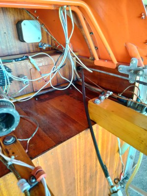

Posts: 95
Re: Gascolator Installation
Could you mount it with a couple spacers and then use an elbow fitting? Then you could run your fuel line from anywhere you like. I built my Air Camper with no penetrations through the firewall and no junk cluttering up the passenger compartment.
In the photos you can see the gascolator mounted to the bottom left of the firewall, and the fuel line entering from the top left.
jeffreyK
Posts: 45
Post by jeffreyK »
I like how you've done that. One of the nice things about the Usher gascolator is it mounts directly to the firewall without brackets. Moving it off the wall would defeat that and bring in much more fuel line in front of the firewall. The position of my Rotec Carb almost dictates throttle to come through the firewall. All other cables I plan to have like you have done. I'll have to think about all this. Thank you for sharing your experience .
