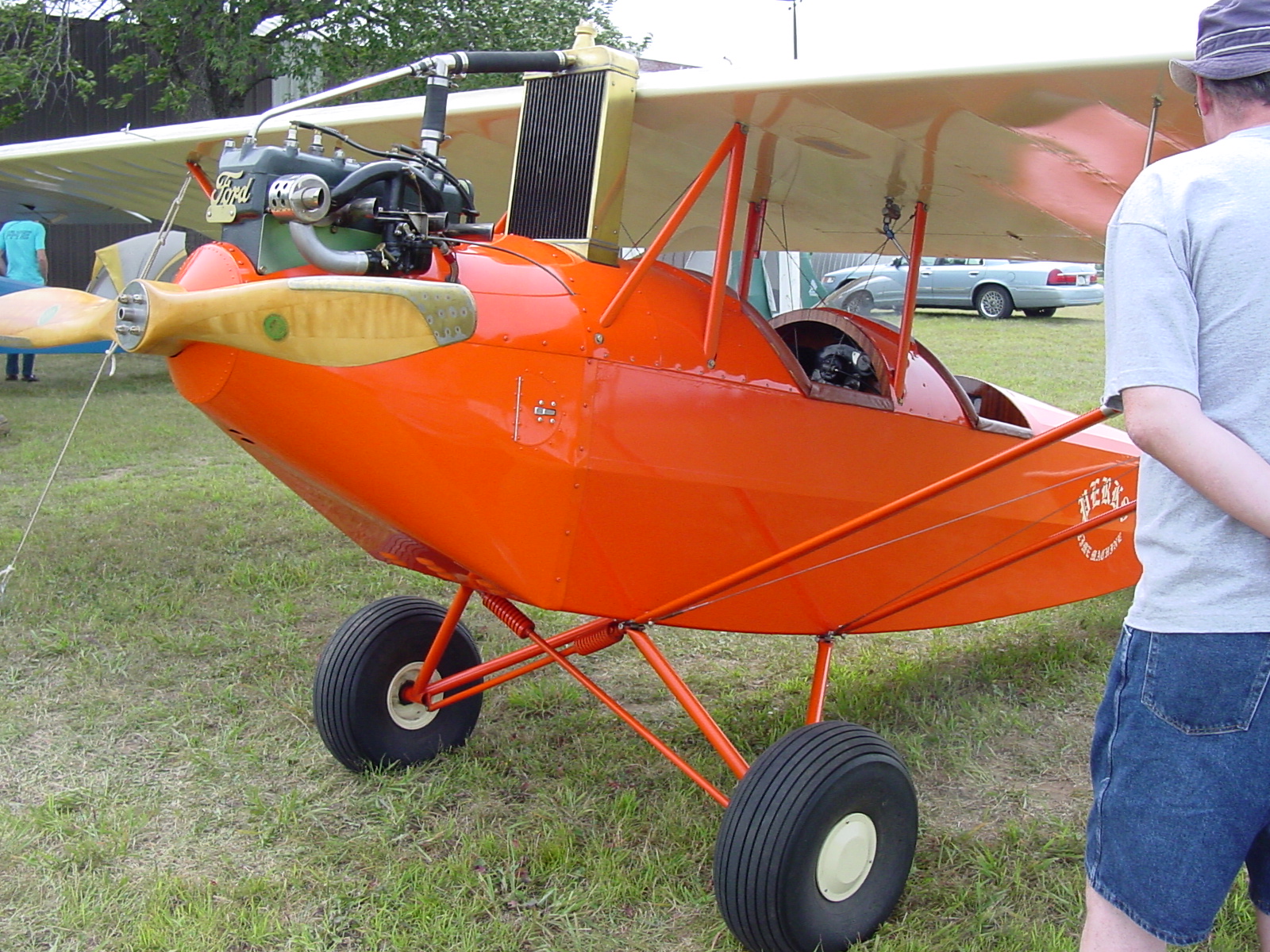

Rick H
Posts: 358
Re: Model A vs Corvair engine weight
I did the weight and balance for Ken Perkin's Piet N34KP. It has a model A Ford installed. When originally built it was very tail heavy. Ken didn't want to move the wing so I did the figures to find out how far we would have to move the engine to get inside the aft c.g. limit. We weighed the Piet with a set of race car electronic scales. After getting the weight (658 lbs.) we removed the engine and weighed it with the prop and oil and added 16 lbs. to the weight for the water. The engine is modified per the plans, has a aluminum head and a slick 4000 series mag driven off the crank. It has an Ole Fahlin 76x44 prop. With prop, oil, and water the engine weighed 256.3 lbs.
