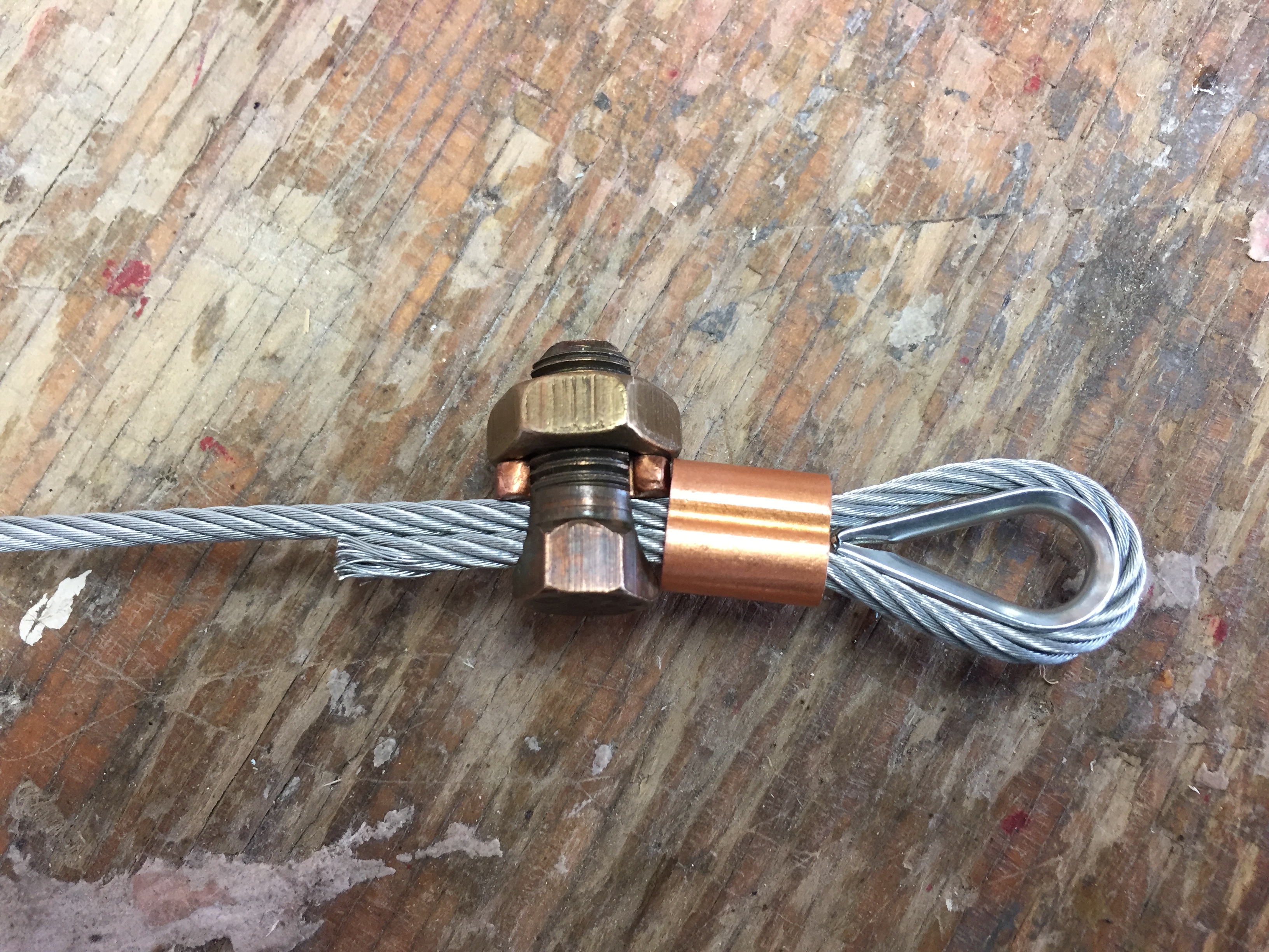

Oscar, I too saw this "helpful hint". One of the old-timers, when I was early in my Pietenpol build, showed me a much, MUCH, easier way of holding all the pieces together when making cables. Lowes, Home Depot, and other supply houses sell "copper split bolts" under a variety of brand names for around 3 1/2 dollars each. With one of these, it is straightforward to get everything exactly right before applying the nicopress tool. Better, it can be done anywhere, no need for a bench press or awkward device holding cleco pliers to a standing cable. cheers, Ken
Re: nifty nicopress trick
Yes, another good trick! I thought the Cleco plier trick had the benefit of holding everything in place independent of the sleeve that is to be crimped, but you're right- being able to work away from the bench and vise probably make the split bolt method much more versatile.
