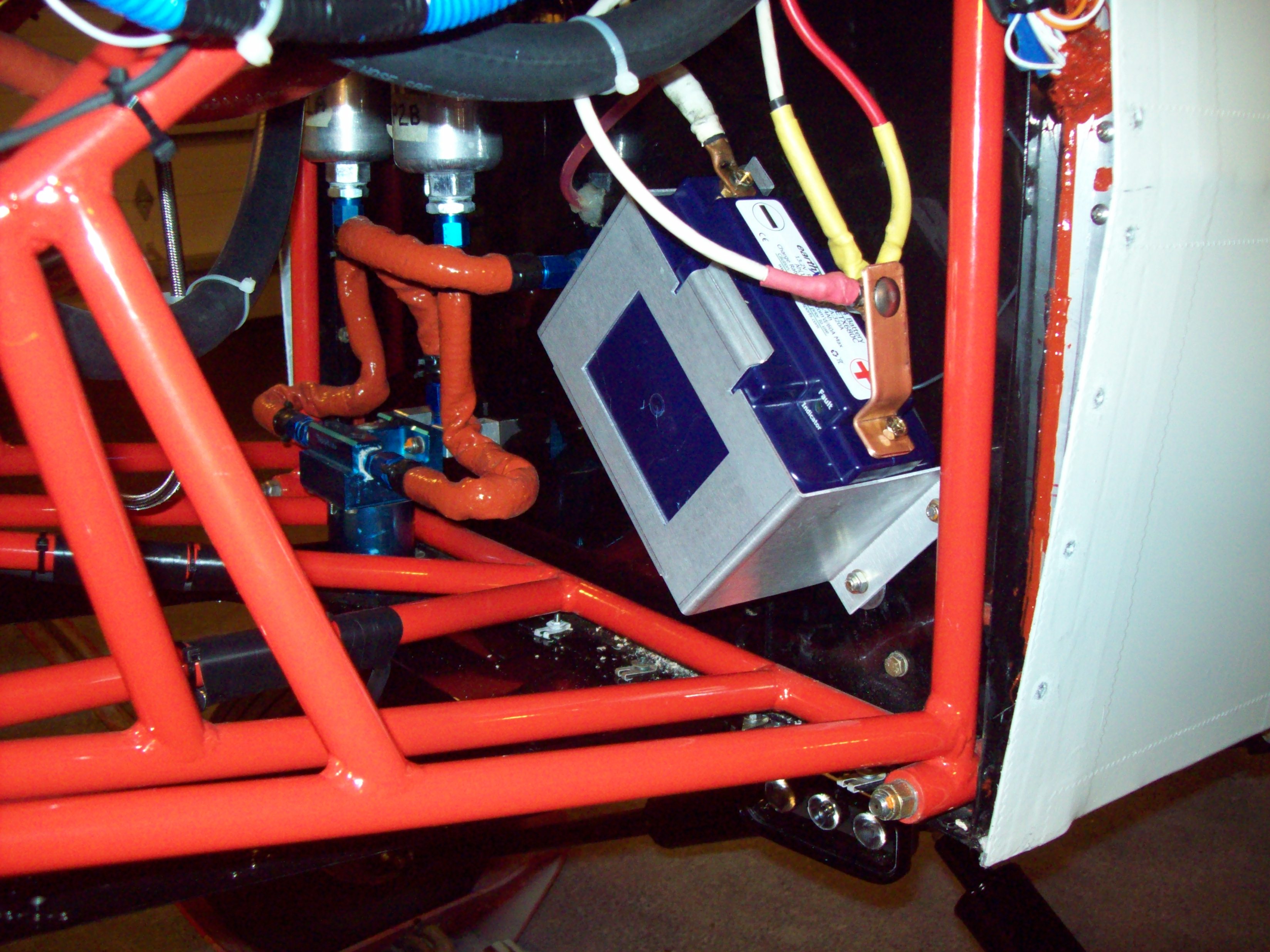

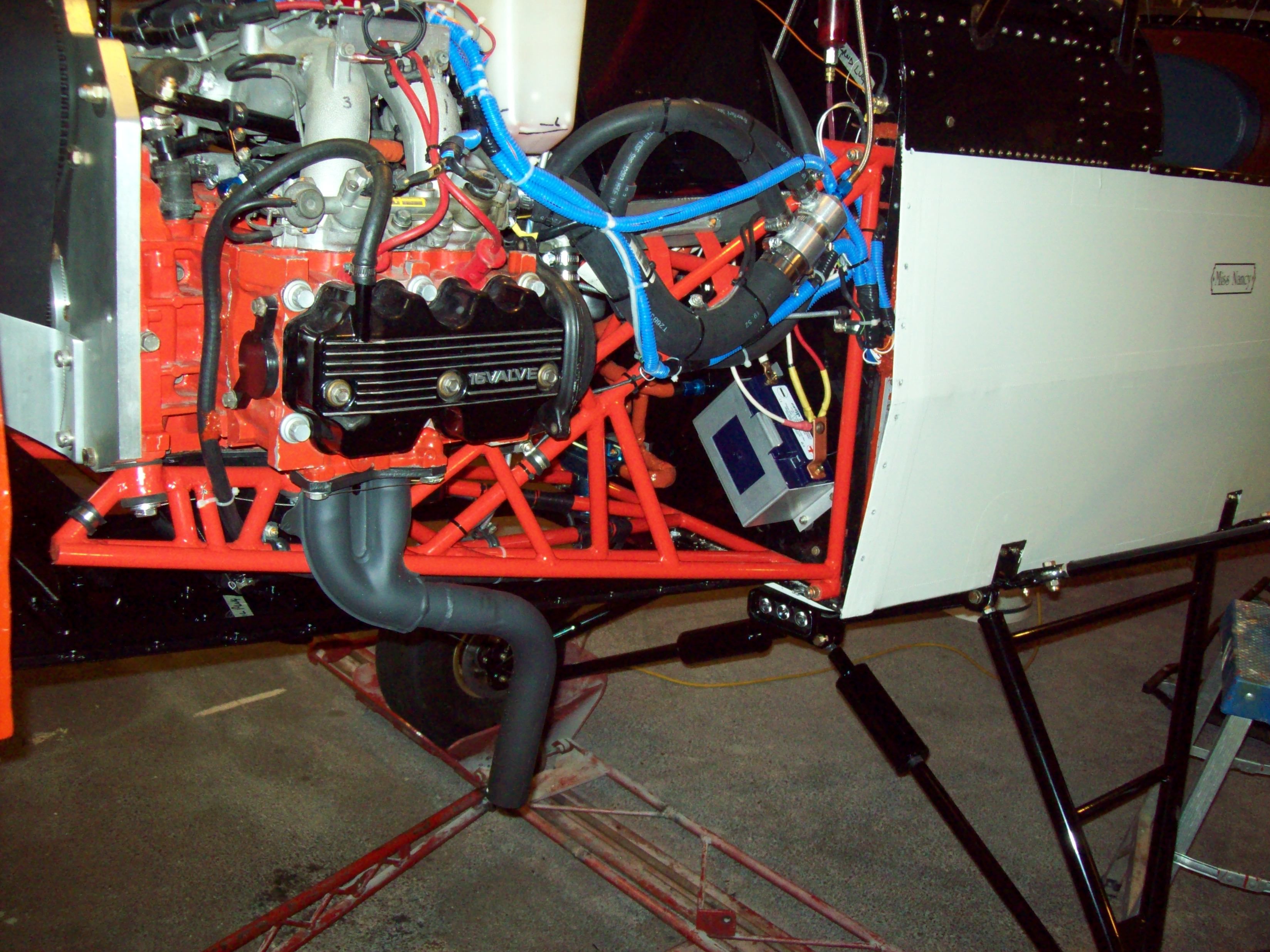

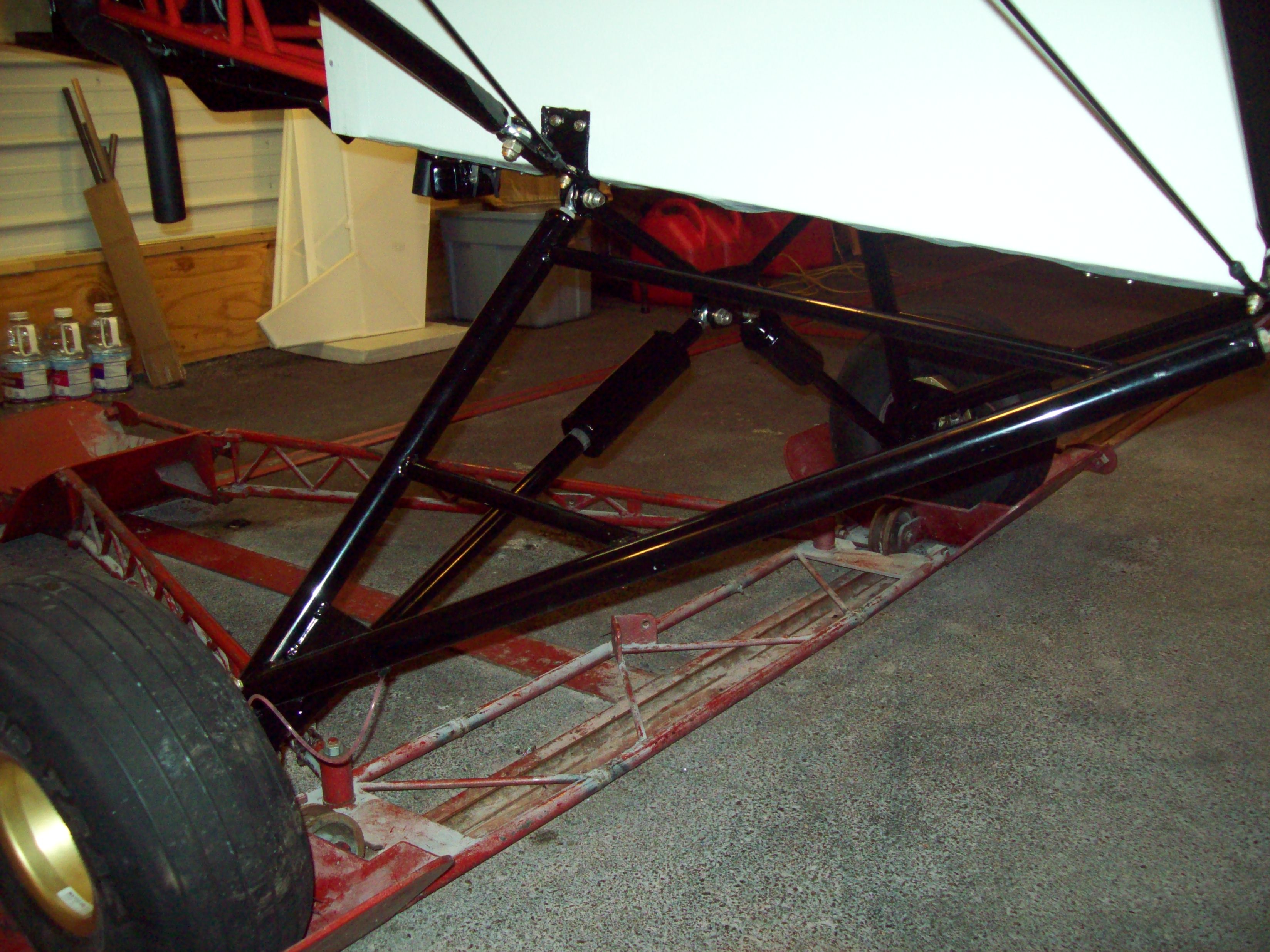

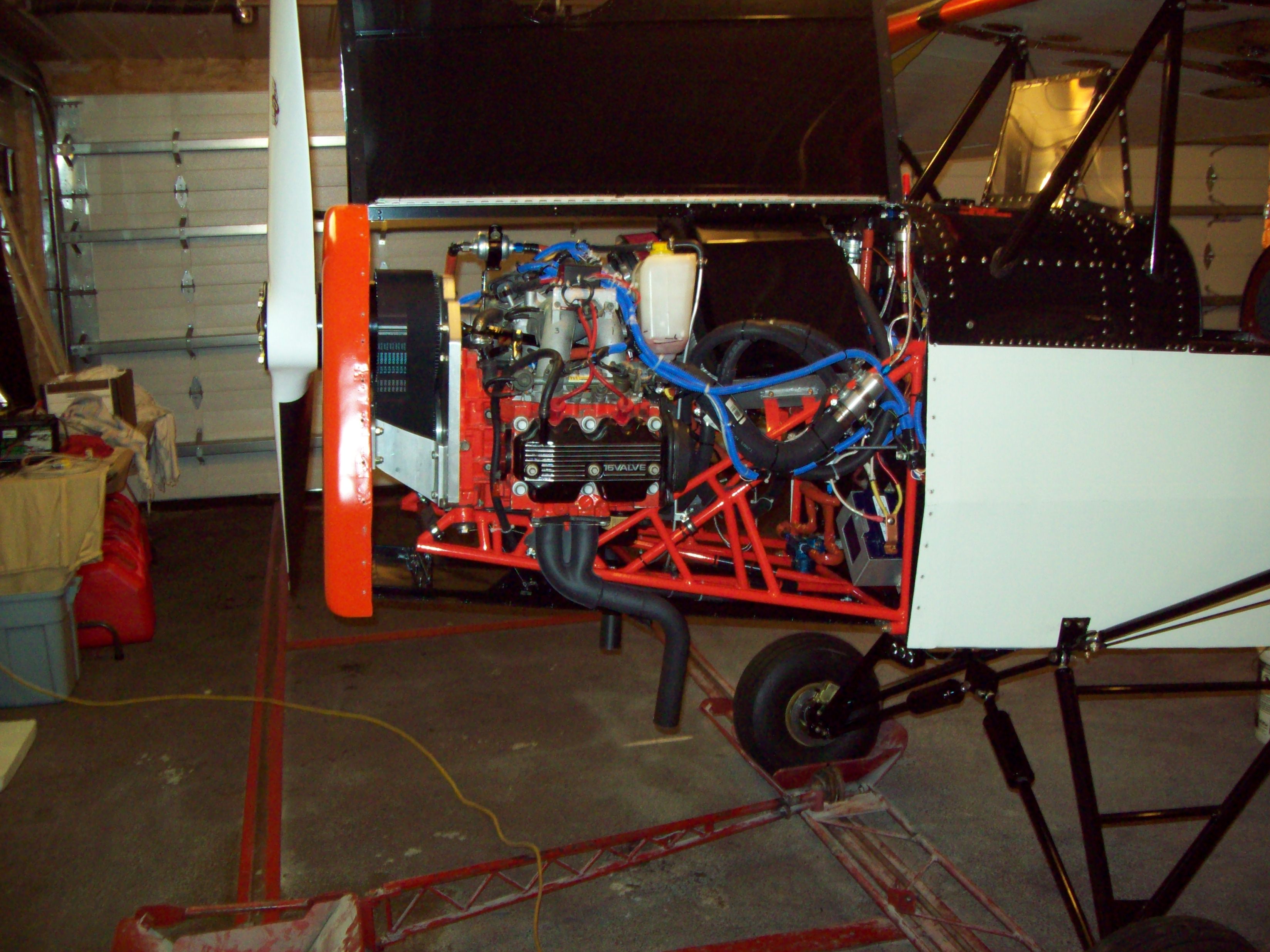

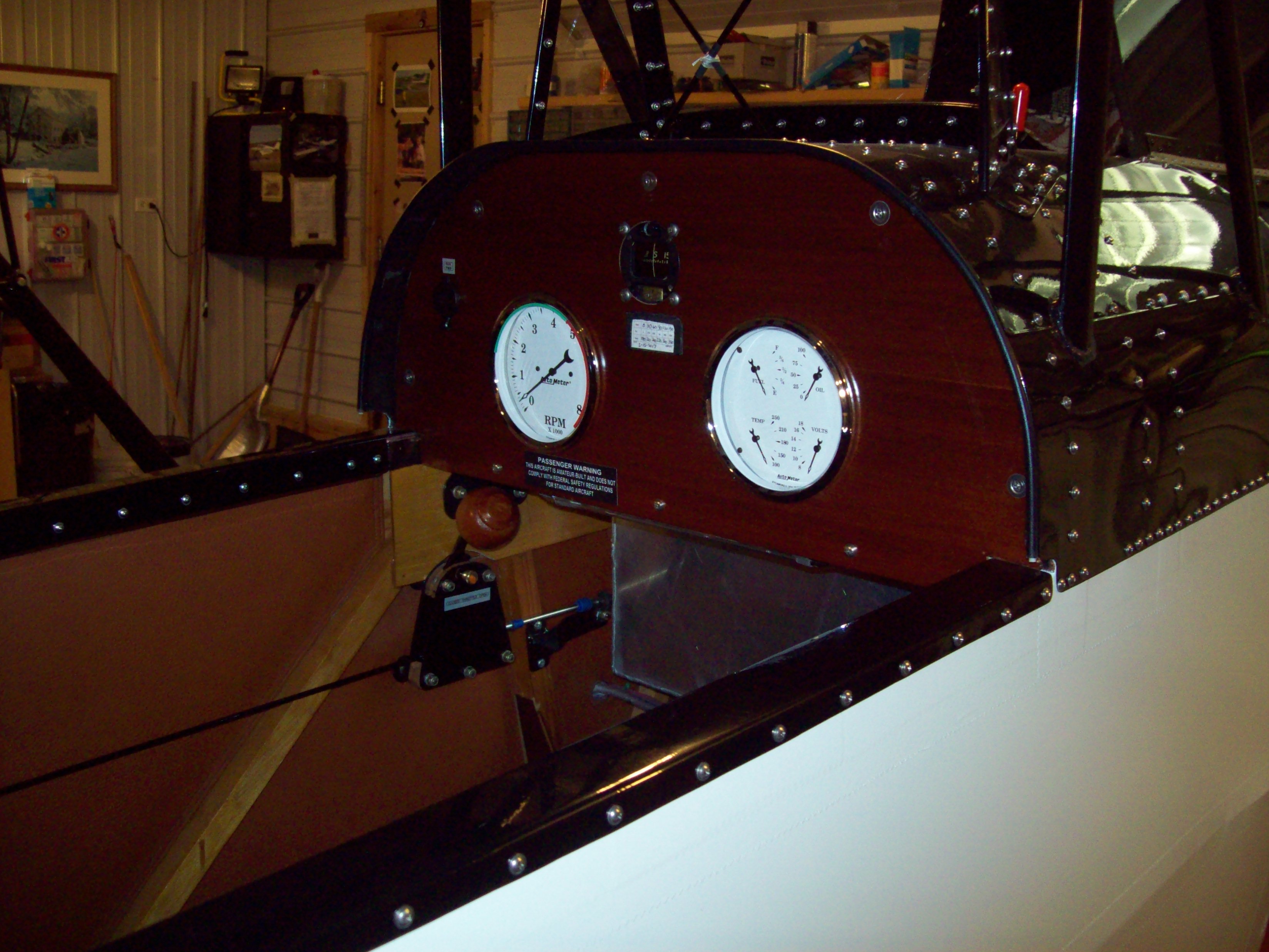

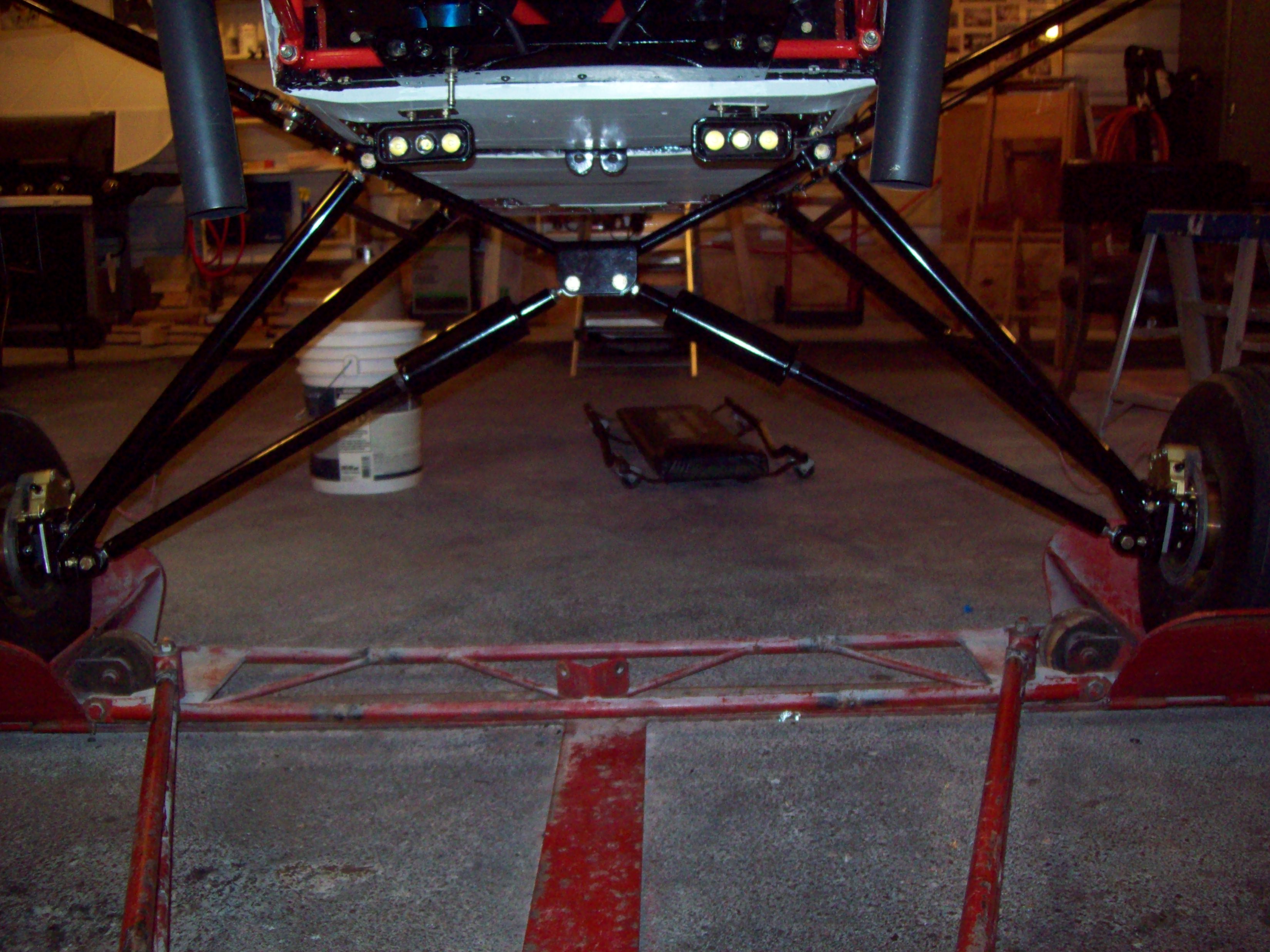

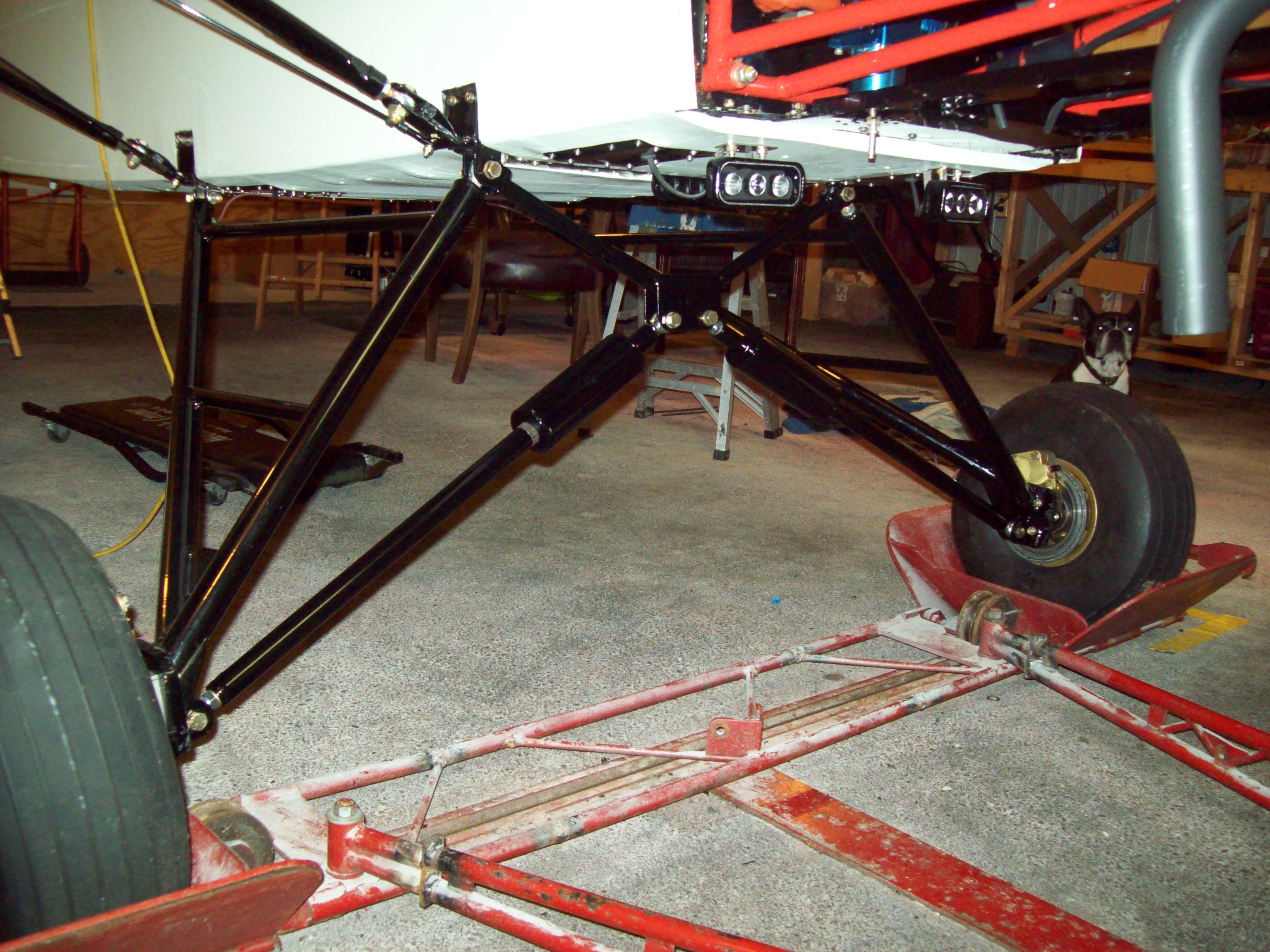

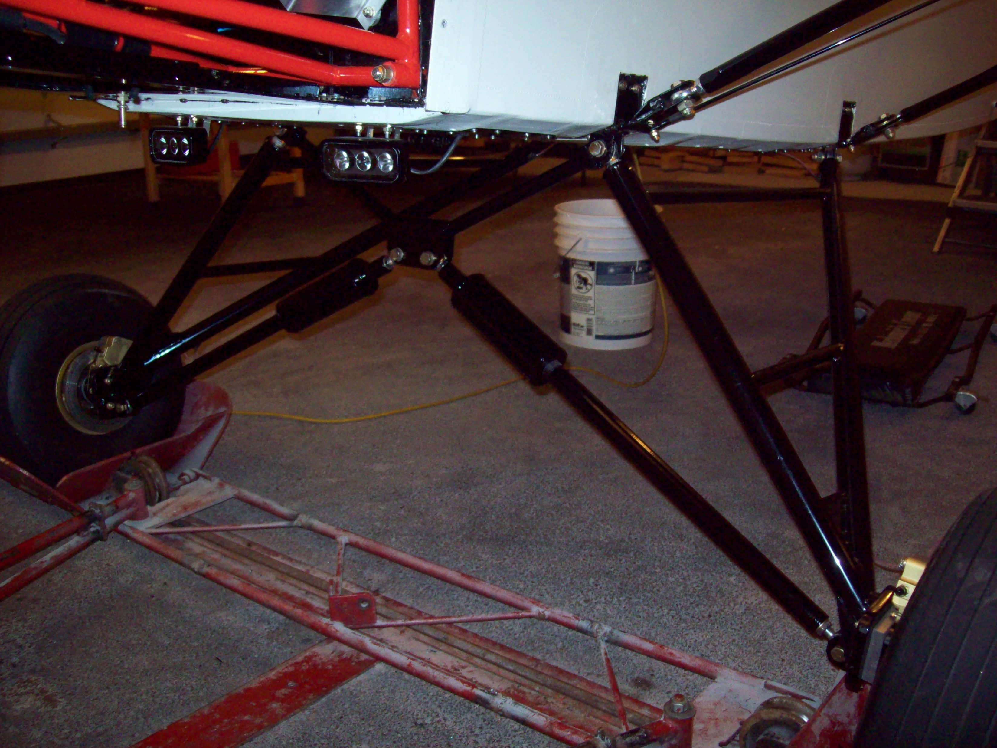

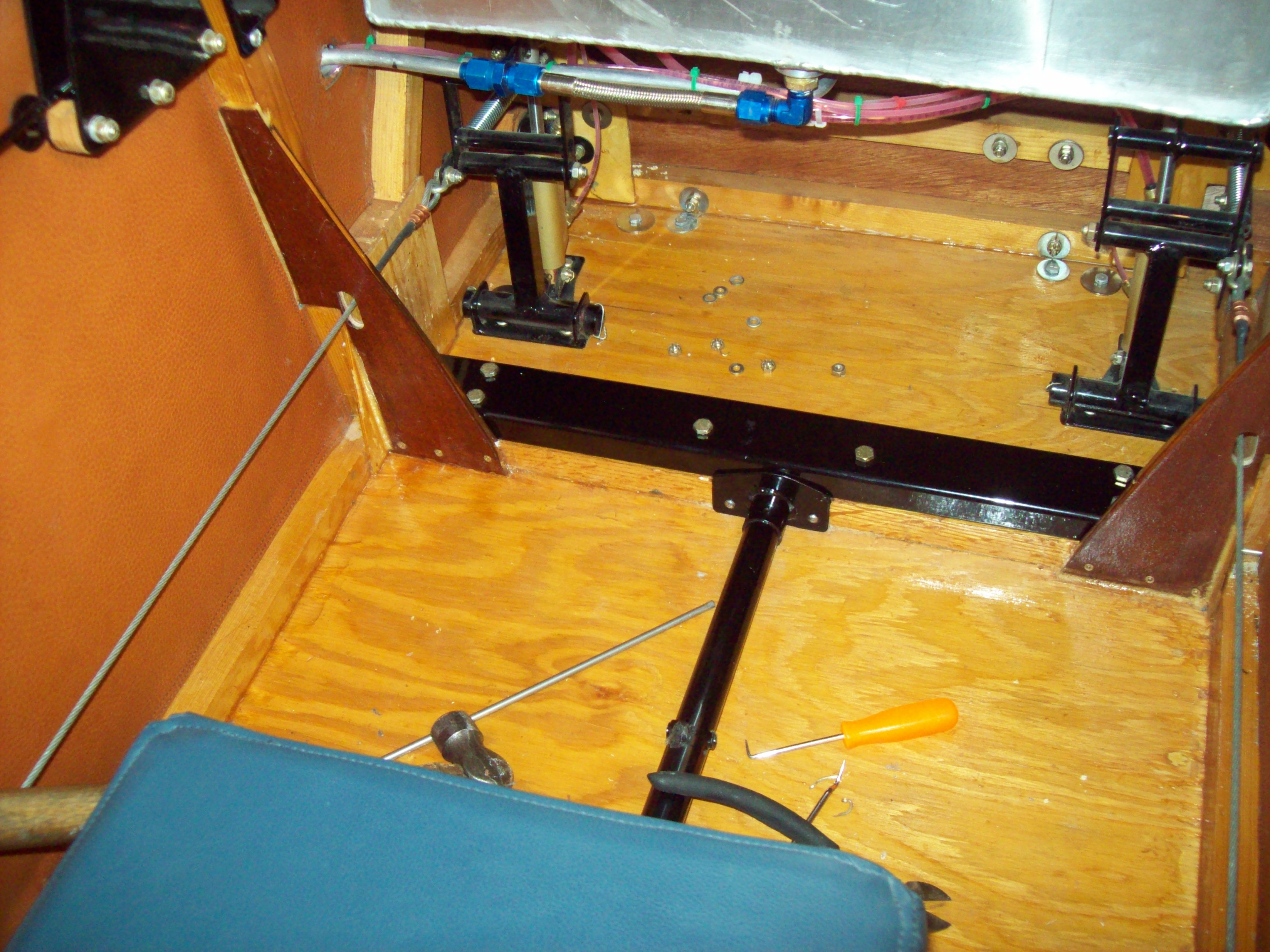

As posted previously, the axle/brakes from Matco have been upgraded to the 1.25 taper bearing type Vs the straight sealed bearing I had originally used. Additionally, I have revised my thoughts and design after a long-hard look at Earl Brown's documentation which clearly illustrated I could/should have done a better job on my canister-spring main gear; thank you Earl for that info. Not stopping there, I had also went with the newest technology on batteries and purchased the EARTHX battery; weighing just 3.9 pounds and delivering much more power than my lead tractor battery. I also added some new gauges in the front seat for duplicity reasons. Still to be completed is the weighing of the plane, and test flying it, but I'm reasonably sure the improvements/modifications will be an asset to the design/build, I have created.
My Piet has 9.5 hours on it, and yes, they have been all above the safety of my airport, 74N; living in the woods of Pennsylvania, I remain cautious as I learn my new craft - but the plane has for the most part exceeded my expectations. In retrospect, I think having 150HP might have been pushing the envelope, but it sure gets off the runway quick! Pictures attached of the latest mods.

Herb; in the photo that shows your battery, am I seeing a bare copper bus from the + lead of the battery to where your cables bolt to it? That should probably be covered or guarded by insulating material, since anything touching from that bare bus to any metal part of the airplane that is connected to the battery negative terminal will short it out.
herbrose
Posts: 24
Joined: Fri Mar 10, 2017 4:33 am
Re: Herb's latest modifications on N709HR
Post by herbrose »
Good Morning!
You are 100% correct, and I've been waiting on the extra large heat shrink I ordered locally to get here, so I can do just that. Unfortunately, living next to "No-Where" has it's on set of problems, and things just take a little time to get done.

Where did you get your gauges? What engine are you using?
Terry; per previous posts from Herb to this list, his engine is a turbo'd Subaru. Zooming in on his instrument panel, the gauges say "AutoMeter", which you can Google to find their website. Apparently they have lines of gauges that you can "roll your own" style, face, bezel, and readouts.

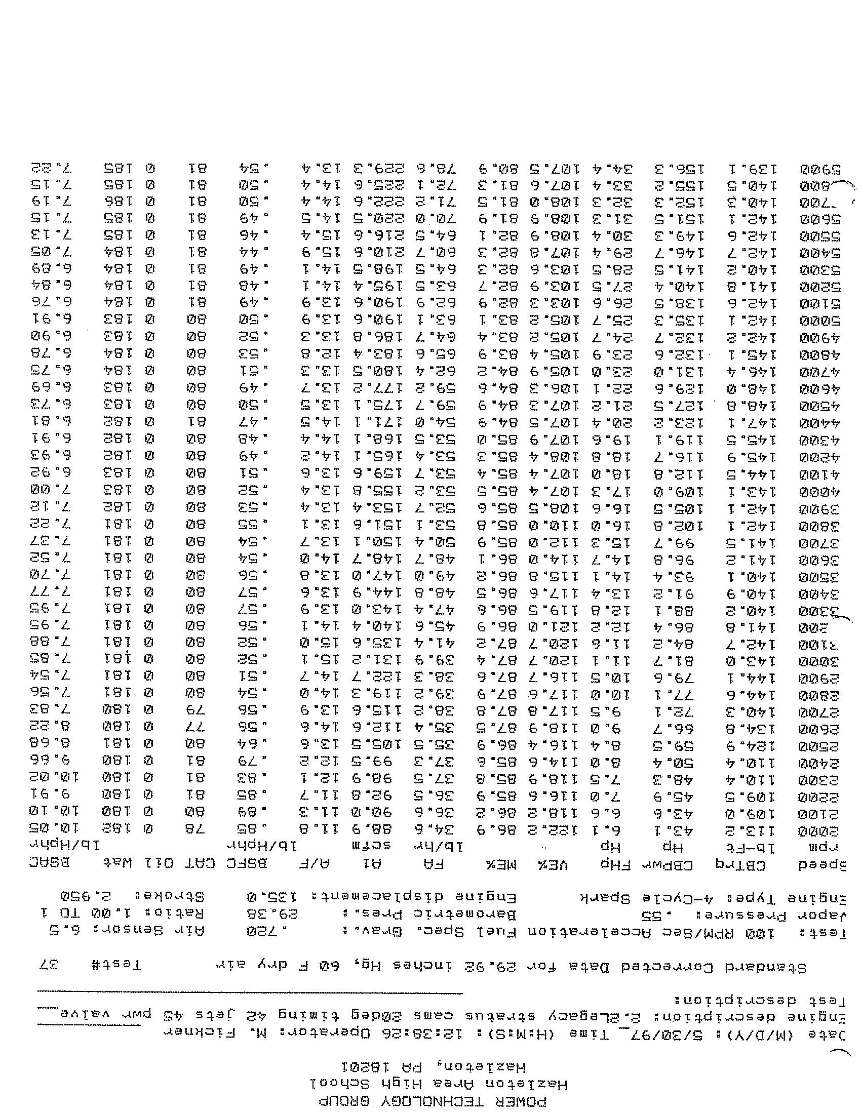

Belay that last. The Subaru EJ22 is a naturally-aspirated engine, not turbo'd, with multi-point fuel injection, rated 135 bhp at 5800 RPM. Herb's engine has a reduction drive on it and he claims a dyno-tested 150 crank HP per his post to this list on April 28 of this year.

Morning Guys! Just found the W&B for 709HR, along with the documentation on the engine dyno; both are attached for your enjoyment. While it was like no other Pietenpol, and it was highly modified, it flew like a dream. Constructed like no other, it was my experiment, and I only wish I had more time to play with it!
