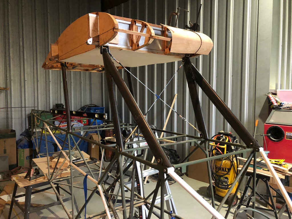

I have built my cabanes and diagonals, and I chose to use 4130 Chromoly streamlined tubing as opposed to aluminum or wood. I want to corrosion treat the inside of the cabanes and am looking for suggestions. Steve D, I know you mentioned using CorrosionX on your Bonanza. Which version? How would you apply to the inside of the tubes?
