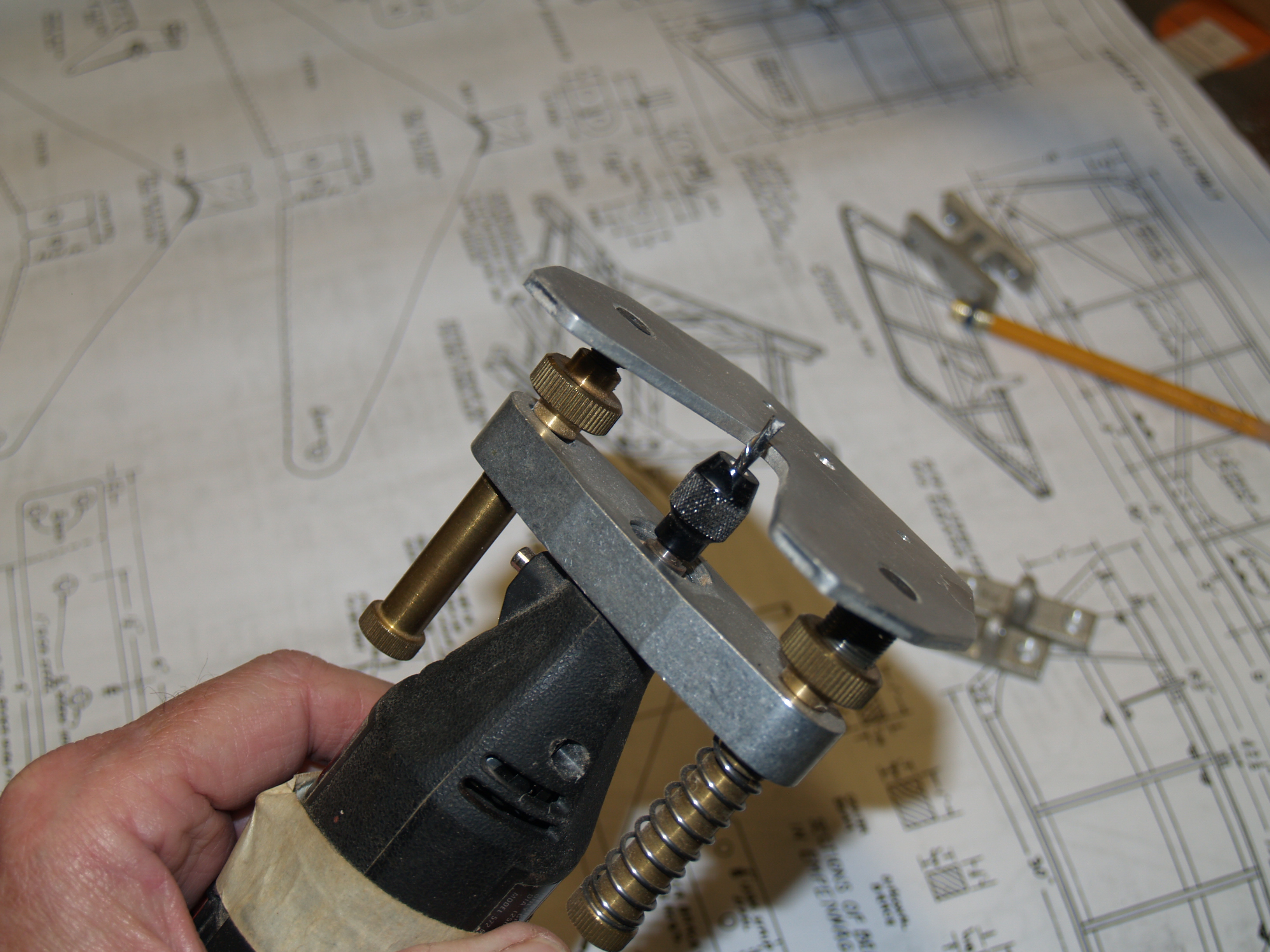

Well...I was going to post some photos of how slick my little dremel router base (that I use for routing the cavities for pearl and abalone in guitar work) worked out for me. I used it to make very precise routes for Oscar's lovely cast aluminum hinges but.......the forum won't let me post photos without some sort of permission, I guess.
Suffice to say, it worked great. I would seriously suggest any of you interested take a look at this ad:

This is the neat little router attachment on my Dremel tool.

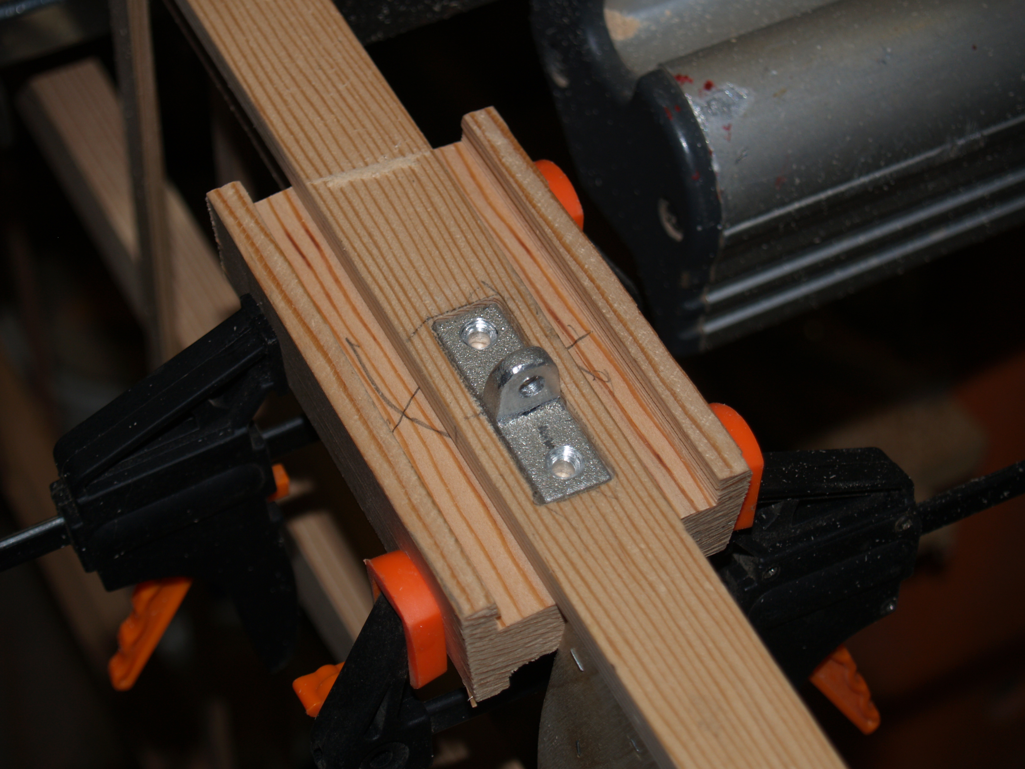

Guess I figured out how to attach photos to a posting.
I'll try to attach two more.
This is how I did a very tidy job of routing for the hinges we can buy from Oscar:
The extra pieces of wood clamped to either side of the wood to be routed are there to provide extra bearing surface for the sole of the router. Worked slick!
