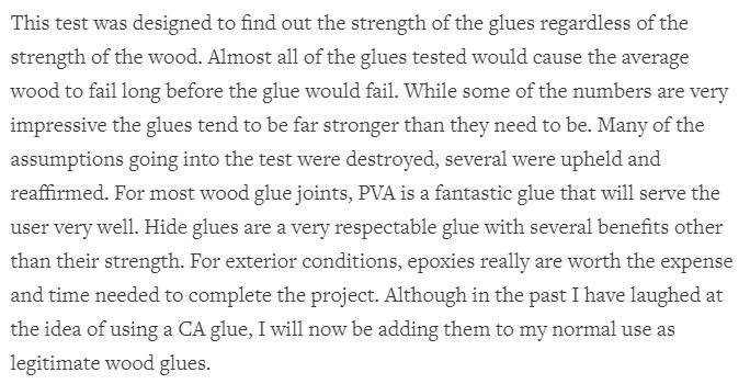

There are numerous glue tests and comparisons out there, most of them from woodworking sites. One such example is "The Great Glue Test" by James Wright, posted on the Popular Woodworking site and quite current (2018). The caution he has about Titebond II and III is that they are not good in exterior conditions. You can be the judge of what constitutes "exterior", but to me an airplane flying through the sky is in an "exterior" environment, while a dining table or a bed frame is not. The test data that Wright gathered is a huge body of information, but I'll give you the snip from his conclusions, attached.

I would kind of expect Titebond to say they have the best thing out there, and while they are good glues, I have had Titebond II and III fail in exterior projects.
Ca glues will also make the wood fail before the glue joint, and they are faster and easier to use than Titebond but I'm not building my Piet with them.
I don't understand why, if you've had success with epoxy in the past, you don't stay with that, and I agree with Clay, that if you want to stay with the spirit of the project, then Resorcinol might be your choice.
