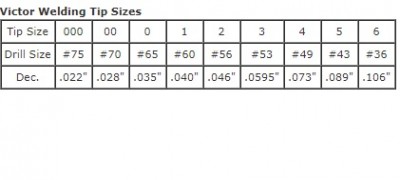

The torch I use is an older Victor Journeyman, i.e. Victor 100, which has been cloned by lots of other companies, and torch tips are readily available. Recently, however, I did not have a sufficiently small tip to prevent blow thru of the material, which happens with very thin gage metals.
So, I did what we were taught to do in Metal Shop Class in the mid-60's; you file smooth, then hammer the tip - similar to striking a nail - right on the head. The hole will close down, and you use the torch cleaner/reamers to keep it round, and to size it. Do this several times, and any tip can be re-sized to its original size, or smaller. There is also a special pin vise and a set of drills specifically for re-sizing tips.
Here's the Victor size chart:![Image]()
In my case, I had two #2 tips, one of which is now a #00 tip. Just keep hammering, filing, and reaming, and the tip will be just what you need to manage the heat on thin materials.
