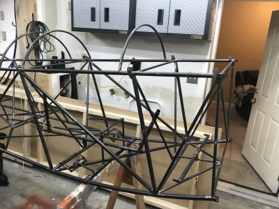

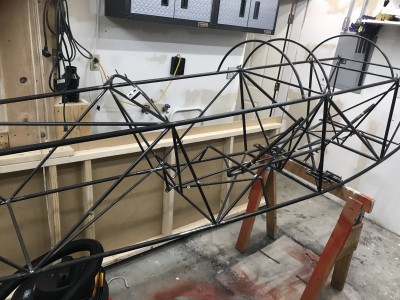

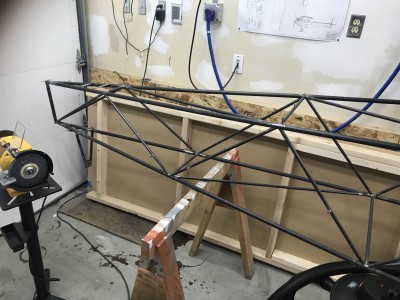

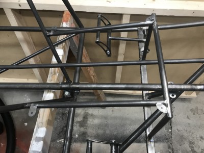

Just a few pictures of my fuselage so far...

The main reason I went with the steel fuselage is that I'm a welding engineer so metal fabrication is a bit more in my wheelhouse. The general consensus seems to be that steel fuselages are 10 to 20 lbs lighter. If you crash you're better off in a steel frame since it will bend and absorb energy whereas wood tends to snap. Steel fuselages are also more repairable.
Cost wise wood is better, I spent about $1400 on tubes and plates and the wood kit from aircraftspruce is $1100. Then you also have to consider that the tools required to build the steel tube frame are a lot more expensive.
I'm not sure if it takes more hours to build the steel version. It's easier in some ways because steel is pretty forgiving. Basically you tack weld everything in place and if you want to make adjustments it's easy. With wood you can dry fit to a certain extent but once it's glued there is no going back. The wood plans are much more complete though, I have quite a few hours into figuring out things that are clearly shown on the wood plans. But then again a lot of the fun of this project is incorporating my own ideas into it. Also lead time on 4130 tubing and plate is a couple days whereas the wood kit from aircraftspruce is a couple months. Also doing glue up during a Montana winter is not really an option for me so I think I would have made less progress if I was doing wood.

ArthurD; very interesting to see that you're using a rudder bar in front and pedals in back. Do you intend to link them together using cables, or using rods/tubes?

I was planning on using cable but I think rods would also work. I suppose rods would eliminate the need for a bell crank in the rear.

What I like about rigidly linking the front and back controls is that it helps keep the rudder horn from getting loaded too heavily if the pilot presses with both feet at the same time. I've found myself in many a demanding landing when on rollout I noticed that my legs were very tense on the rudder bar. The bar takes up that strain, no problem, but with individual pedals it's possible for the pilot to load the rudder horn quite a bit
