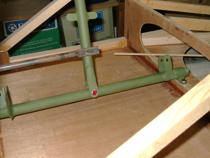

Let me try to understand which member you're referring to. The crossmember that secures the bottom edge of the pilot's seat is also the aft pivot mounting point for the aileron bellcrank beam that links the two control sticks. Where it mounts to that crossmember, the pivot bearing has two bolts going through the steel strap, the crossmember, and the floor. Were those fittings not in place at the time? Because if they were, then you have not bolted everything through the floor. See picture, which is Chris Tracy's Air Camper and it appears that he has laid that crossmember with the 1" dimension down flat.
Sorry if I've gotten this wrong, but I'm trying to picture where you stepped and what it was that let go.

correct crossmember but i have not done anything with the controls yet so there are no bolts through the floor.
