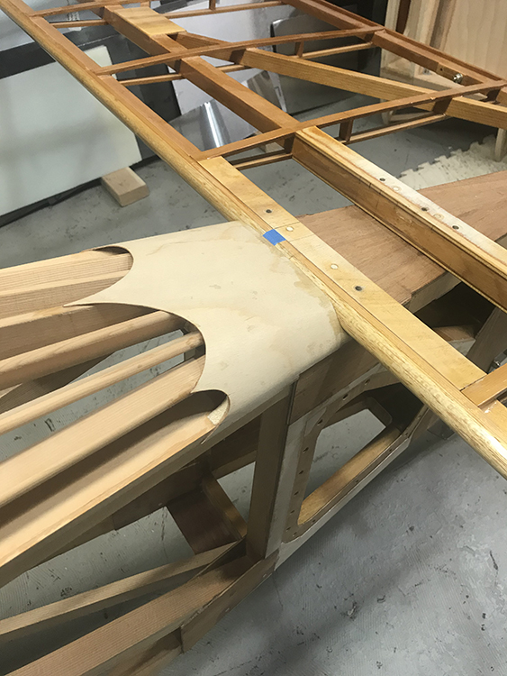

i blocked mine in with balsa, then a piece of 1/16" ply.
Re: How to end the turtle deck
Earl, that's beautiful work, and an elegant way to fair the turtledeck into the tail feathers!
Thanks Earl...looks great!
