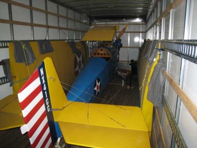

There are basically two ways to transport an aircraft. I have transported dozens, even sent one to Europe in a Maersk container. An enclosed vehicle is best. [truck or trailer] Using an enclosed vehicle, one sets the wings on either side, resting the leading edges on the floor and strapping them to the side walls. They are resting on foam pipe insulation under the leading edges while moving blankets cover the wings under the straps. The fuselage is in the center of the trailer or truck secured to the floor with straps and to the front and side walls with straps. Chock the wheels good !!! Judicious use of the foam pipe insulators is highly recommended. If a small, open trailer is used, I recommend laying the wings flat on top of each other. Use at least 5 foam insulators on the bed of the trailer and lay one wing flat on the foam. Next, add a couple of moving blankets to the top of the wing. Add more insulators on top of the bottom wing and lay the other wing directly on the foam insulators, trailing edge is parallel to the leading edge of the bottom wing. Add more blankets and straps over both wings to secure to the bed of the vehicle. This method will require two trips or two vehicles as there is usually not enough room for the wings and fuselage together, unless there is no gear on the fuselage. If there is no gear attached, the you can probably get both on the same vehicle. Use plenty of ratchet straps, moving blankets, and foam pipe insulators. In fifty years I have never had any damage using these procedures. Cheers, Don

Sorry... I misspoke. The enclosed box truck that I hauled my Piet from Texas to Oregon in was not a Ryder, it was a Penske. I think it was the 26 footer because it wasn't that much more than the 22 footer and I had to pick up a motorcycle in California as well. I picked the Penske over any of the UHauls because I wanted the diesel for driving in the mountains. It worked great, super comfortable, drive all day without stopping for fuel, very secure in back. This was over Christmas so I needed the enclosed box since weather was going to be messy in several places over the 2400 mile trip.

We just moved a Piet last month, about 300 miles across Wisconsin. Everything fit in a standard 20’ enclosed trailer, but the rear door of the trailer caught us off guard. The top of the radiator was about 3” too tall for the door. We tried letting air out of the tires but ended up removing the landing gear to get it in. No big deal.
