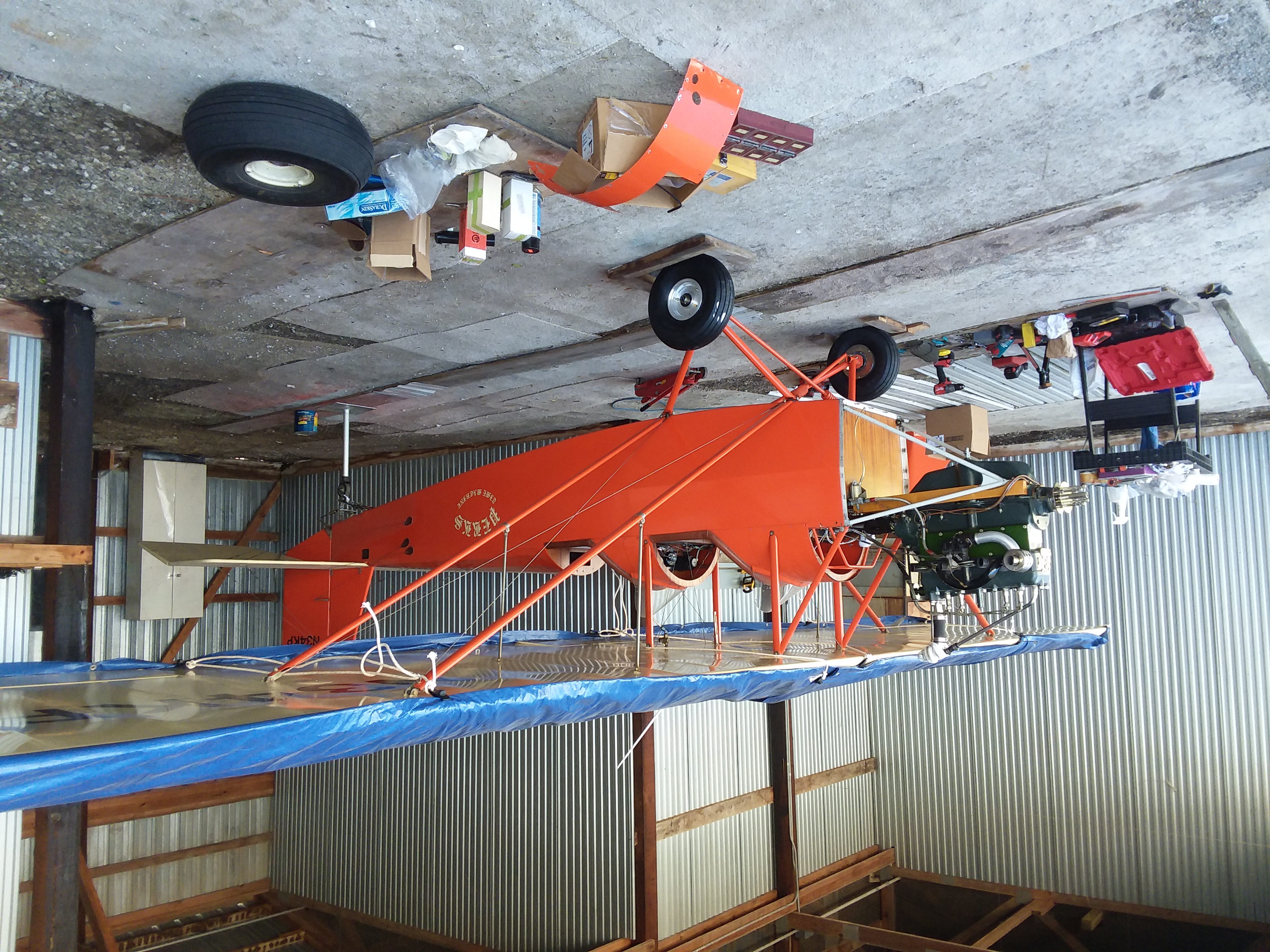

Good morning everyone. I'm sure most are aware that N34KP was damaged a year ago July. At that time it was the latest incident due to not having brakes, and there are many.

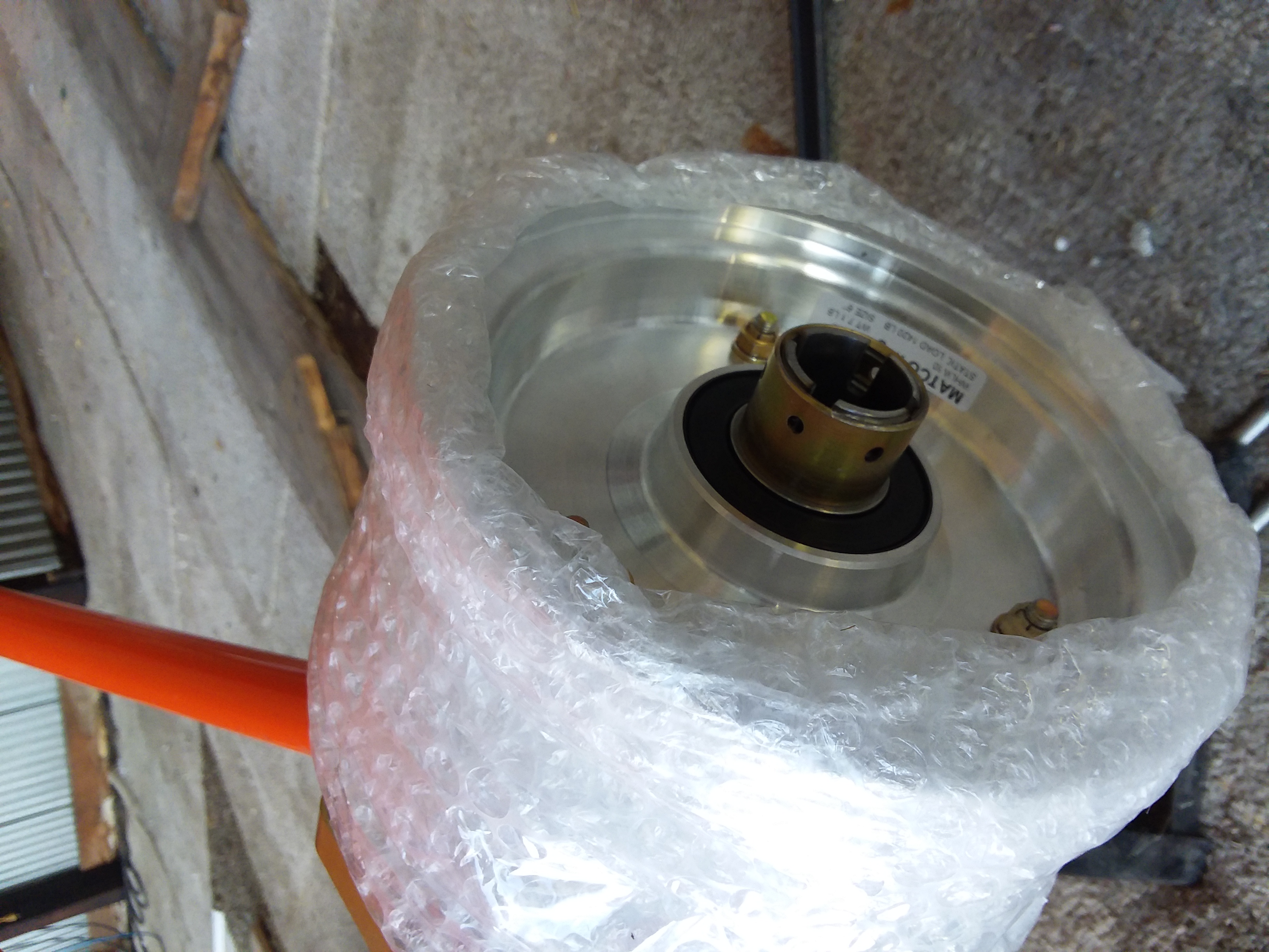

So, I'm putting brakes on the old bird this coming winter. I've bought a set of Matco wheels and brakes that will suit my needs.

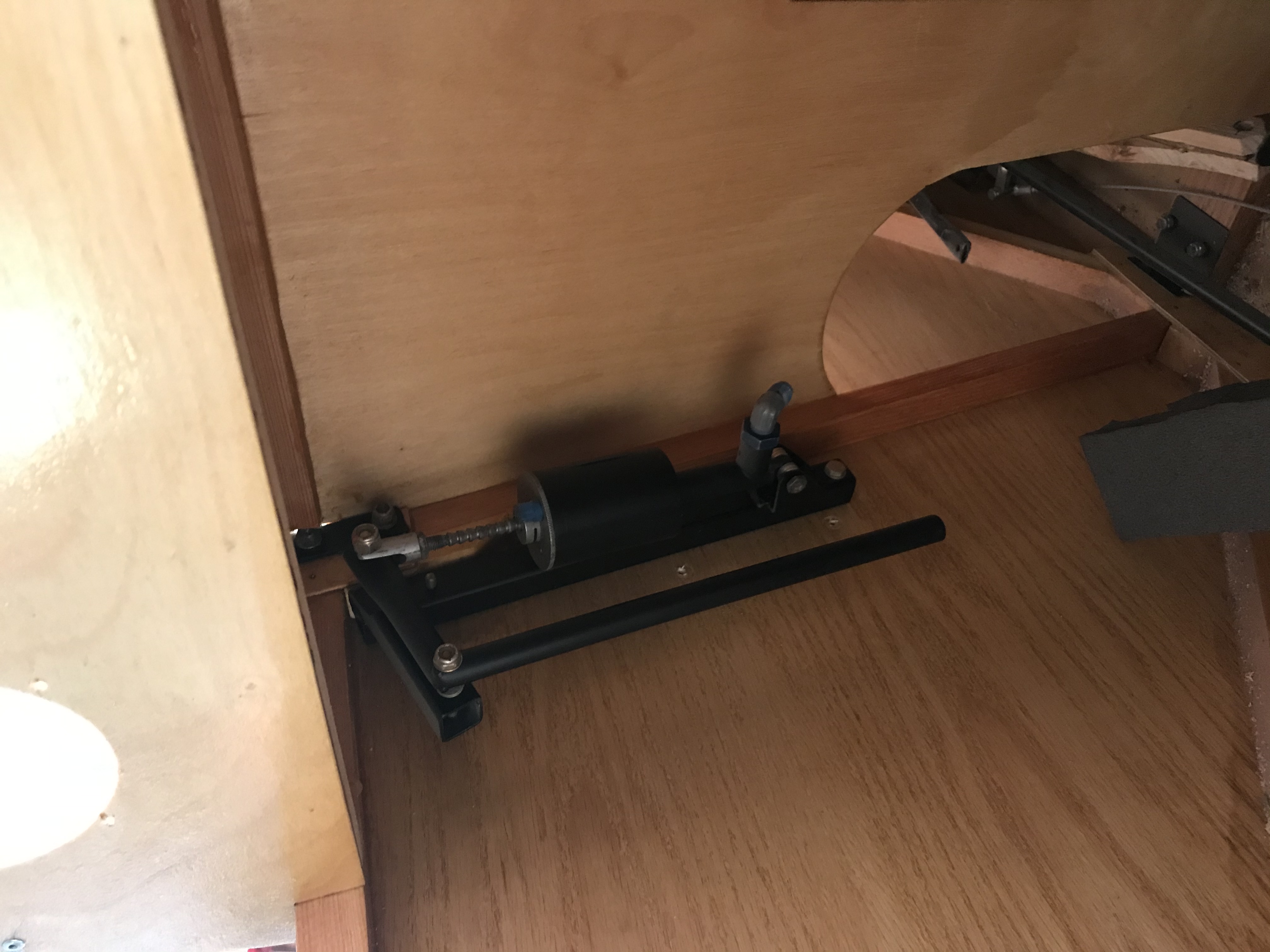

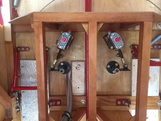

Richard; see photo of the toe brake setup on Bill Rewey's Piet. Mine were fabricated after the same fashion. They sit pretty much on each side of the passenger's thighs, on the sides of the fuselage. Simple and effective. Bill's actually have parking brakes, which are the metal tabs on top of the cylinder shafts. You apply the brakes firmly, then pull on the parking brake knob which lifts the tabs such that they 'jam' the shafts and hold the brakes. I had them on my brakes when I got the plane but they never held and never worked right, so I took them off.
I have some pix of one or two nice heel brake setups as well, one which uses the Matco masters laid on their sides. I'll try to find that picture.

Thanks Oscar. The picture is similar to one I've taken of Lowell Franks Piet.

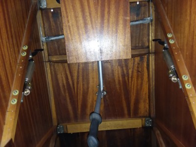

Like the heel brakes described by Barrett, mine are located under the front pax seat. I used Airheart small master cylinders. I designed mine to as flag pole levers. The attached photo shows them from above with the front seat removed.
They are never in the way in flight. I have to pull my heels slightly under the front seat to actuate the brakes on the ground. They work fine for runups and for navigating in close quarters on the ramp.

Ken: what's the nylon braided hose running down and out the bottom of the plane?
-Oscar Z.
Re: Brake master cylinder mountings

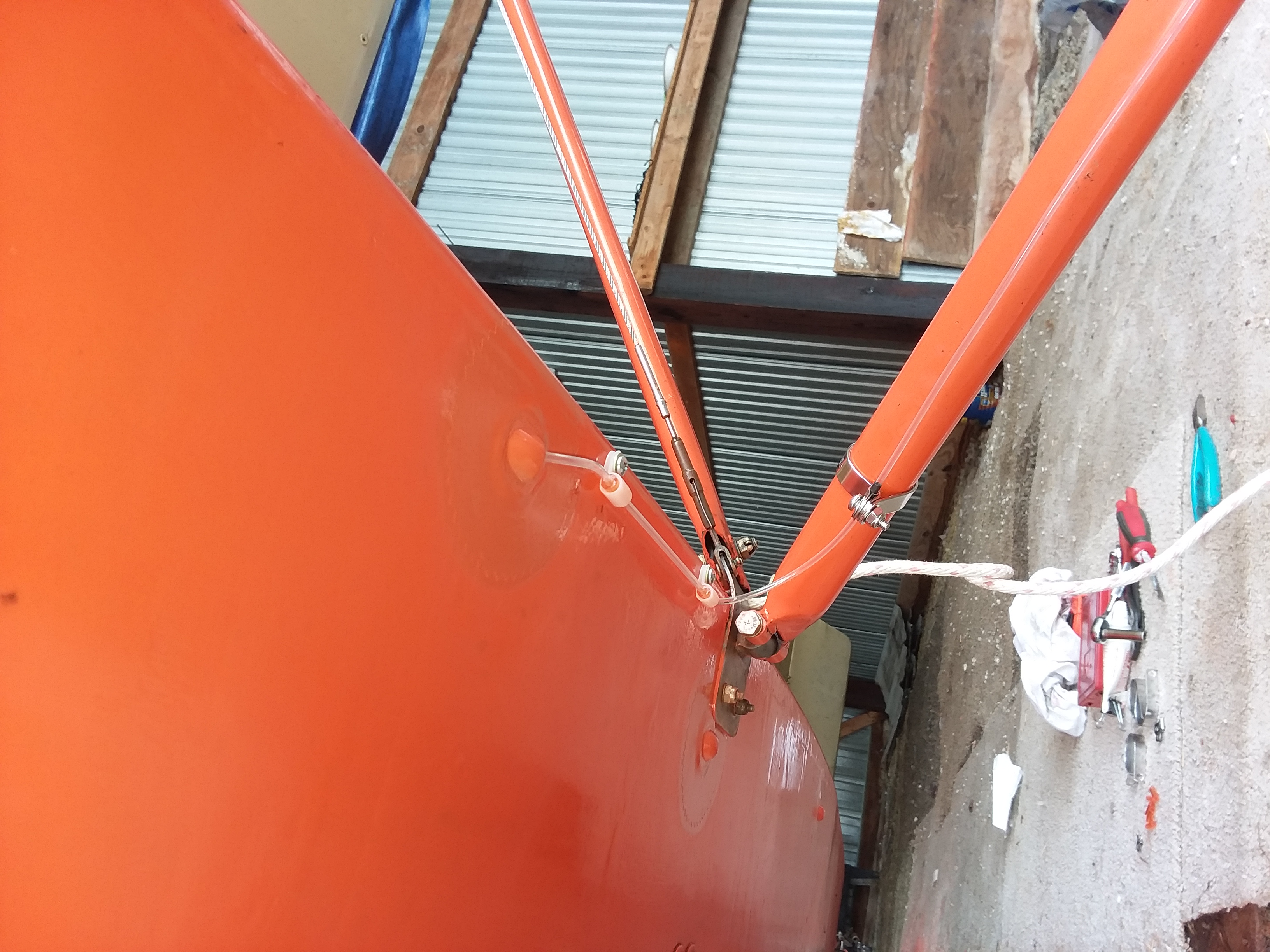

Oscar, I used the braided nylon hose as conduit for the wires from FWF to run up to the aft instrument pod. Not visible from the top-down photo is a small hole drilled in the hose at the low point when the airplane is sitting on the ground to act as a drain for any rainwater that might find its way into the hose. Cheers, Ken

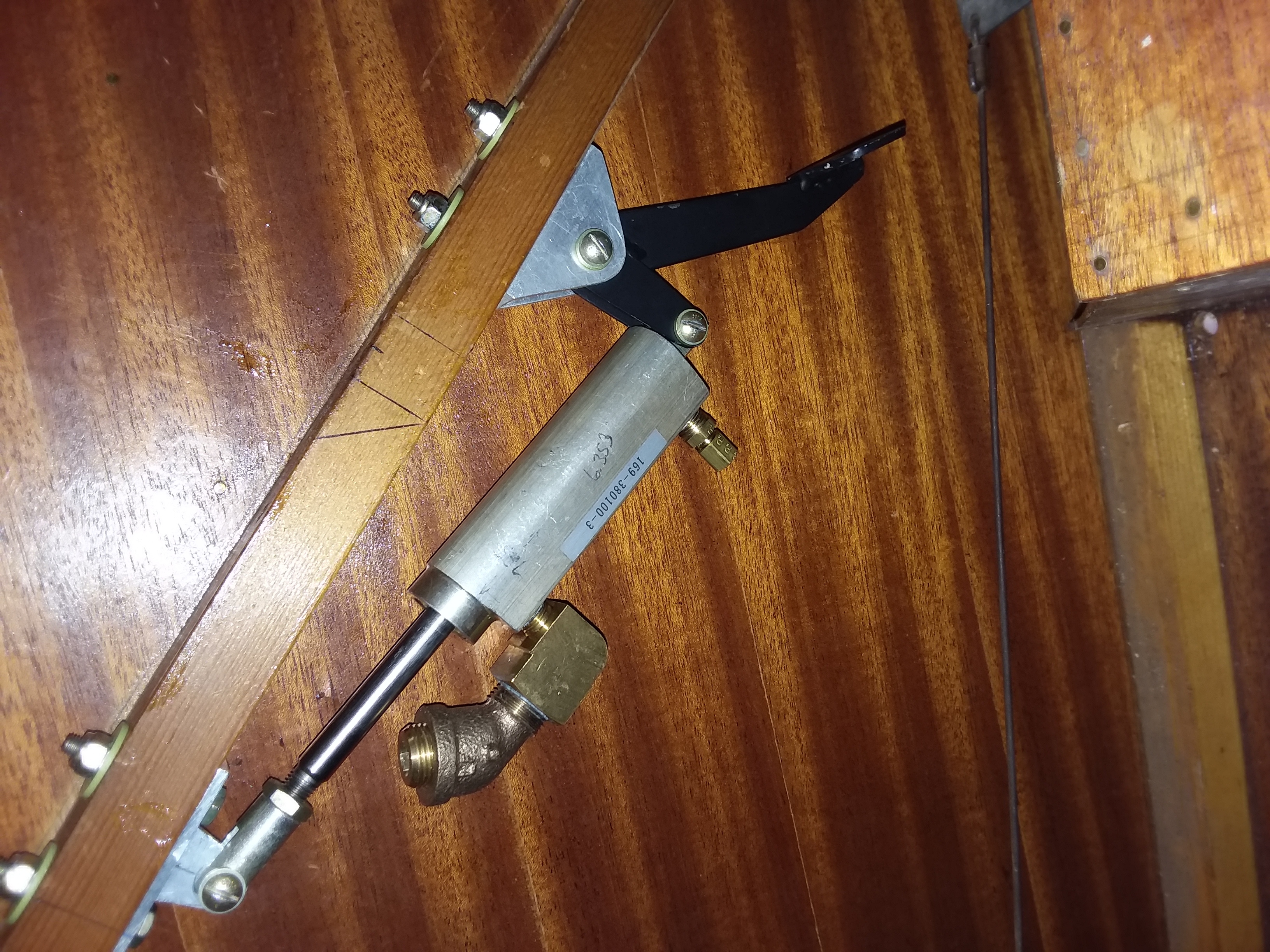

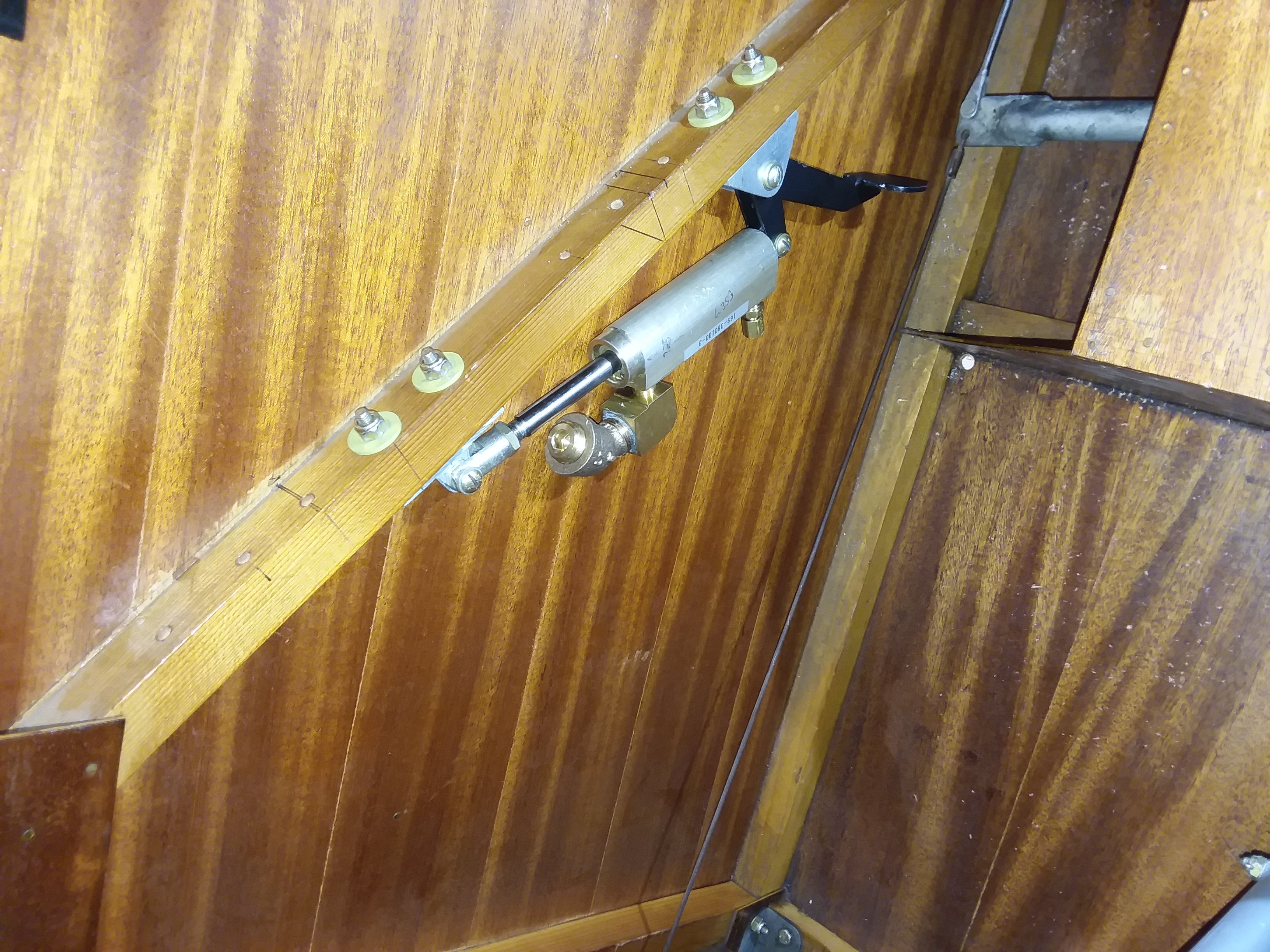

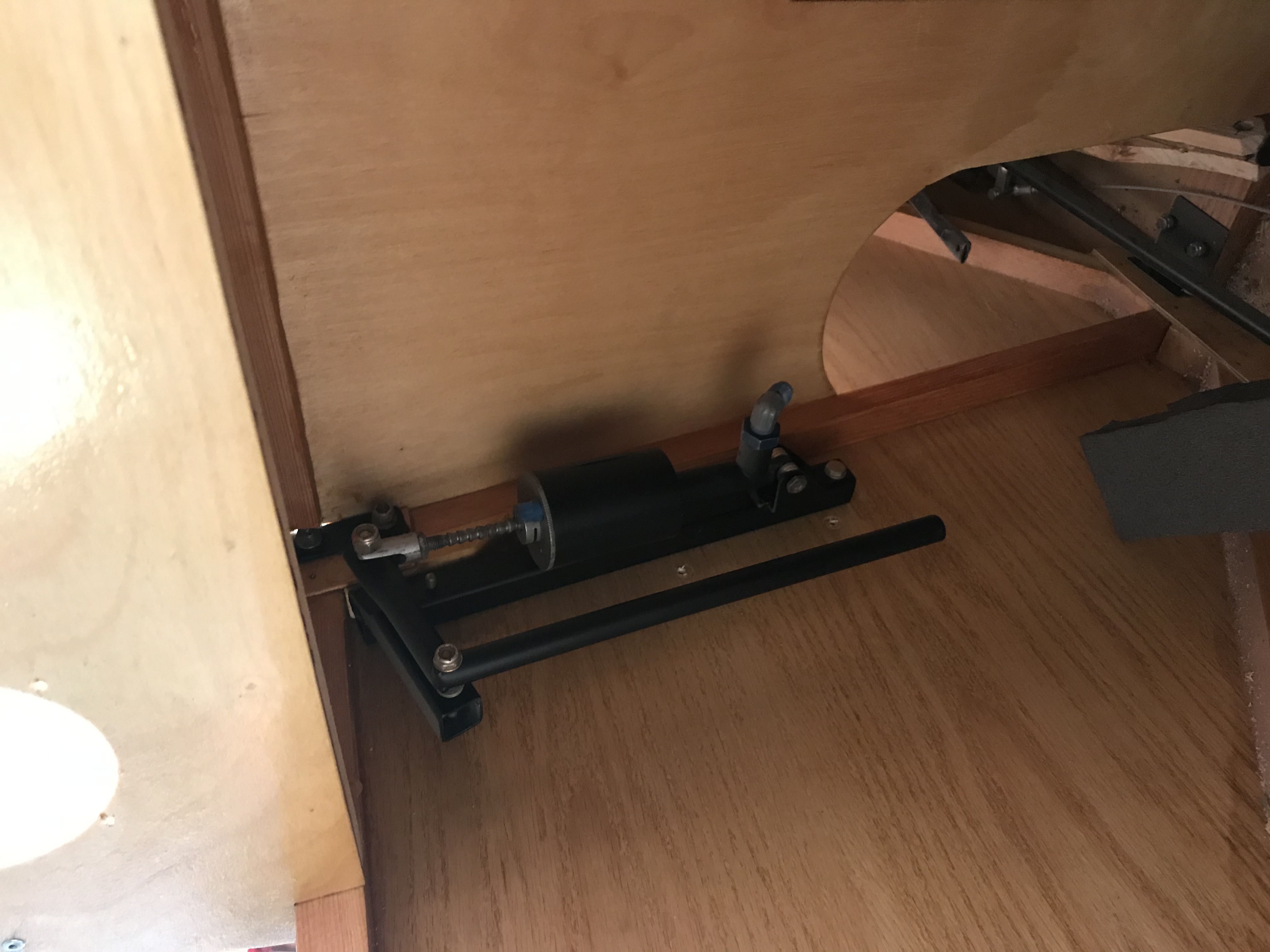

This is what I've come up with for the brake master cylinders. These are Cleveland masters that I happened to have, model #10-55. I bought these back in the 80's, for another project that never came off.
I got my wife into the rear cockpit and had her put her feet on the rudder bar so I could take measurements for the pedal location.

Richard: I think you're getting it! If it would help, I'd be happy to take measurements of the triangulated fuselage framing space where my brakes are mounted, as well as where the mounting points are located on the diagonal, to give you a point of reference to see if we're close to what you've come up with. It's easier to erase and redraw it in a CAD program than it is to plug drilled holes in your fuselage framing and make new holes if it needs adjusting later ;o) My setup may not be perfect or ideal, but it works fine and has done so for quite a few flight hours, under the feet of various pilots since it was first flown. I have a rudder bar in the rear cockpit.

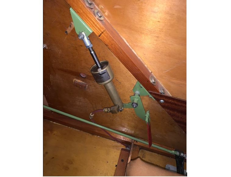

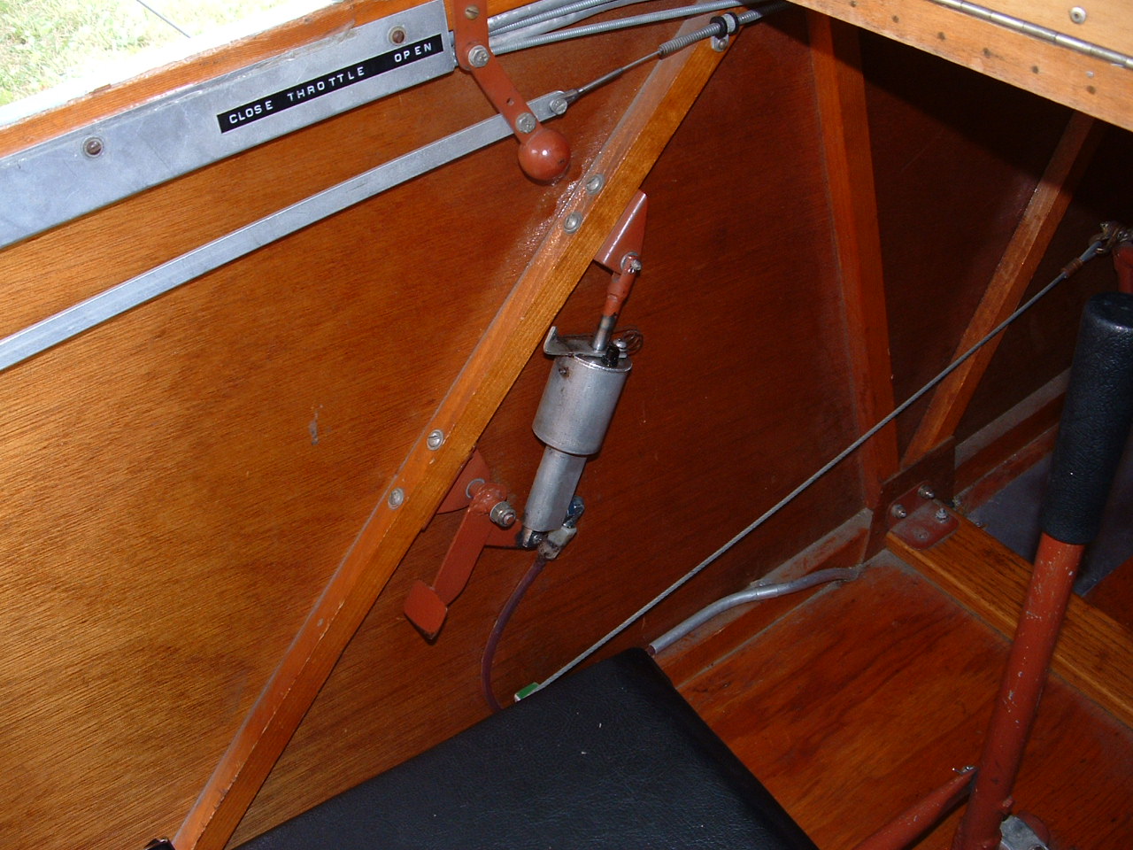

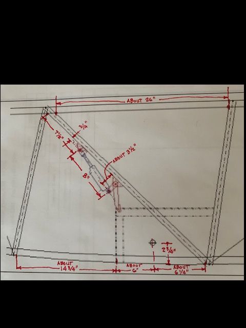

Aha. I knew I had a thread going somewhere on this subject. Here are the measurements of my setup, as well as a photo of the starboard side brake showing the welded-on tab on the pedal to make it easier to reach with the toe.

Richard; not saying "do it this way", just putting additional food for thought out there. I'm a bit curious about your leg length. Looking at my brake pedal location fore-and-aft relative to yours, either our cockpits are differently configured by a couple of inches, or my legs are shorter than yours because my brake pedals appear to be about 2" aft of where yours are in the drawing. I wear pants with a 32" inseam. Are yours by any chance a little longer, like 33 or 34"?

Oscar,
Have you thought of replacing the L shaped bracket that mounts the pedal with a U shaped bracket? There appears to be an eccentric load on the angled fuse member along with the bracket itself.
Tom

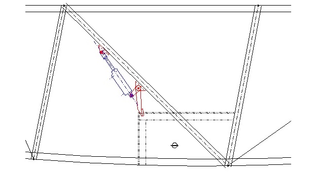

We seem to vary from .5" to 1.0" between what you measured and what I drew. The drawing is of the Piet plans. I did put my wife in the rear cockpit to get the measurements that I used. I'm sure it will work out okay.

Richard; I'm sure it'll work out OK... I just thought it might inspire confidence if you had some measurements off another airplane. Sounds like you and I are mighty close on ours so get busy fabricating those brake master mounts and actuators. You'll like having brakes.
Tom: looking at the geometry of the brake masters, the pedals where the braking force is applied, the brackets and their mounting configuration, there are of course a number of eccentric loadings in the picture. I haven't given it much thought because there are others out there flying with the same setup. The main thing I don't like about it are the 3/16" holes through the framing members to mount the brackets, but I had no choice in the matter so there it is. Corky built the plane; I just fly it, break it, and modify it ;o) Regarding the braking force applied by the pilot's feet, there is an unintended but definite restraint that prevents the application of too much force to the pedals: the front support for the front seat. I know this because I have twice broken it loose from its mounting point at the cabin floor when I pressed a brake pedal "energetically" a time or two. The last time it happened, I removed the entire front seat frame, scraped everything back to flush clean wood on the cabin floor, and reinstalled the seat support using a crossmember the full width of the floor, from longeron to longeron, and made it the full size of the longerons to give the seat support plenty of glue area to attach it so as to resist breaking loose if I overdid it with the brake again. The rudder bar has its own stops (a la Mike Cuy's blocks), but the brake pedals were hitting the seat support. Incidentally, when I took the existing seat support framing apart to rework it, I found that it had apparently broken loose before I had the airplane and had been 'repaired' using Gorilla Glue. I hate that stuff! It foams up and fills the gap alright, but it's not structural... the hardened foam glue snaps like peanut brittle. I know why it was done that way... out of convenience and to get a feeling that a poorly-fitted joint could be gooped full of stuff that foamed up to fillet across an ugly gap and look like a real glue joint when it dried, but it wasn't. I think it is now though.

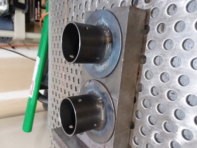

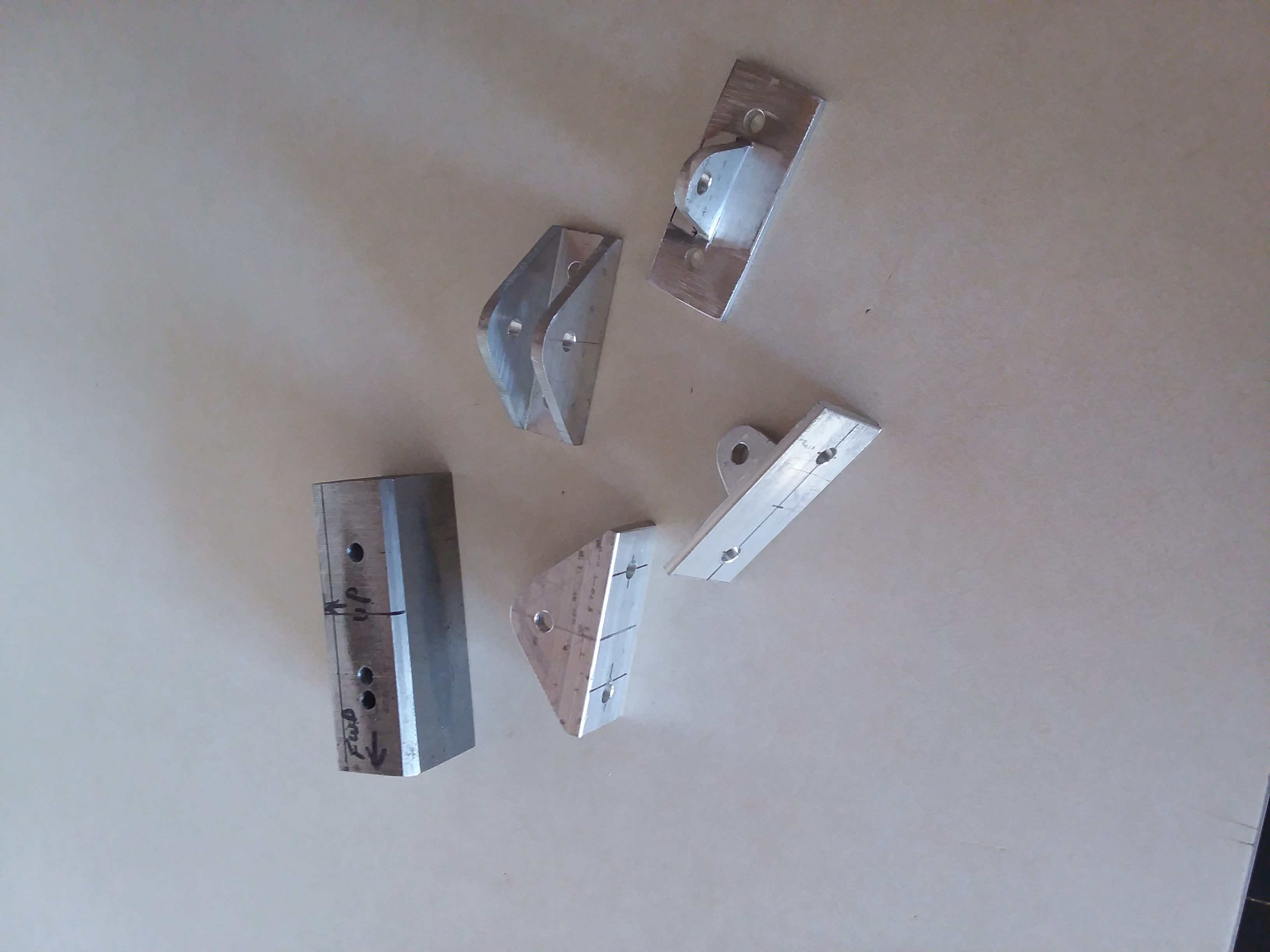

I made a set of brackets for the master cylinders. The piece of 1" key stock is the drill guide from the tail longeron repair. I added an extra hole to match the hole spacing for these brackets. It'll be clamped in place and the holes back drilled through the station diagonal.

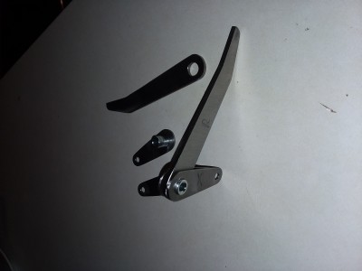

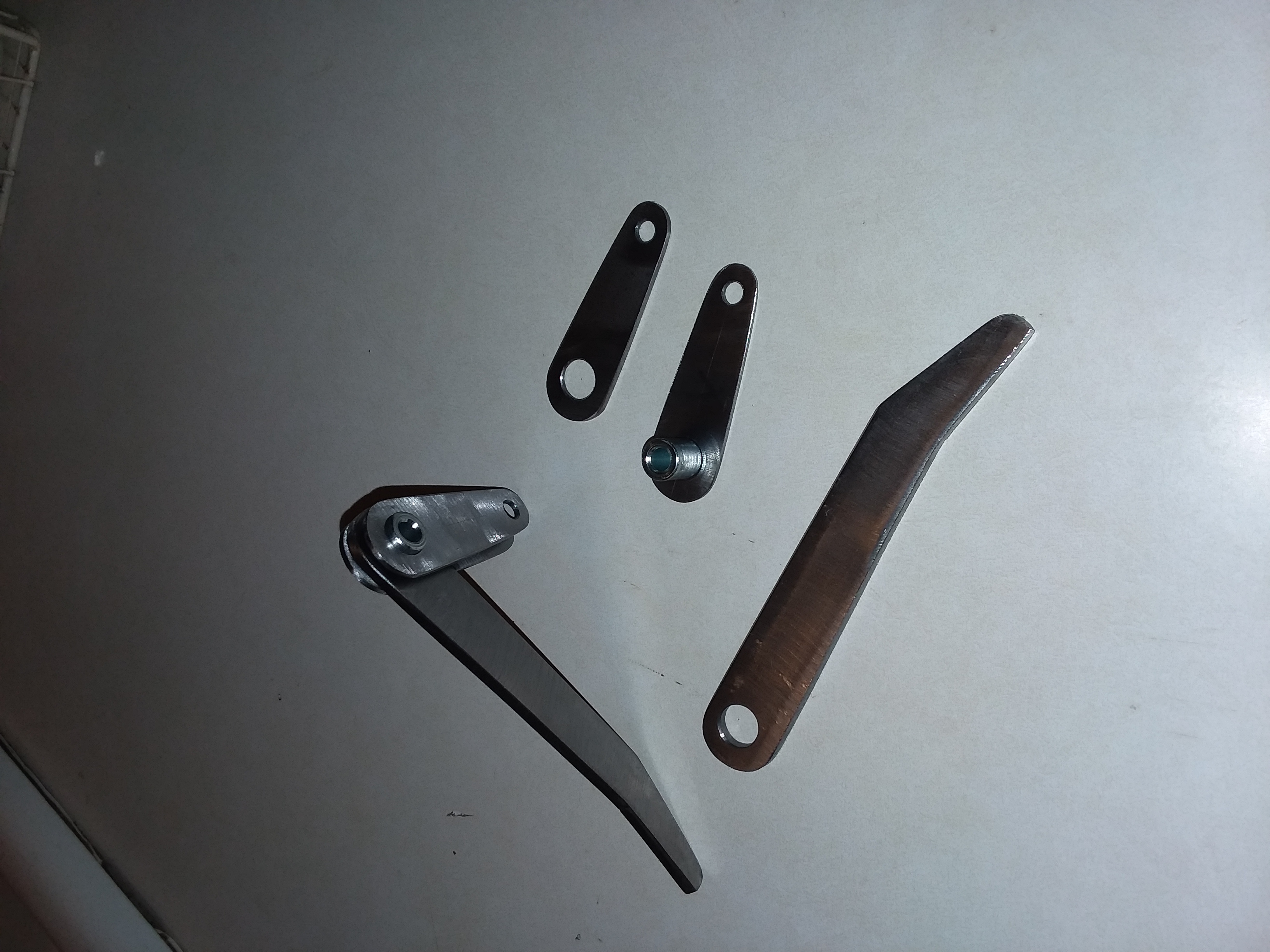

I've cut out all the pieces for the actuators foot pedals. I also have hooked up my tig welder. So...., after I get some practice welds in I'll try assembling the pieces. Wish me luck.

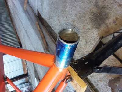

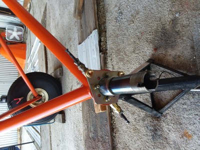

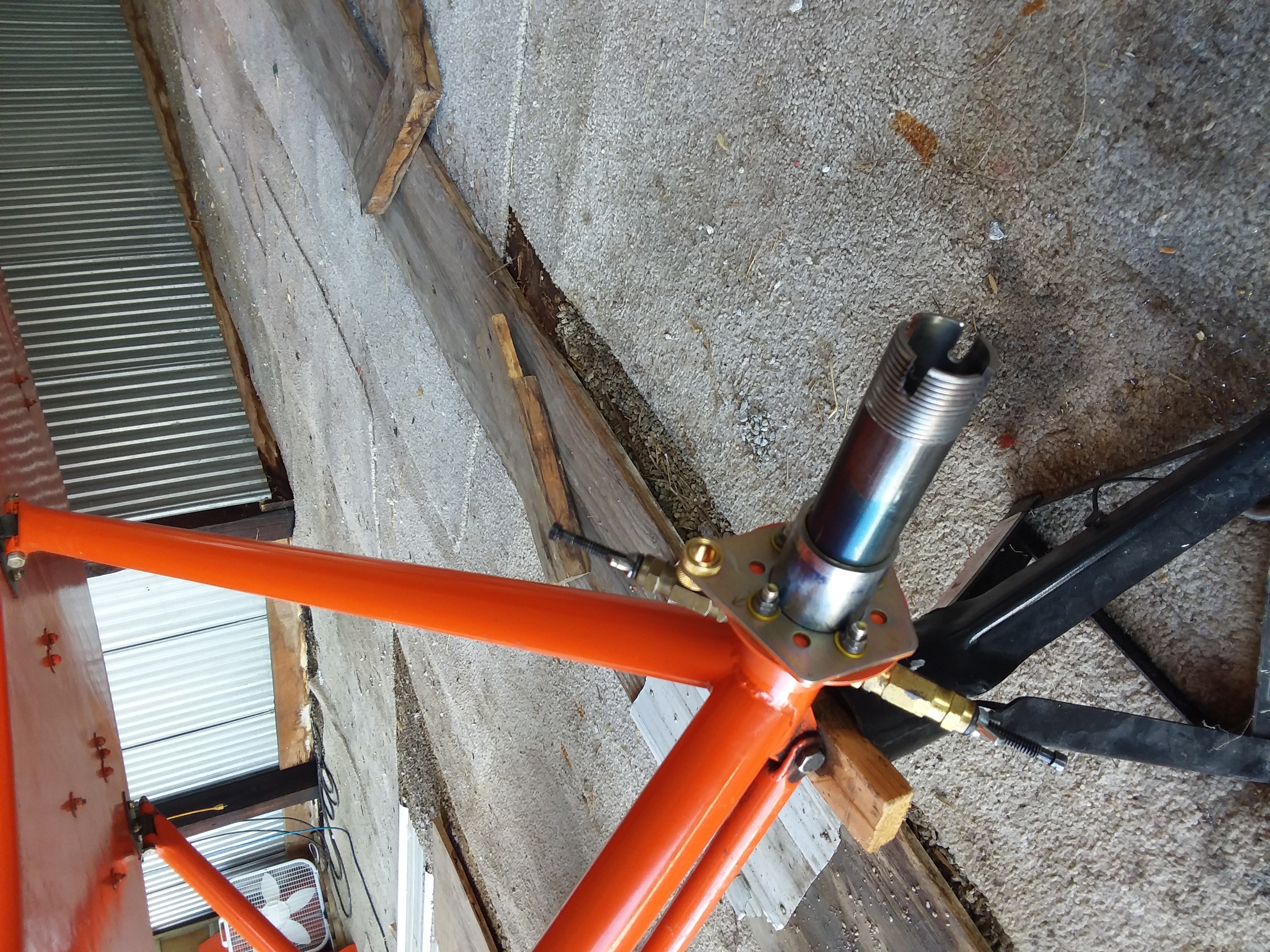

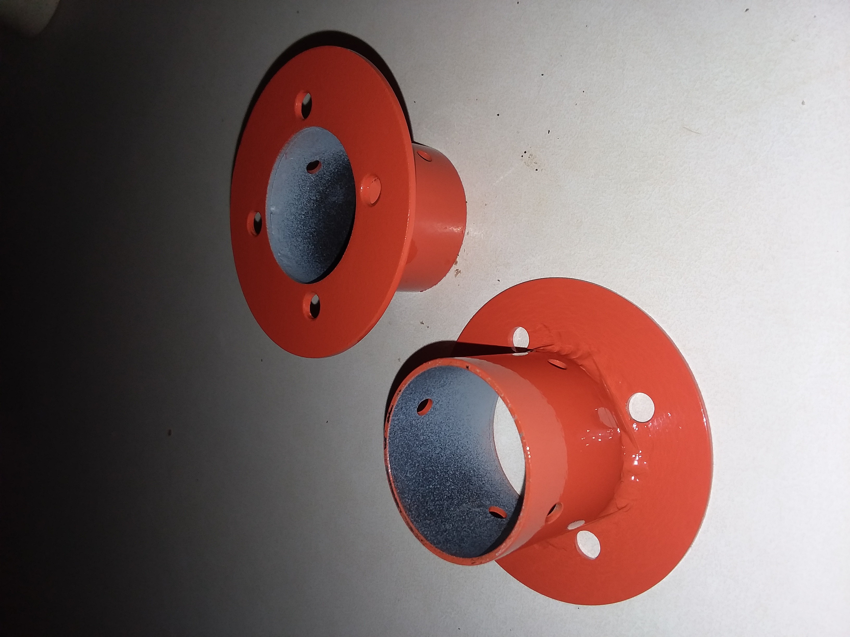

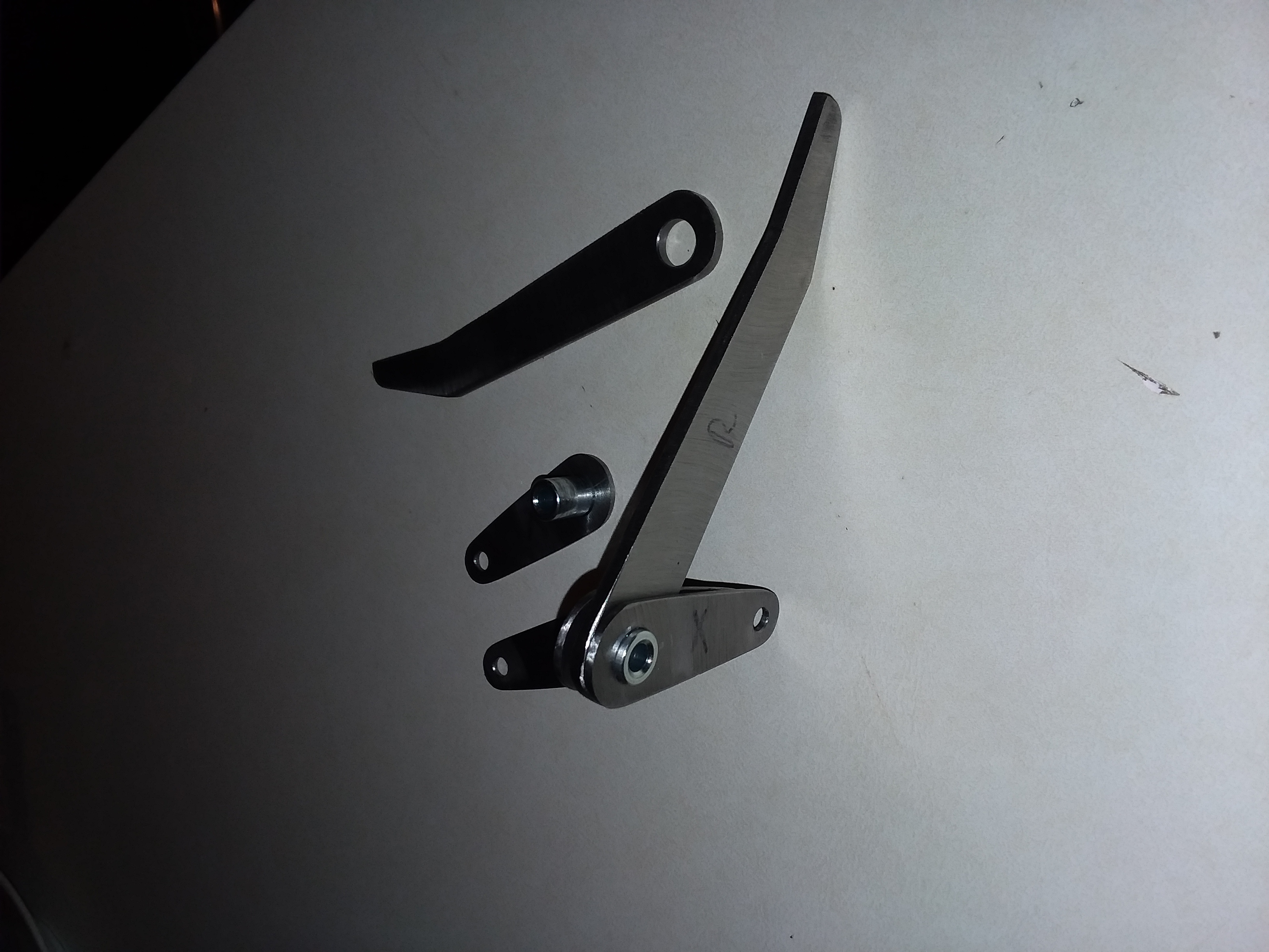

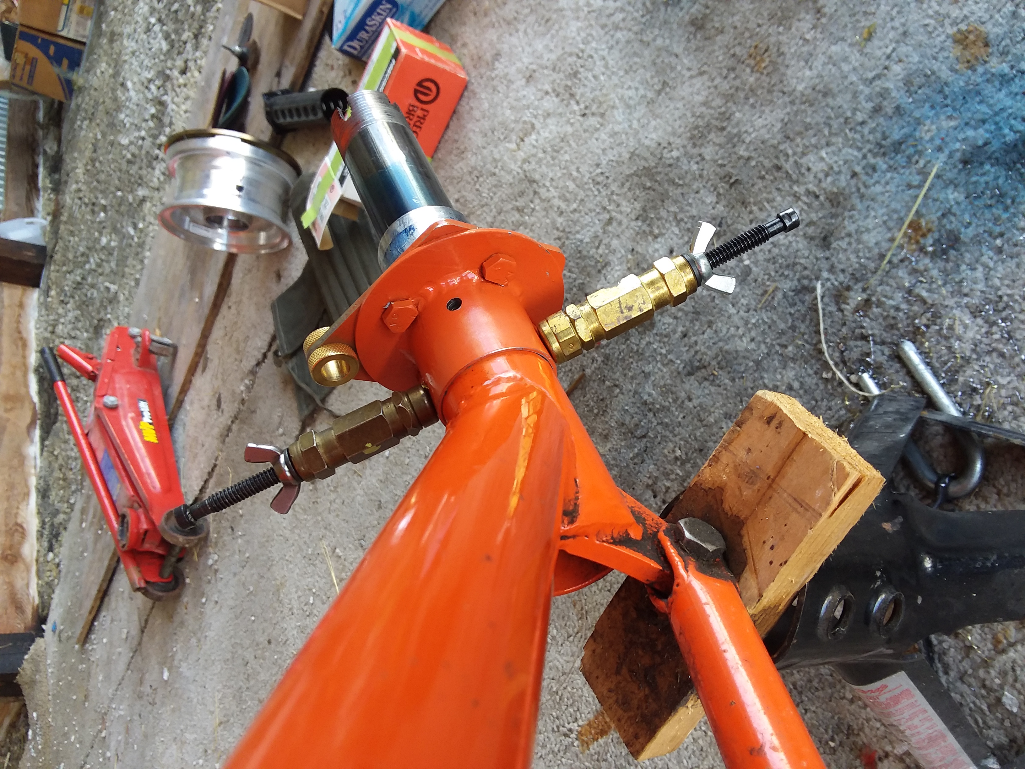

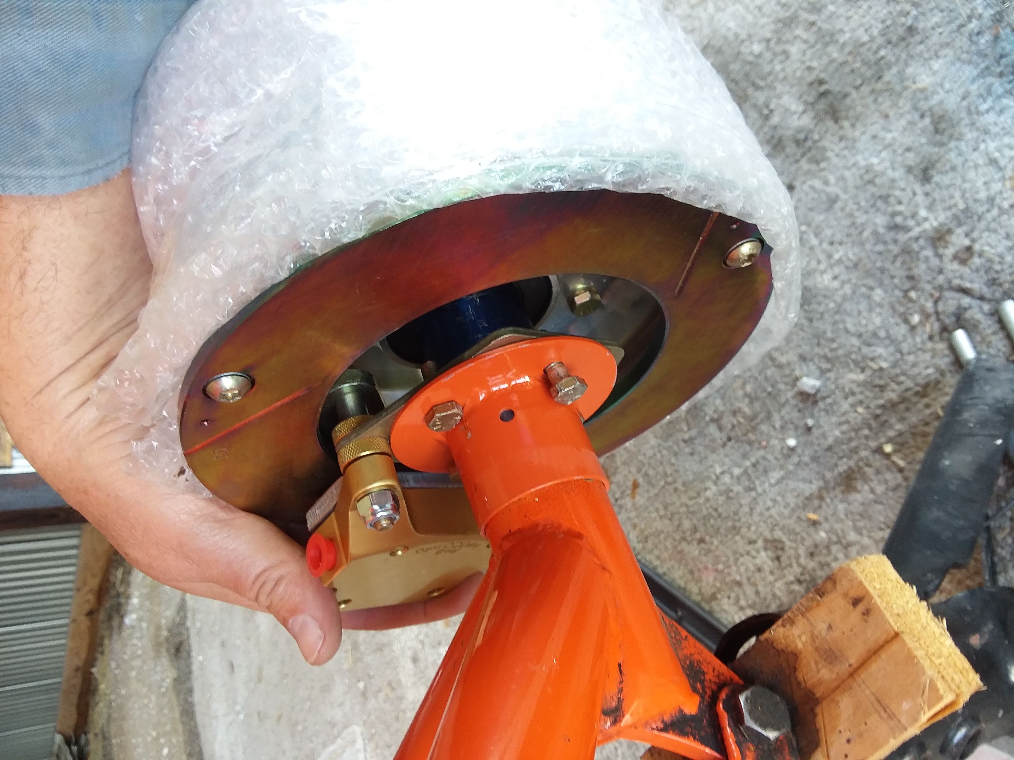

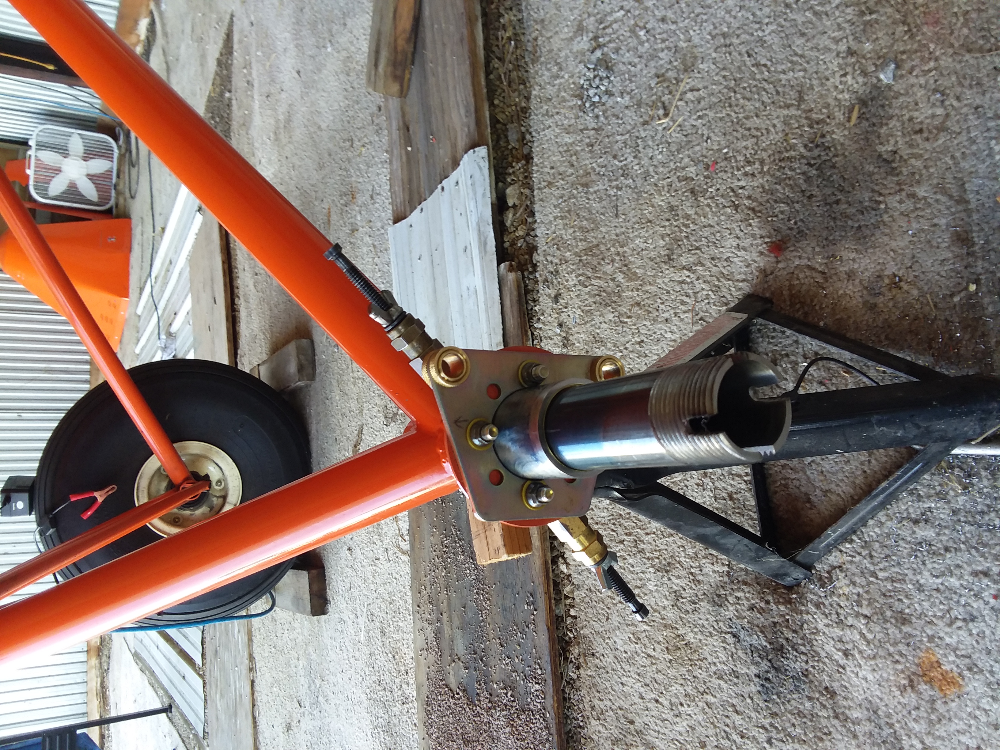

I was going to post pictures of the brake pedals, but I just realized I didn't take pictures of them. So here is a photo of the adaptors for the brake torque plates. They will bolt over the trimmed 1-1/2" axles and the 1-1/4" axles will slide inside.
Posts: 259
Torque plates for the Piets new brakes.
Posts: 259

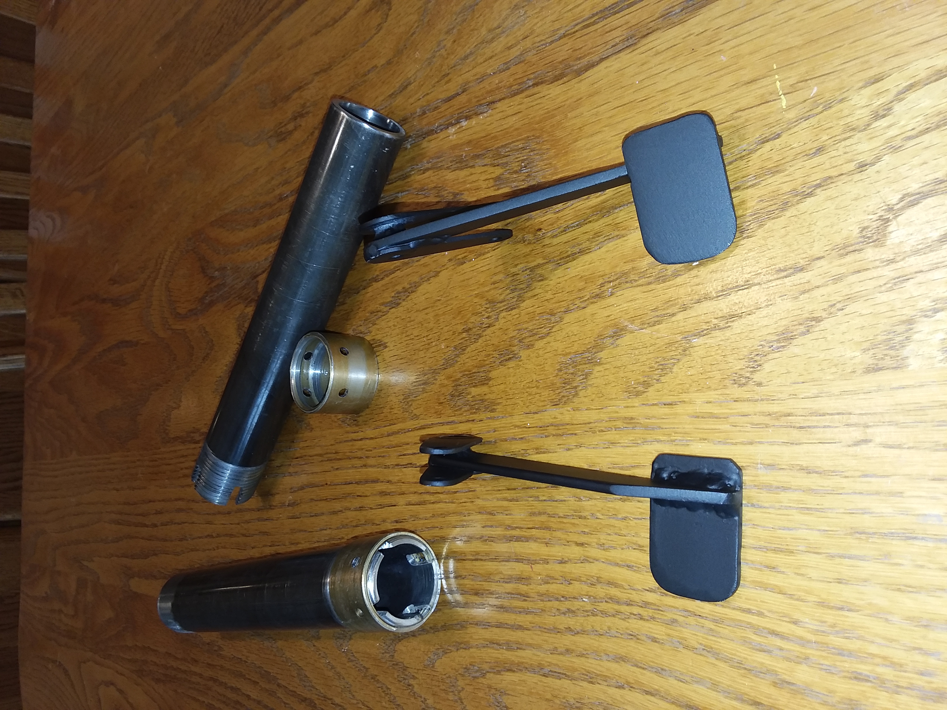

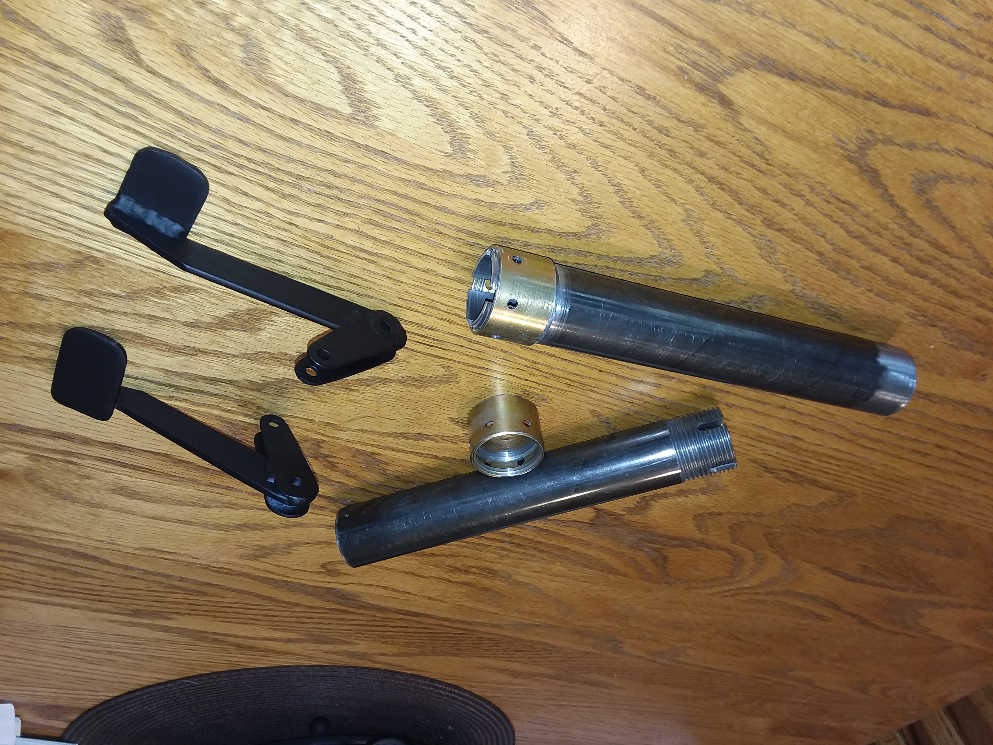

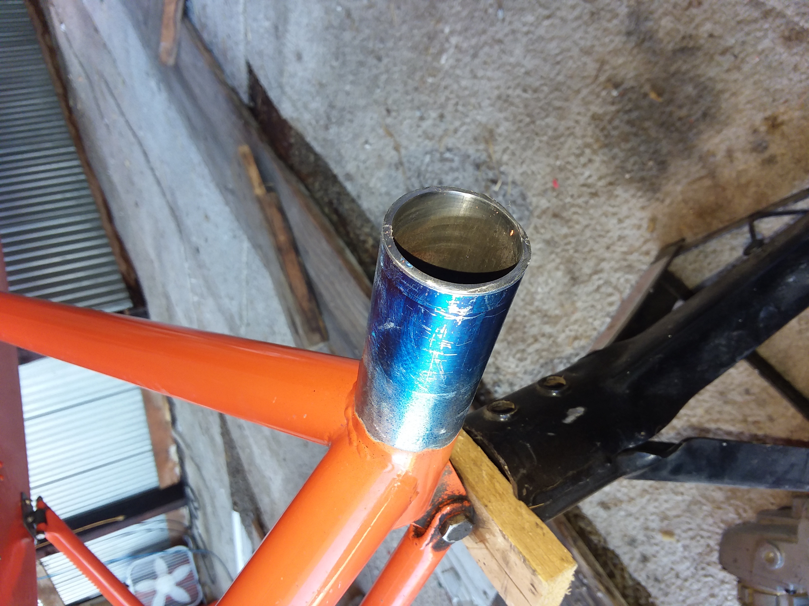

Pictures of the brake pedals and the finished axles for the Matco wheels and brakes. I will drill the axle attach bolt holes when in place.

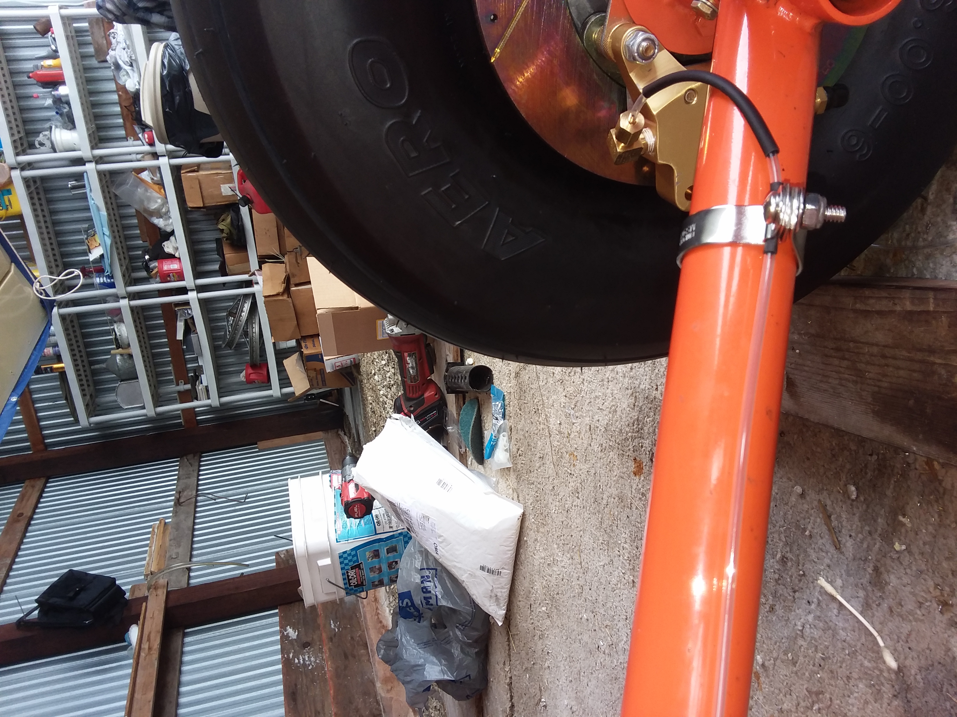

Posts: 259

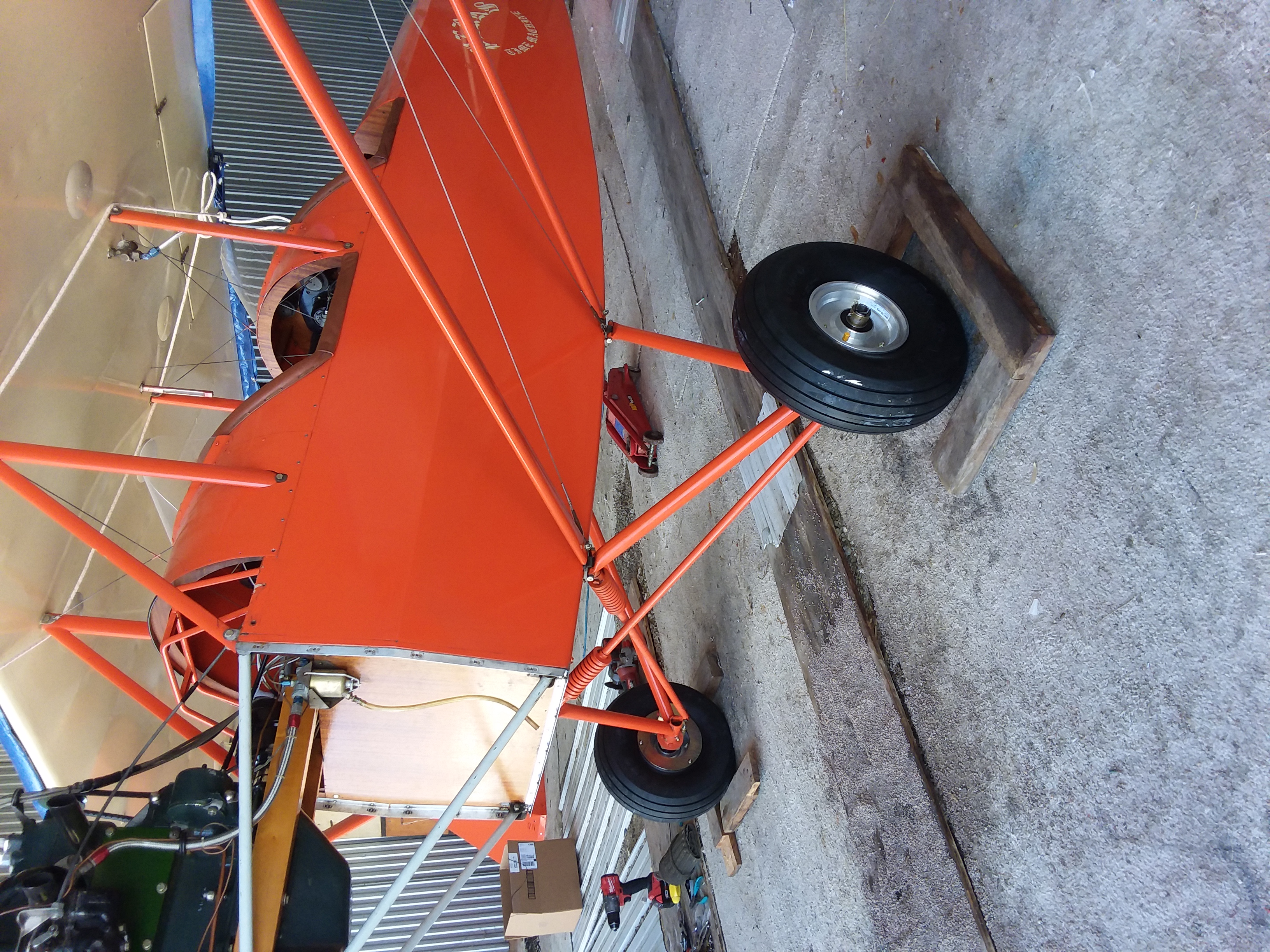

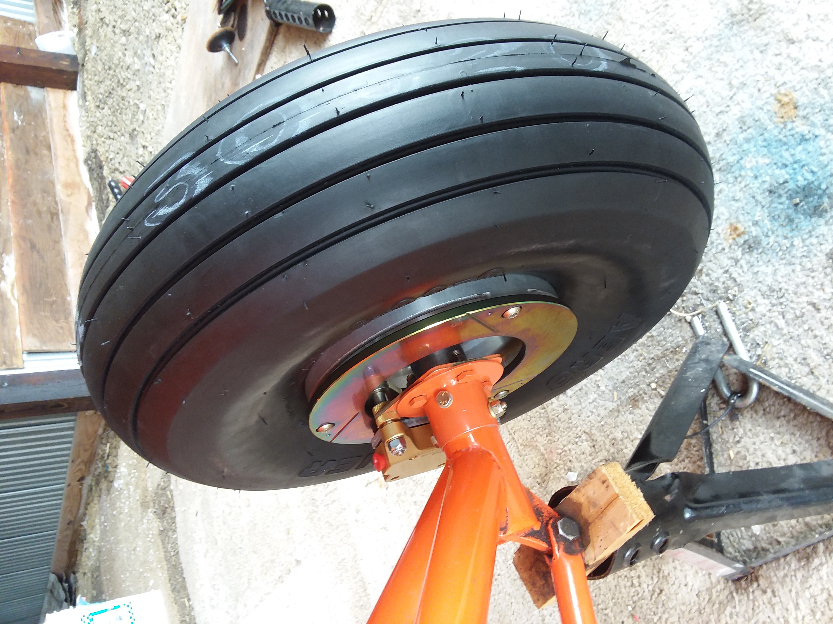

A test fitting.

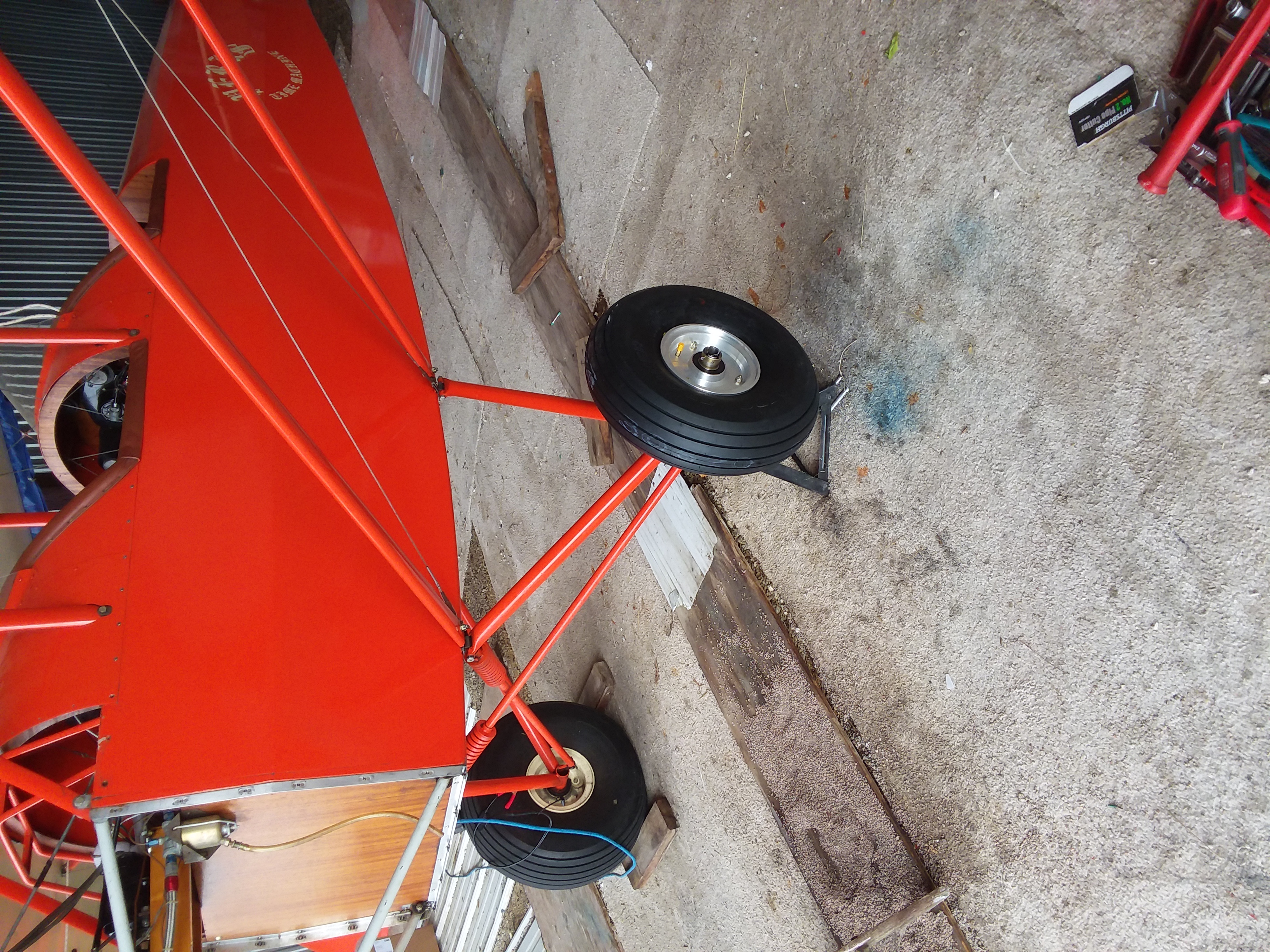

The new axles and wheels in place. They are not drilled and bolted yet. The axle stub is the existing 1-1/2" axle after being trimmed.

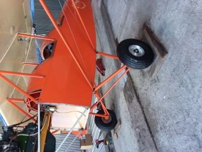

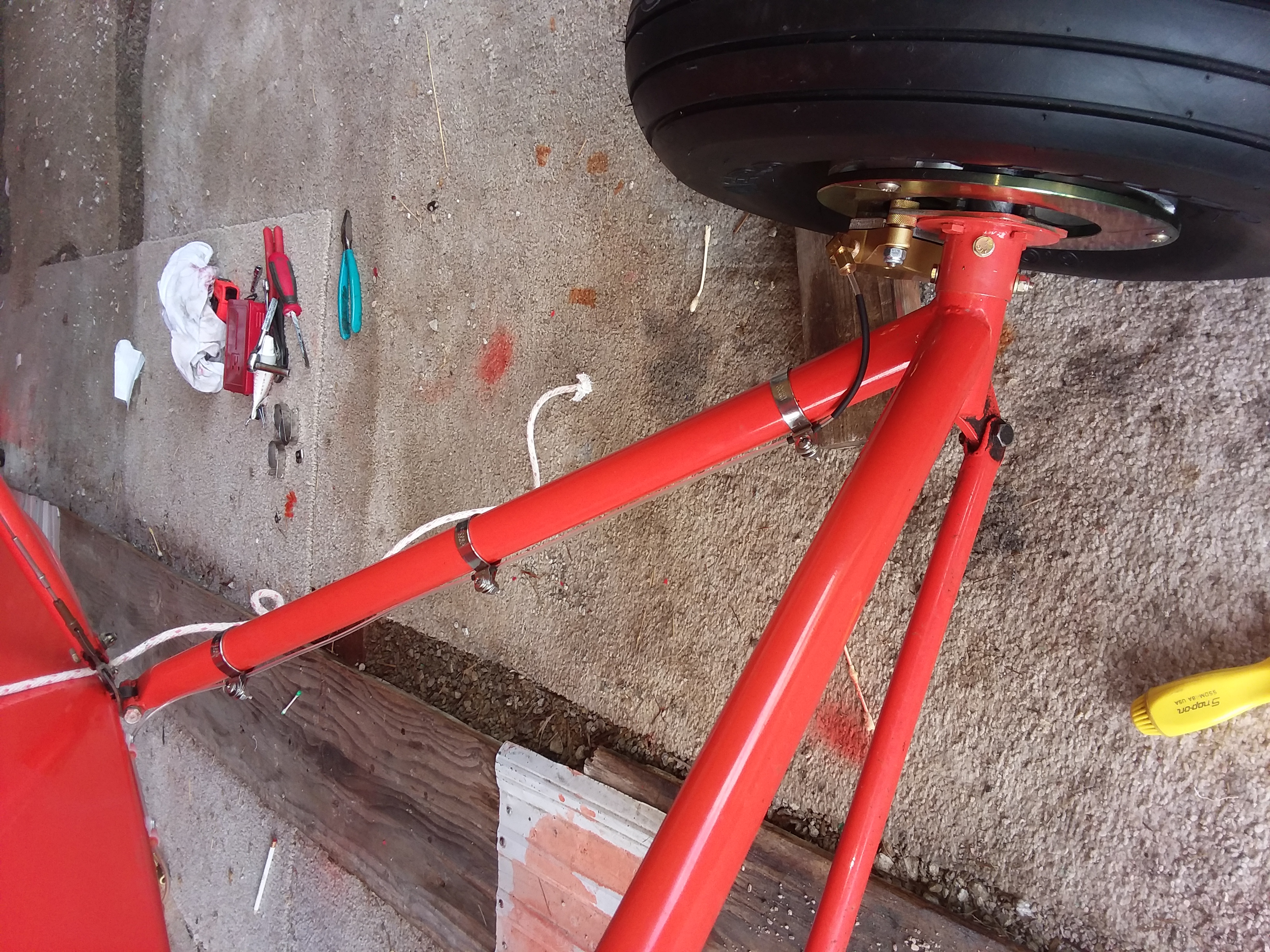

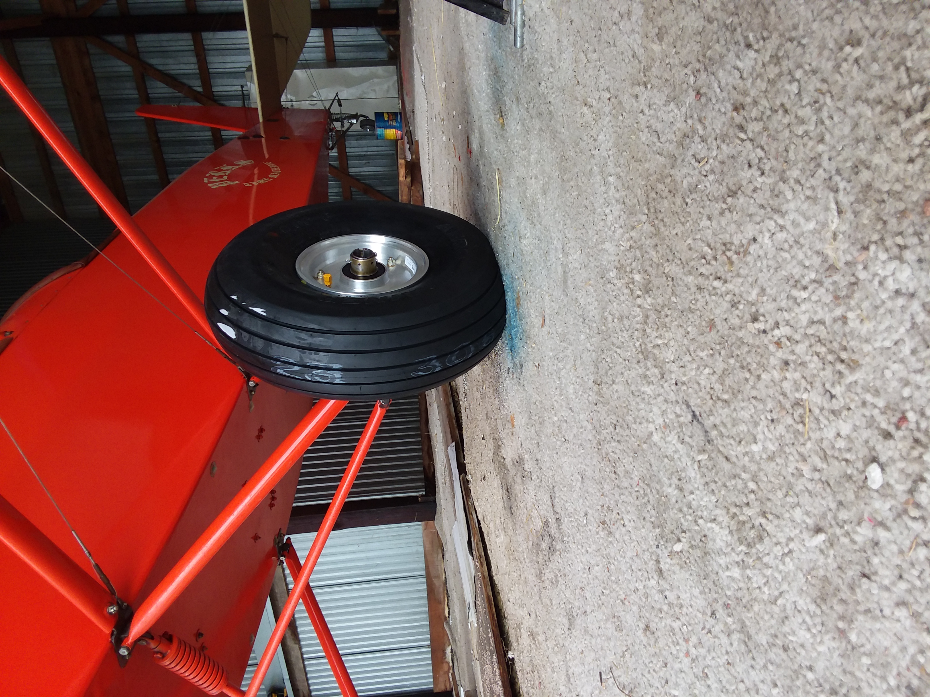

Left main on the ground. It looks so strange with a 6:00 x 6 tire instead of the 8:00 x 6 that was on it! I may have to go back to the old tires. Time will tell.
I haven't ran the hydraulic tubes yet, or installed the master cylinders.

N34KP is standing on two new main wheel and brake assemblies now. Master cylinders and plumbing next.

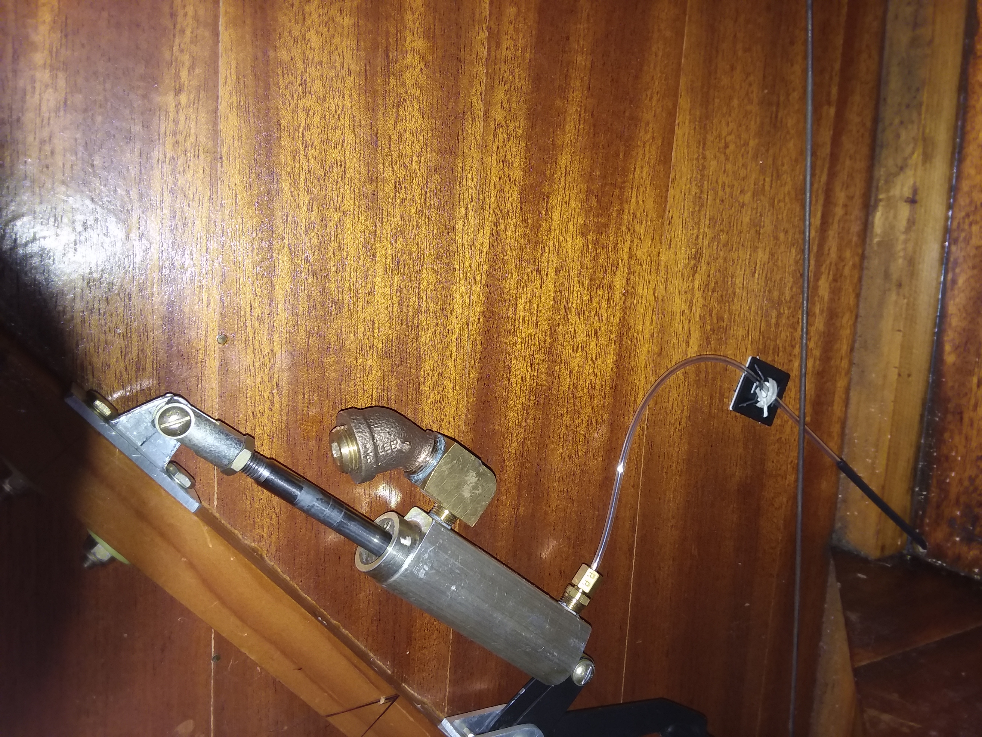

Hey Oscar. How'd you like those fancy reservoirs? Just for grins I weighed the master cylinder assemblies. Everything including hardware (no fluid) is 1 lb. 2 oz. each side.
Posts: 648
Yes, I noticed those reservoirs. I like your brake pedals, too. What brake line tubing are you planning to use? I used Nylaflo on mine after reading up on the pros and cons. It's not recommended for brake lines where the wheels and brakes are inside of tight-fitting wheel pants or on planes that operate at higher speeds with smaller wheels and brakes where things get pretty hot in a hurry. The end at the brake fitting can get hot and either slip off, melt, blow out, or otherwise fail. In my case, with big Clevelands off of a C172 with a gross weight about twice that of my Piet, my brakes don't ever work very hard or get very hot and I don't have wheel pants or fairings to hold the heat in close to the brakes. Outside the cabin, I tried to run the lines tight to the backside of the gear leg tubing without loose loops or slack, just enough at the brake to make the sweep into the fitting on the brake cylinder. I like to operate off of grass and don't want to be afraid of unimproved fields where weeds or grass could grab at a brake line that's out where it can snag on something. I guess I could have used aluminum tubing but I don't like that stuff very much.
We have operational brakes! I haven't been able to taxi test yet, the propeller is still off, but I've bled the system and they are nice and firm with no leaks. So far no leaks, anyway!
Posts: 648
Looking good, and they will no doubt work just fine for you. Nice closeup of those fluid reservoirs on the brakes... from the plumbing section of the aero supply store ;o) It looks like your tires are McCreary Aero Trainers. Same as what I fly except mine are 6.00x6s right now; going to 8s one of these days.
