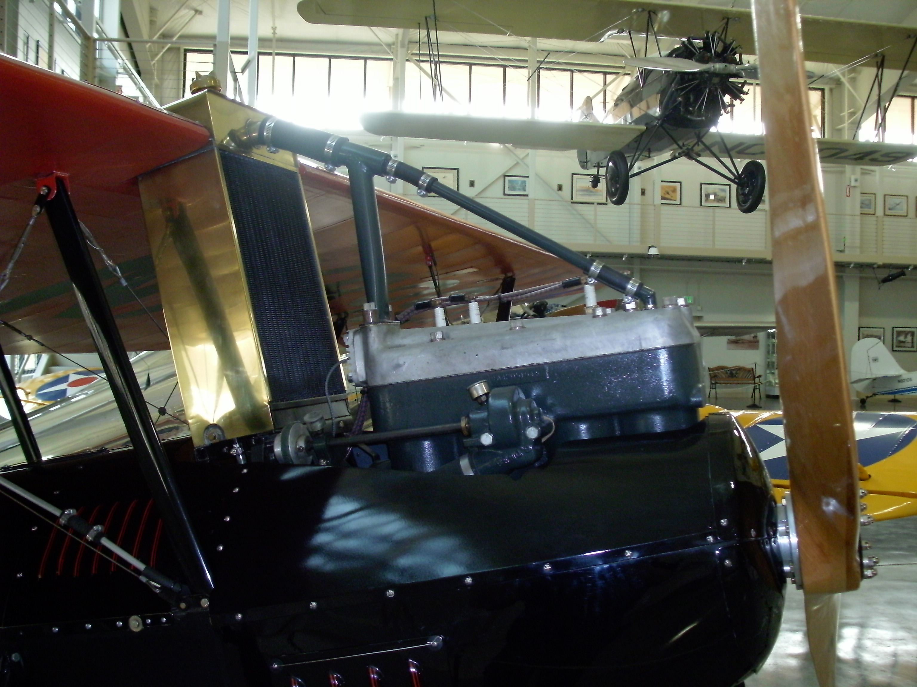

John, I'm sorry for the delay in getting back to you. I've been through the digital pictures I have of Brodhead and have found none that would help you. I know I've taken some, but they must be on film and I have no idea where they might be. I did find some on the West Coast Piet site just by browsing. I'm not sure they were washing machine pumps, but they were side mounted.
