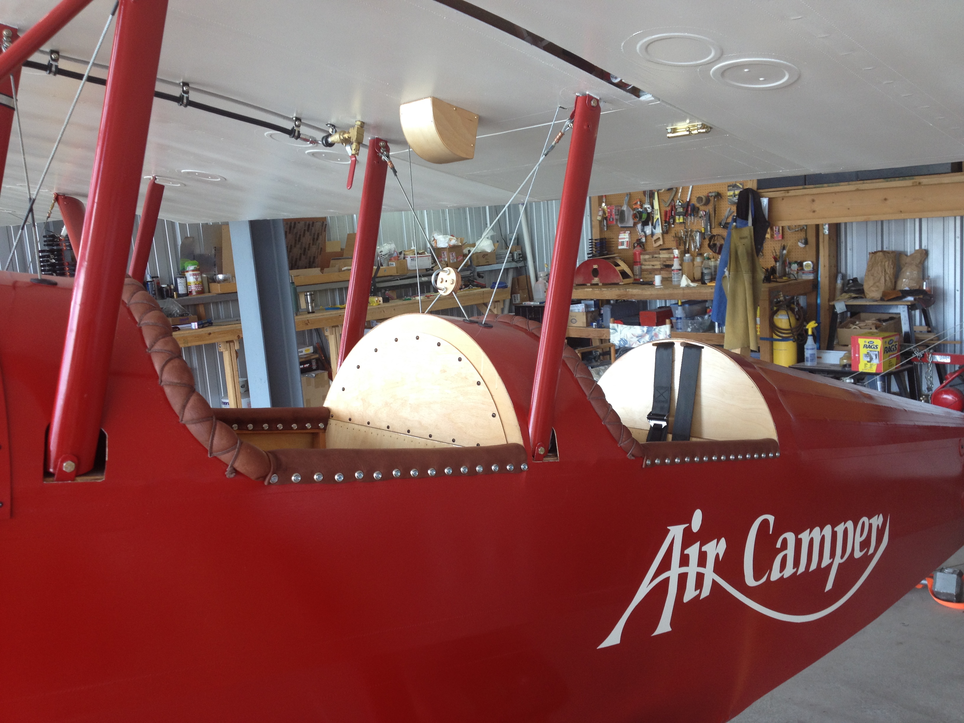

I remember seeing someone's setup for mounting their compass on the underside of the wing, which looked like a pretty slick setup. I'm thinking of moving mine out of the panel and I don't have my fuel tank up in the centersection and could consider mounting the compass up under there. Any ideas would be welcomed; photos would be especially welcomed, or at least the name of the airplane's owner so I could go look at pictures of it on Westcoastpiet.

Oscar, I used a compass that is sold for marine applications. It handles turbulence well. Here's a pic of it. Lots of changes between that picture and the finished airplane, but the compass and its box have worked well as originally installed. Cheers, Ken

Oscar, here's another view of the compass and its box (pre-paint).
Note: I removed the center section tank as part of weight savings plan. I've never missed it, as the nose tank has greater duration than my backside does.

Ken; thanks for confirming the path I've decided to take... under the wing. I had that same, or very similar, Ritchie compass in my Amazon shopping cart till I found one by Silva that looked like it might provide a slimmer profile and perhaps simpler mounting and more adjustable viewing angle. Undecided on the exact selection, but pretty well decided on moving my compass up top. The only thing I'll need to change up there is the linkage that I have in the aileron crossover cable in the centersection. The linkage between the port and starboard cables is directly above where the compass will be, and it's a pair of steel straps with clevis pins on each end, capturing the ends of the two cables. That linkage features importantly in wing removal, but it slides left and right as the stick is moved, obviously an influence on the compass, so I'll remake the linkage straps in aluminum and just have to deal with whatever swinging remains when the clevis pins and attaching hardware move back and forth up there.

Agreed. I tried a bunch of places on the panel and never found a spot without significant impacts on the compass. Under the wing, it hasn't been a problem. I did move it forward an inch or three so that it would not be over the aileron cables. It is actually easier to read when set a little bit forward. Too close and at that angle, I need to turn my bifocals upside down :)

Just looked at the pic again... I see that your compass is mounted just ahead of the rear spar. Got it.
Also noticed that you used my U-bolt trick on the cabane braces for mounting the passenger's shoulder harness to. How's that working out? Mine works great.

I wondered where I got the idea to use the U-bolt. I owe you appropriate citation!
