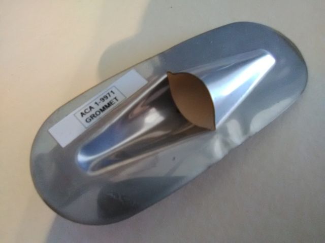

Hey Barrett, check this out. "Dan" in Texas emailed me with this nifty idea, premanufactured parts, not expensive, might give you some ideas. From Dan:
American Champion Aircraft part number 1-9971 grommet.
As measured = 120mm X 47mm a.k.a 4 11/16" X 1 14/16".
$9.71 each.
91 in stock this A.M. Yes, I called and ask 'em.
http://www.americanchampionaircraft.com
800 223 9381 (ask for parts dept.)
aca.aircraft.parts@gmail.com

Oh, very interesting! I’m headed to the airplane today to do some puttering. I’ll have to see if those might fit. I’m taken with the idea of making my own now, but that could be a good pattern to work from.
