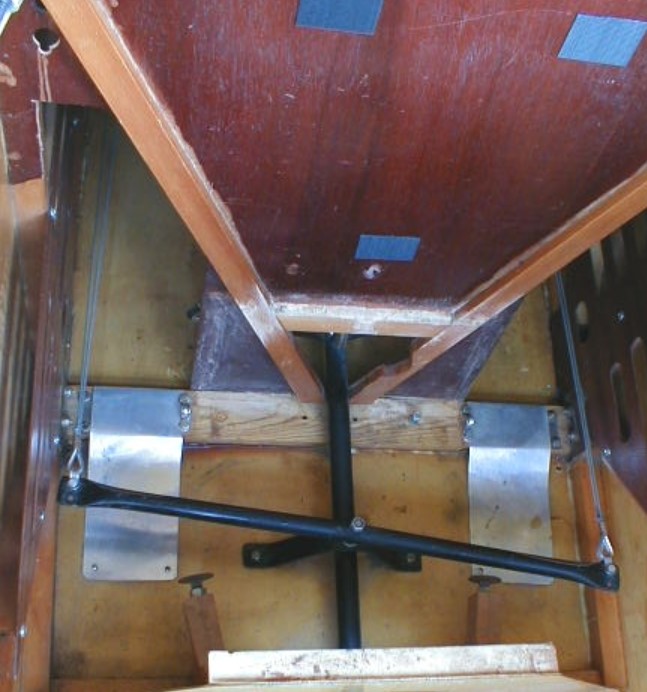

Just finished the controls and test fit in the fuselage and I notice when the control (stick) is all the way to the left, the tube that connects the two control sticks hits the cutout in the back of the front seat. I can't really cut out the opening any because it will cut into the wood bracing. Everything is being made to the plans (long fuselage) and the dimensions are correct. The stick movement to the right is considerably more as the tube is not on that side. Am I to assume that the left throw (distance) is enough as is? If not, any suggestions on a fix?

JimBob; this has come up before and is not a new issue. My airplane has a half-round notch taken out of the side you're referring to, and I think others have done that as well. See pic.

I moved the connecting rod to the right side of the sticks. My hand hits my knee before the rod hits the seat back.

Jimbob;I crossed the for from front to back. Put the front on the right and the back on left. No notch needed.

Jimbob;I crossed the rod from front to back. Put the front on the right and the back on left. No notch needed.

I looked at 34KP. It looks like Ken built it to the plans in reference to the seat cutout. I set in it and the stick hits my legs before it hits the cutout. There is no sign of the tube hitting the cutout.

In a series of emails with Oscar sometime ago together we determined that indeed the stick is stopped by your knees prior to touching the stops.
In other words, the design does not permit for full aileron travel unless you’re not sitting in the aircraft!
If Anyone reading this has a different bellcrank that provides full aileron deflection when in the airplane, I’d be very interested in seeing how this was achieved.

Tom Kreiner saved me the trouble of making a run out to the airport to check the stick travel on 41CC. He pulled up an email from back in 2017 where I had already done that... sat in the plane and pushed the stick left and right as far as I could, and I surprised myself to find out that with my knees hard against the sides of the cockpit and the stick pushed firmly into the insides of my thighs, the aileron bellcrank never touched the floor on either side. So, apparently there isn't much need for heroic measures like carving a semicircle out of the front seat back support so the stick gets its full travel, because your legs become human aileron stops anyway! So now back to your regularly-scheduled Pietenpol building!
