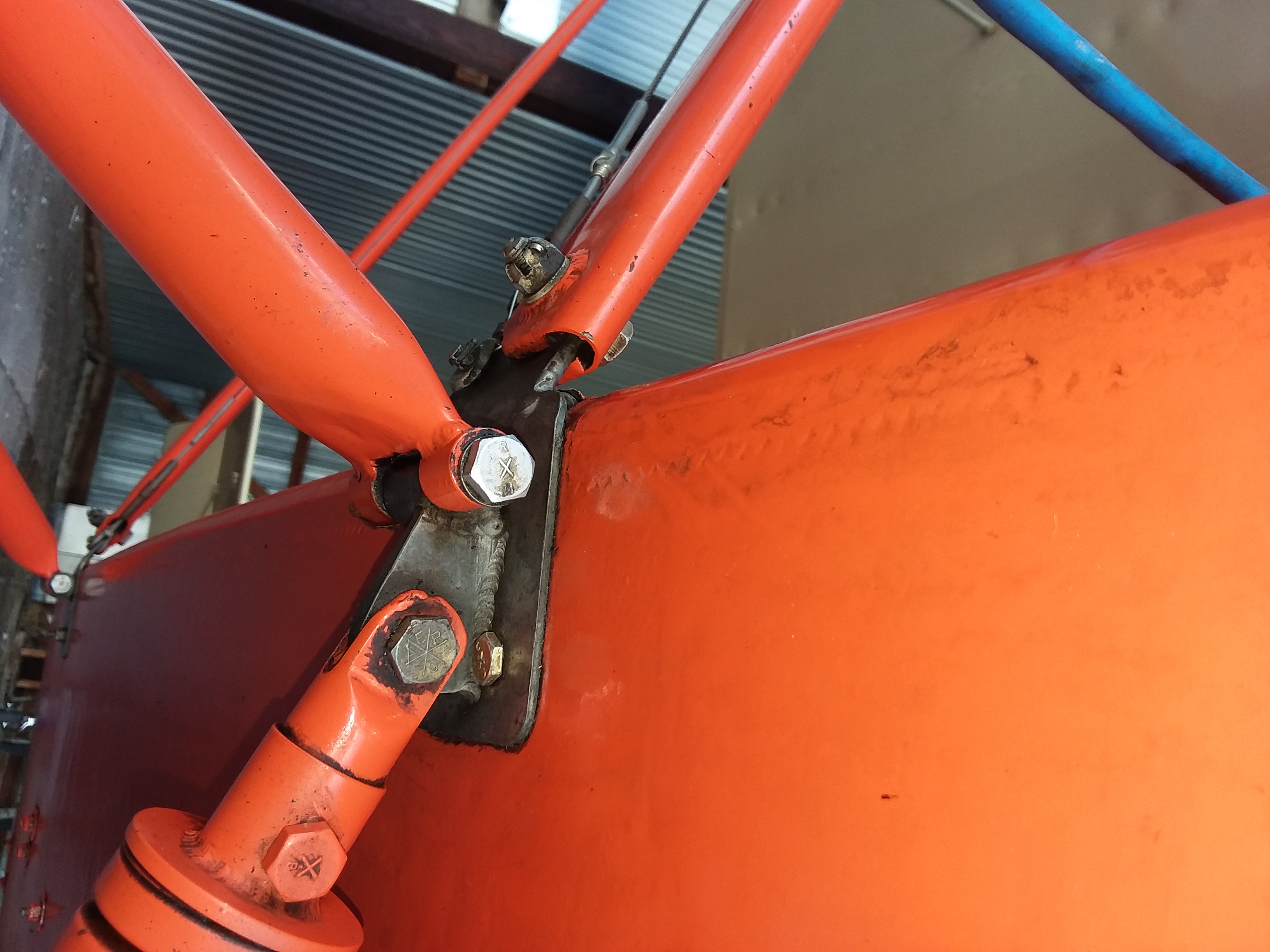

The plans mention "flatten" the end of the tube where it will attach to the lug that's attached to the fuselage. I can't imagine how I'll be able to flatten the end, or how it'll spread out to be 2.5" long to fit at the lug.
My plan is to cut a slit into the tube and weld in a 2.5" wide 1/4" piece of 4130. That''ll give a good weld surface area for the two lugs and eliminate my problem of flattening the end. I'm just not sure how long that piece should be; 4"? 6"? The tube will end maybe an inch or so from the lug.
Like the photo I attached.
Ideas? Thanks.

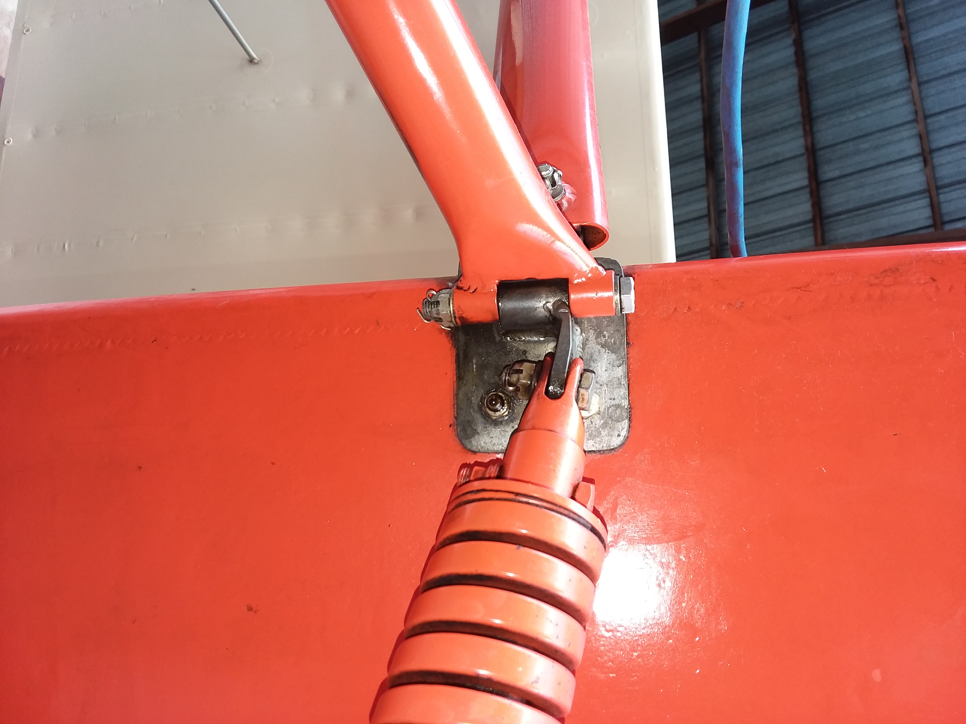

John,
The picture is my landing gear assembly. I'll be happy to measure and post the dimensions of the insert.
It may be a day or two before I can make it to the hangar.
Feel free to send me a PM. We can set up a facetime phone call from the hangar to let you see any aspects of the gear that you want to have measured.

KenBickers wrote: Wed Mar 16, 2022 9:46 am John,

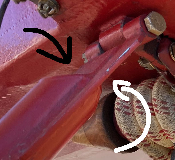

On N34KP Ken heated the tubes and then squeezed them between aluminum blocks (with nice large radius) screwed to vise jaws. He told me there was a strip of wood set to the proper angle attached to the vise to eyeball the tube angle to. I don't know how many attempts it took. He squeezed the tubes and then cut the slots in afterwards.

Richard Roller wrote: Wed Mar 16, 2022 11:57 am On N34KP Ken heated the tubes and then squeezed them between aluminum blocks (with nice large radius) screwed to vise jaws. He told me there was a strip of wood set to the proper angle attached to the vise to eyeball the tube angle to. I don't know how many attempts it took. He squeezed the tubes and then cut the slots in afterwards.20201128_135954.jpg20201128_140000.jpg
Thank you for explaining how it was done and the photos!
