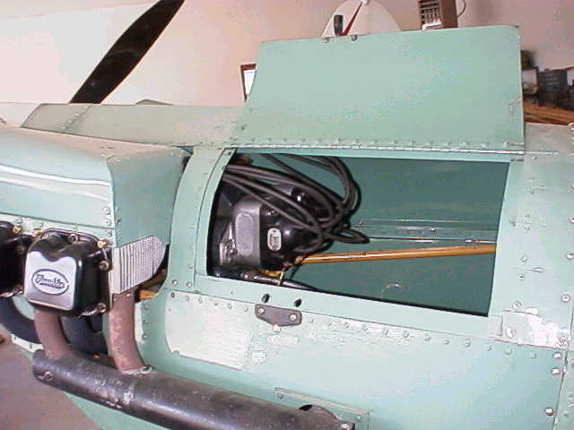

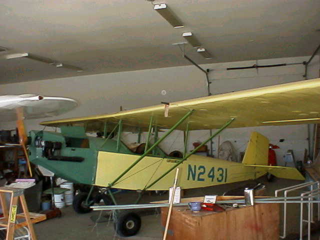

The first Piet (well, GN-1 actually) that I ever saw, touched, and sat in was Ernie Moreno's N2431 with Franklin 4AC-176-B2 engine. Very long nose (26" long engine mount), 803 lbs empty but that includes a 40 lb lead weight up in the nose somewhere to make up for the light engine.
The plane has two fuel tanks, one up in the wing centersection and the other up behind the firewall over the passenger's seat. That tank really needs to have fuel in it to keep the CG within range.
