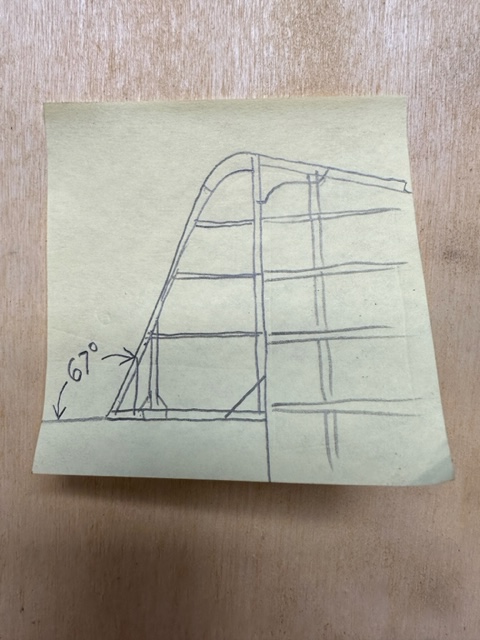

I just kind of guestimated mine by the drawings.
I went and took a measurement of it. Turns out it's just a smidge shy of 67 degrees.
That's pretty close to your guestimate.
See post-it below as to whether or not we're talking about the same angle.

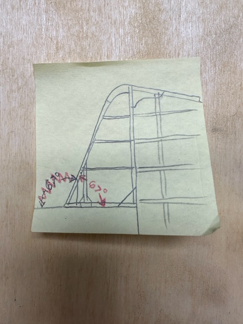

Mine has fabric on it and measuring from the leading edge to the base is 68 degrees. I'm sure you know that's the inside angle. The diagram that shows 67 degrees has the arrows on the outside which would actually be 113 degrees. Good luck with your project.
Posts: 95
Re: Vertical Stabilizer Leading Edge Angle?
Good point J.K.!
My apologies for being obtuse.
See corrected post-it below.

Thank you for the replies! Very much appreciate the feedback. Yes, I am talking about the inside angle referenced on the post it note referenced by danoliver. Looks like somewhere between 67 and 70 degrees is in the ball park, so I'm happy with that. It also confirms the process I am using to interpolate missing information based on the measurements that are given for other dimensions on the plans.
