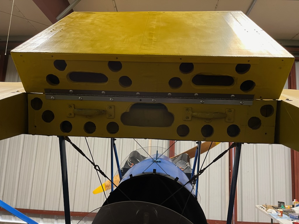

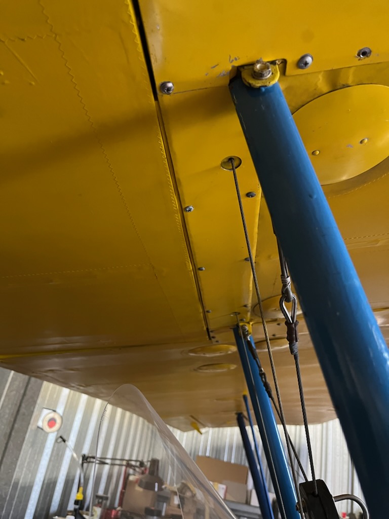

Chuck; a couple of photos of the setup on my plane are attached. It's just as you describe, with a false spar aft of the centersection aft spar, and mine has numerous openings in it for access to the aileron connecting cable that crosses through the space between the aft spar and the false spar. I fabricated a removable link between the port and starboard ends of the connecting cable and in the past it's proven very handy when removing the wings. A turnbuckle can be used in place of the link that I used but they're more trouble and fuss than my setup, which has clevis pins with very simple cotter pins at each end. I've also included a shot from under the wing, showing how that cavity can also be accessed from below.
Note that since the flop itself is entirely aft of the rear spar, it can be made wider than the centersection on the port side to make it easier for the pilot's head to clear, but mine is just the standard width... same as the centersection.
