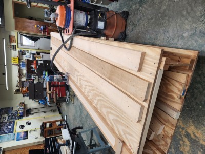

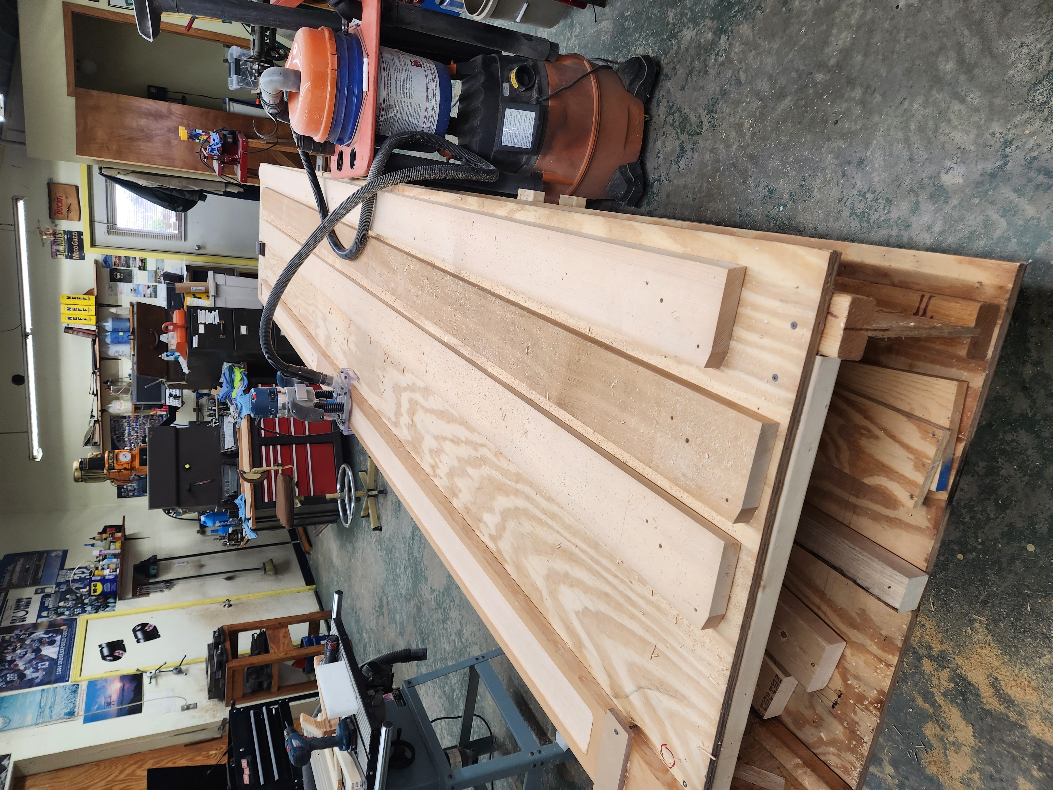

Thanks, Ken. I'm not a woodworker, and the only router I have is a little trim router. It was making wooga wooga noises just as I finished the last pocket. I've been surfing the net looking for a bigger one for the main spars. :D

Couldn't put it off any longer and started gluing.. :?
