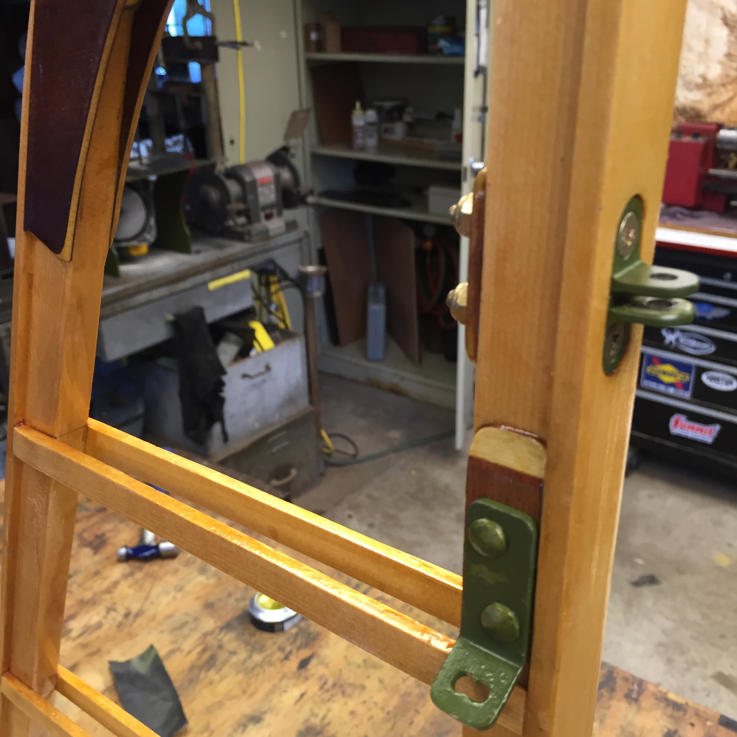

Re: Rudder Hinge Bolts instead of screws?
I used #8 MS screws and nuts.
Seems to be working out so far.

Blueflyer
Posts: 18
Joined: Sun Aug 20, 2023 8:02 am
Post by Blueflyer »
my goodness, right there in front of me, thank you! 8-32 it is.

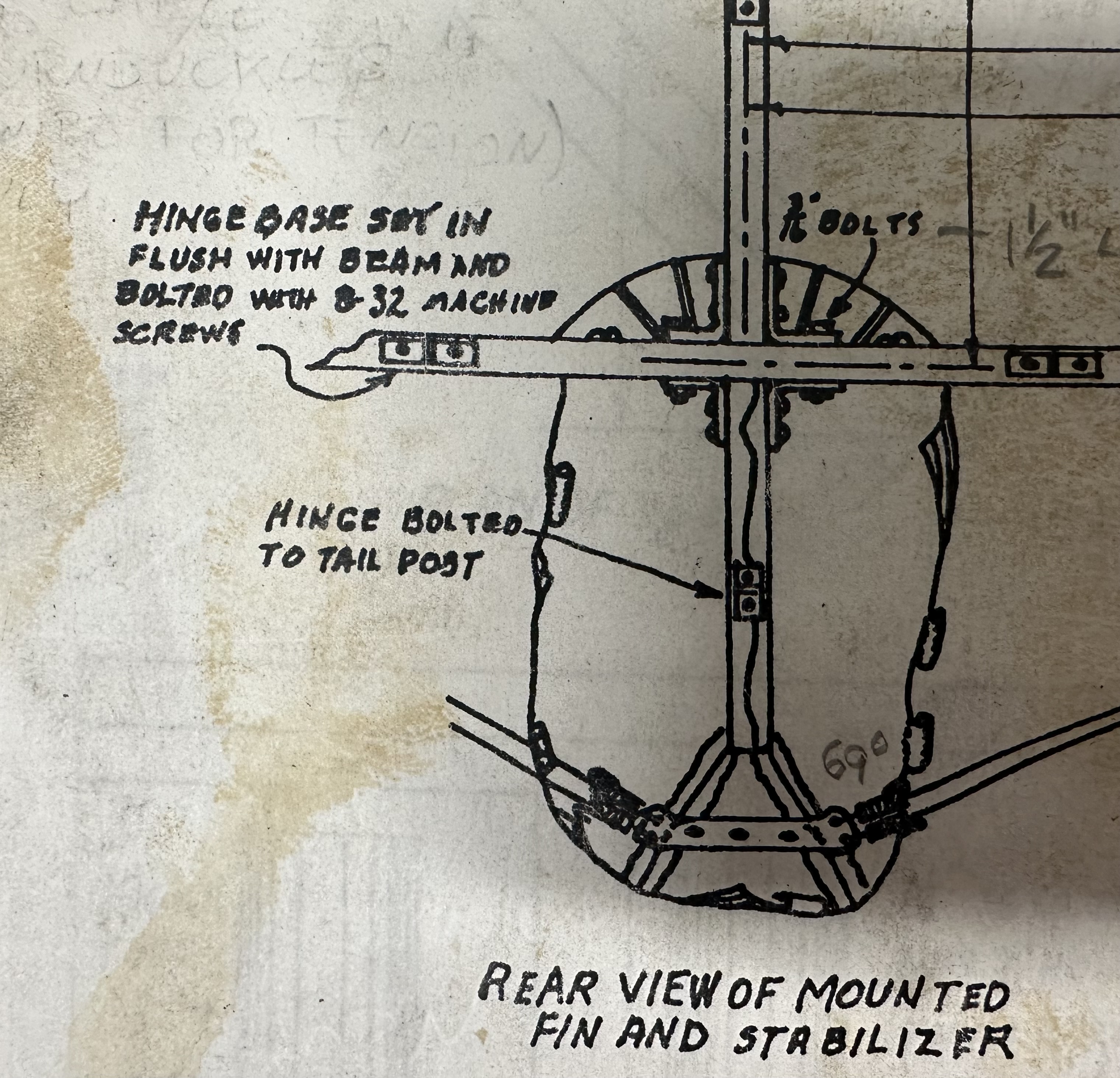

Posts: 176
Just for additional information, here's how the GN1 has the hinges (eyebolts).
GN-1 Tail.pdf
(95.51 KiB) Downloaded 822 times
