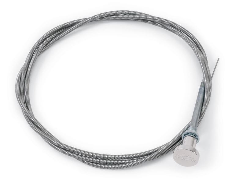

Semih; it really depends on what you're looking for. If you want an actual aviation panel-mount throttle cable, you'll have to buy a longer one and cut it to the required length. We have a multitude of similar Bowden-style cables available to us here in the US, with a very typical one being a manual choke or throttle cable such as are available through automotive supply or tractor supply places. This one, from Summit Racing, is about $15 and is 72" long, nothing fancy but it will work.
