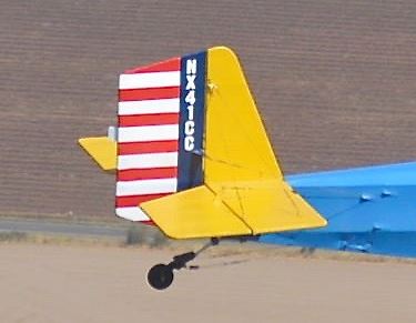

Bob; although I won't say that my Air Camper now flies "feet off" in level cruise, it's a lot closer than it was before I adjusted the engine thrust offset and put a bit of offset in the vertical stabilizer. I would have put in a bit more offset to the VS to get things perfect, but the aft spar of the VS is fixed in place and I didn't like the feel of twisting the leading edge over while the trailing edge remained fixed. I had hoped that my tweaks would allow me to remove the bent-metal trim tab on the trailing edge of the rudder, but that was not to be after test flights showed that it still yawed a bit without it. As it is now, I've managed to get it where it won't yaw noticeably in cruise for maybe 15-20 seconds when I take my feet off. Before I made the adjustments, the nose would start to swing the second I took my feet off the rudder bar.
You can see my metal trim tab on the rudder, here-

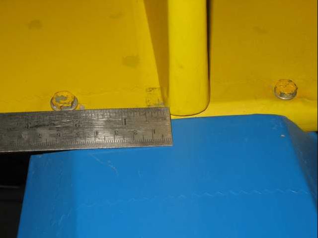

My VS is offset about 5/8"- I ran a rod through all the rudder hinges and rotated the VS around the hinges, then made my fittings to fit.
that way there is no added stress on the main beam of the VS from twisting it to get the offset.

Mine is offset 1/2" to port but the offset would be in the opposite direction if you have a Corvair or other engine that turns in a direction opposite to Continentals and Lycomings. I honestly don't know which way a Ford (or a Jeep) turns. I have no need or desire for in-flight adjustment of rudder trim but I could use a little more vertical stabilizer offset for my plane to fly straight in level cruise without a touch of foot on the rudder.
