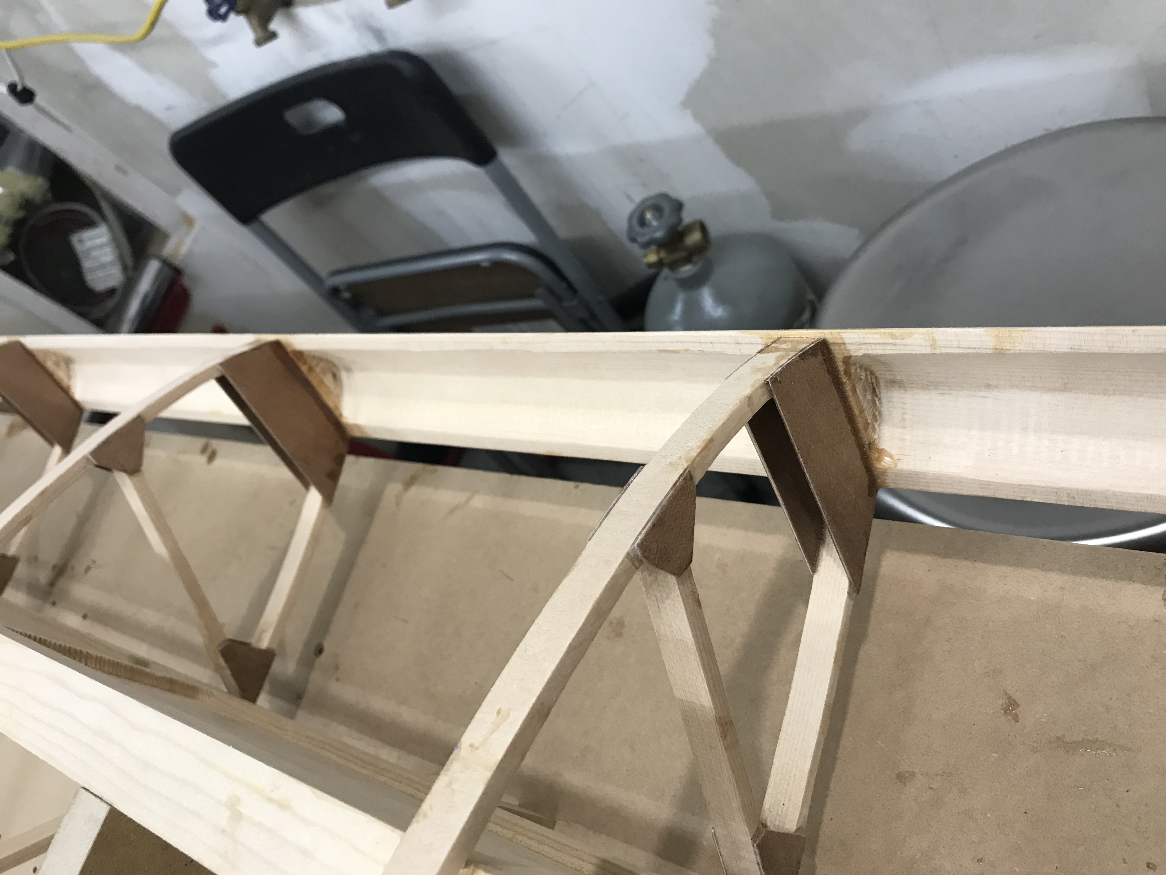

The ribs are show built of ¼ x ½ material. All the other planes I have looked at use ¼ x ¼ for this. Is there some element in the design that is compensated by these ribs needing to be twice the width? They seem to be about the same spacing as ribs of other designs. Also in regard to the longerons it shows 1’ x 1’ but it is the only plans I see calling for this. Other designs have a maximum of ¾” x ¾”, even if they have two seats. The manual says the ship is robust and built for hard use. Perhaps in 1932 there were no airports and it was intended to land in rough conditions.
Can an aircamper used on a good grass surface be built as most other planes of modern design with ¾” x ¾” longerons. Especially if the ship weighs only 550 pounds and maybe a pilot and passenger not much over 300 pounds total? Add some gas and good measure and say maximum landing weight ever of 1000 pounds.

Also I see there has been some discussion about reducing the rib width from 1/2" to 3/8" (still wider than even the Pitts uses which much heavier wing loading) but has anyone ever actually done that. One thing I don't see in the Piet wing is the number of compression members that are seen in other designs. The Piet seems to have fewer so maybe the much heavier than typical ribs are handling this compression load.

Another thing to consider is that the Pitts employs the NACA M6 airfoil and has a 36" chord. The M6 is a 12% airfoil so that makes the depth of the wing ribs about equal to that of the Piet airfoil (12% of 36" = 4.32" for the Pitts) but the Piet airfoil is about an 8% (4-3/4" deep spars and a 60" chord = 7.9%) so it's much flatter and the rib caps must resist bending over a longer span. As I say, there are a lot of different factors to consider if you want to start reducing the cross-section or aspect ratio of structural members.

Yes that's a good point that the rib is longer and thinner.

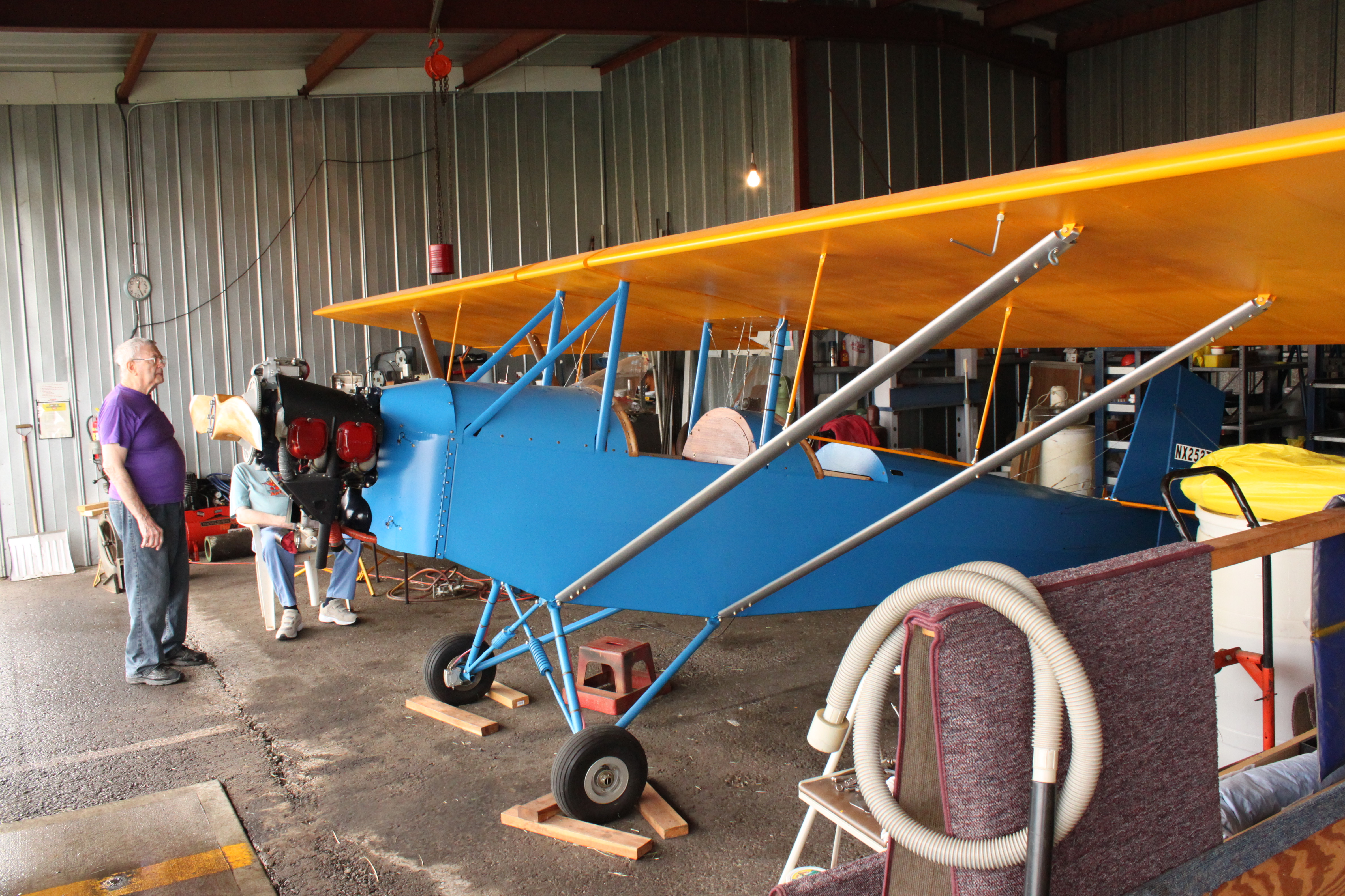

His Piet is built to the plans with a steel tube fuselage, Cleveland 6:00 x 6 wheels and brakes, Vi Kapler three piece wing, die spring shock struts on the landing gear, A-65 engine with a Lycoming starter ring and starter per Bill Rewey.
His is the lightest Piet I'm personally aware of. Empty weight as described, with oil, unusable fuel is 592 lbs. A very light Piet. I'm not sure a 550 lb. Piet is possible built remotely to the plans.
Anyone else have any weights they can share with this thread?

That is encouraging!
I don't have any idea how the steel fuselage compares to the wooden one. Any input?
Also I don't know what landing gear is lighter, the "old wooden style" vs the style pictured. Input?
Also I don't know what instruments/radio he is equipped with but probably more than no radio and an airspeed indicator and oil pressure gauge as I would install so I'd guess that is several pounds available if he is compliant with FAR 91.205

I routed out material from the wing leading edge. I suspect you could route out some material from the aileron spars too. You could also eliminate the front cockpit controls. Wing tanks are a little heavier than cockpit tanks for the same volume since they are shallow whereas the cockpit tanks are closer to a cube also they require shorter fuel lines.If you could find some way to make a rotational molded plastic tank that would probably be the lightest. I saw someone who eliminated some of the turnbuckles by tensioning the wire rope before crimping the sleeves.
It's pretty common not to use nails on any of the gussets since they are just there to hold things in place while the glue sets up.

ArtherD- where did you route out material on the leading edge?
Re: Actual Empty Weight of Pietenpol
This is a riblett airfoil so the leading edge is larger than the normal pietenpol airfoil.
- Posts: 345
Ken Perkins did the same thing to the leading edge of his wing. His has the Pietenpol airfoil.

I saw a video series where a builder fabricated rounded rib nose pieces that he attached to each rib and then wrapped the leading edge with plywood vs. creating the leading edge with a board. Seemed easy and light without sacrificing strength. Thoughts?
