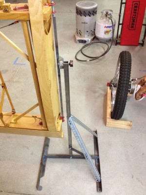

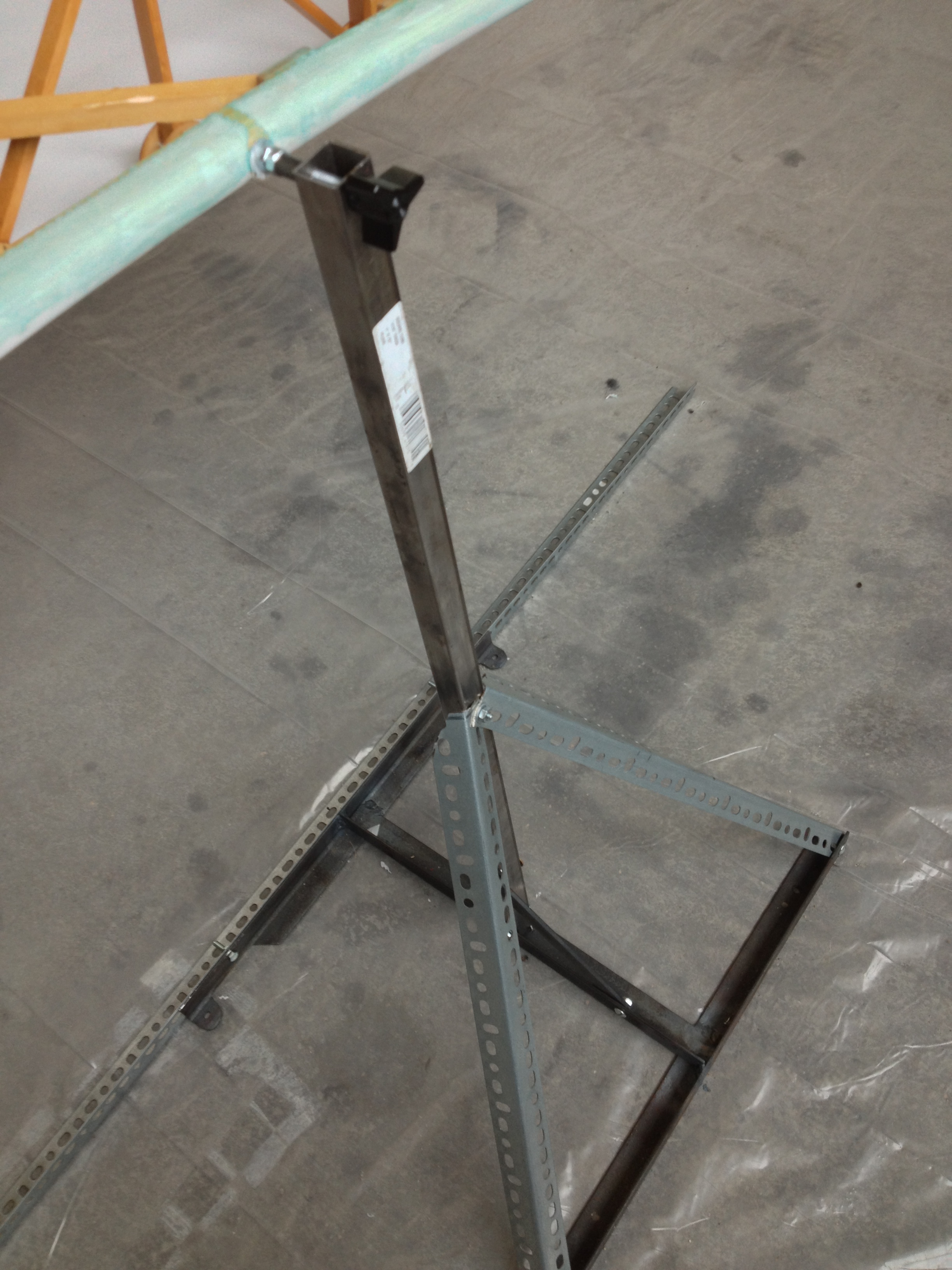

Dave, here (I hope) are a couple of pics of the rotisserie that I used when covering and painting my wings. I can dig up more pics, if desired. Cheers, Ken

Re: Wing Rotisserie
Ken that is perfect!!!
Thank you!!!
