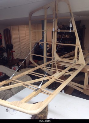

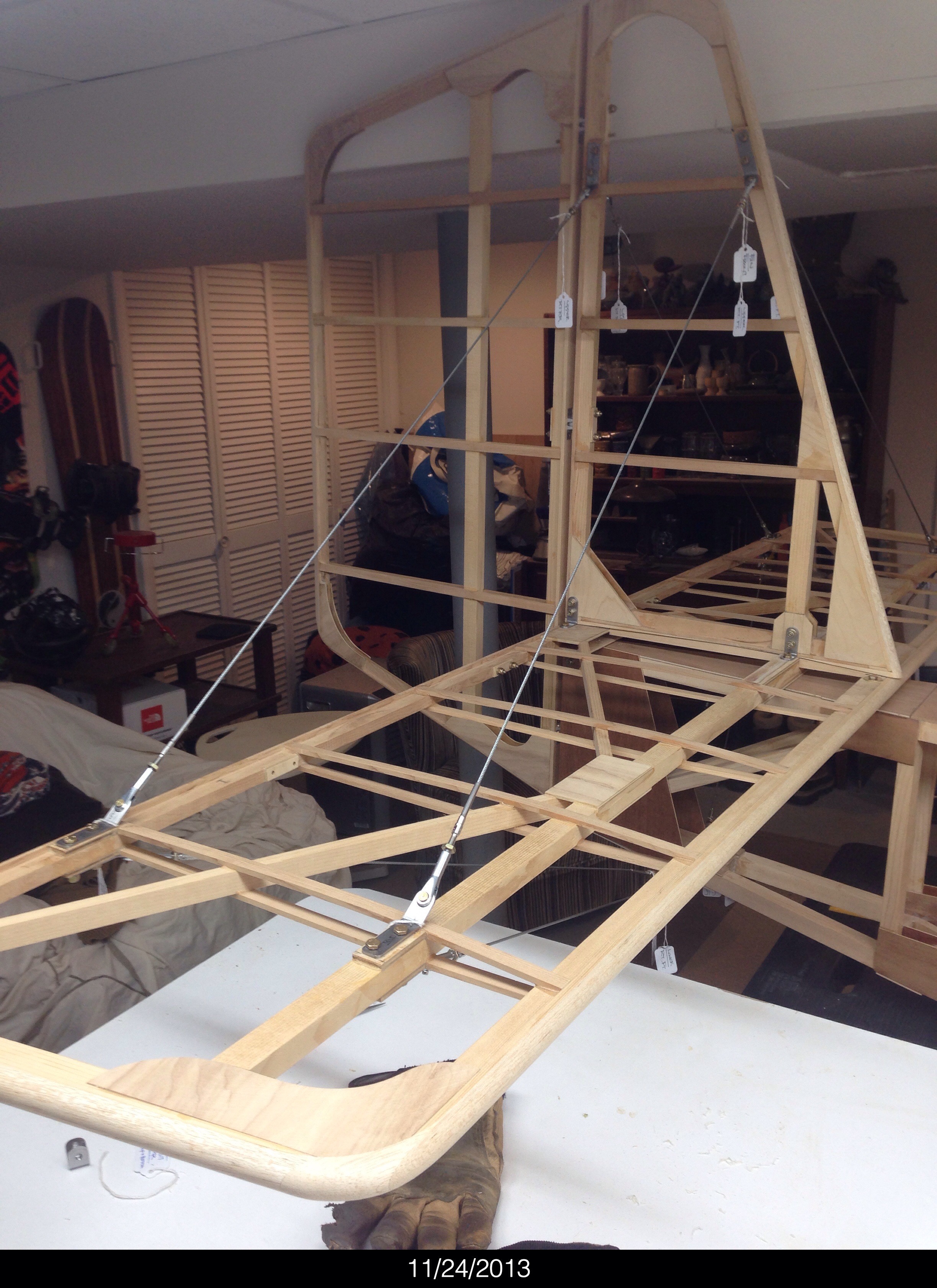

See, this is where my usual mental logic has broken down. It sounds like the desire to keep the tail light pushes towards making all the fittings out of the 13 ga material. I look at the tail brace anchor straps and see a difference in the metal gauges with no explanation given, and I tend to make all of them out of the slightly *heavier* gauge metal... 12 ga. There could be endless discussion about why Mr. Pietenpol may have used different gauges for the brackets and there isn't any need to try to analyze that.
Re: Control Horns
Oh yeah, and I forgot to say why I was thinking that way. The vertical stabilizer brace wire brackets each take the load of two wires, while the horizontal stabilizer brace wires only take the load of one apiece.

Guess I should also mention that I separated the wires at the fin, moving one to the leading edge.
Re: Control Horns
Ah. Now I see. Earl, you may want to tweak the angle of the leading edge of your vertical stabilizer after you test-fly the aircraft. Mine is cranked over a little bit to help reduce some of the yaw that I was experiencing even after adding a rudder trim tab and shifting the nose of the engine over a bit by shimming at the engine mounts. If you do that, those two cables will need to be re-made if there are no turnbuckles or other length adjustments available. Not a big deal.

My fin is already offset- opposite of your of course!
