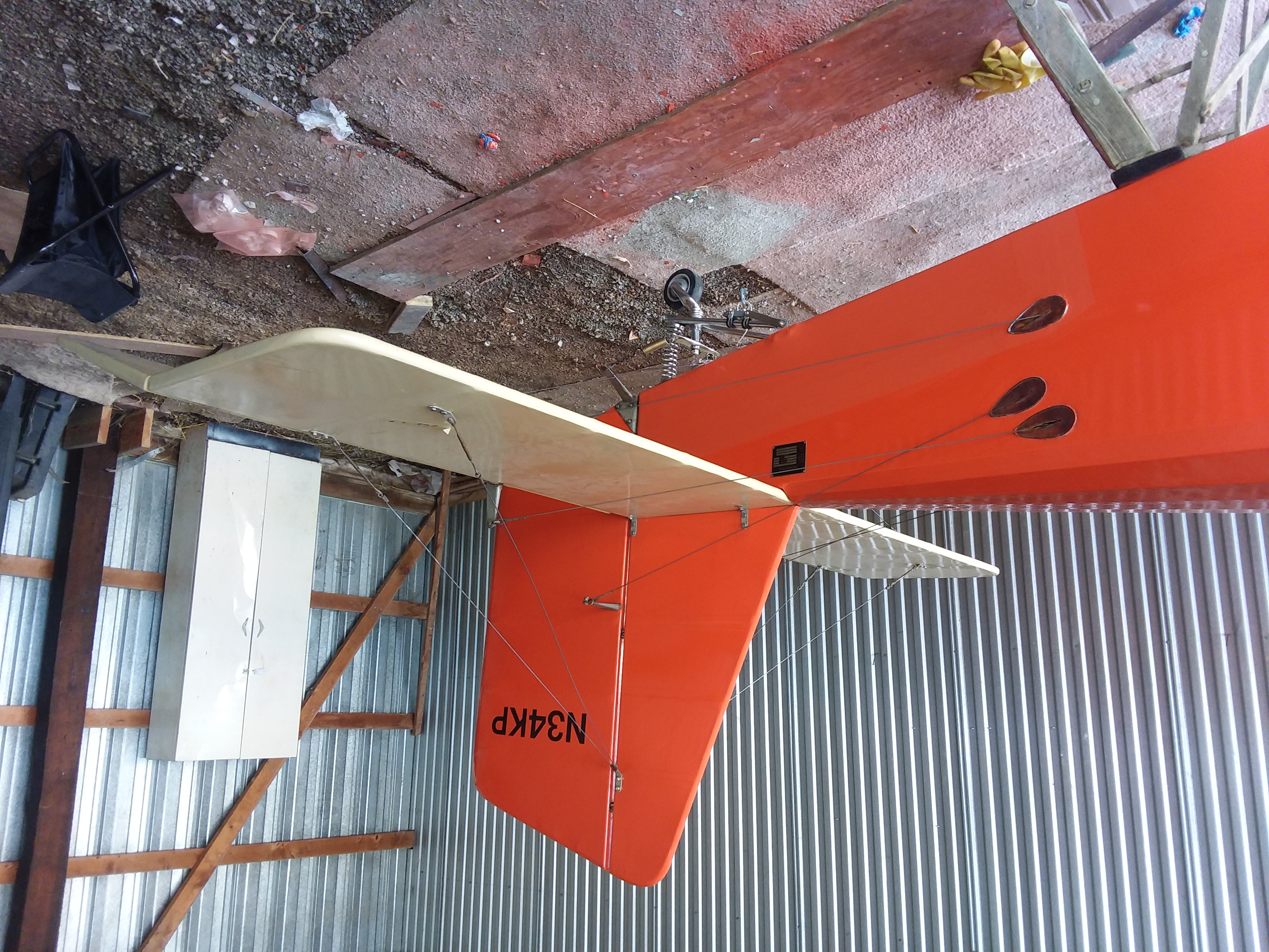

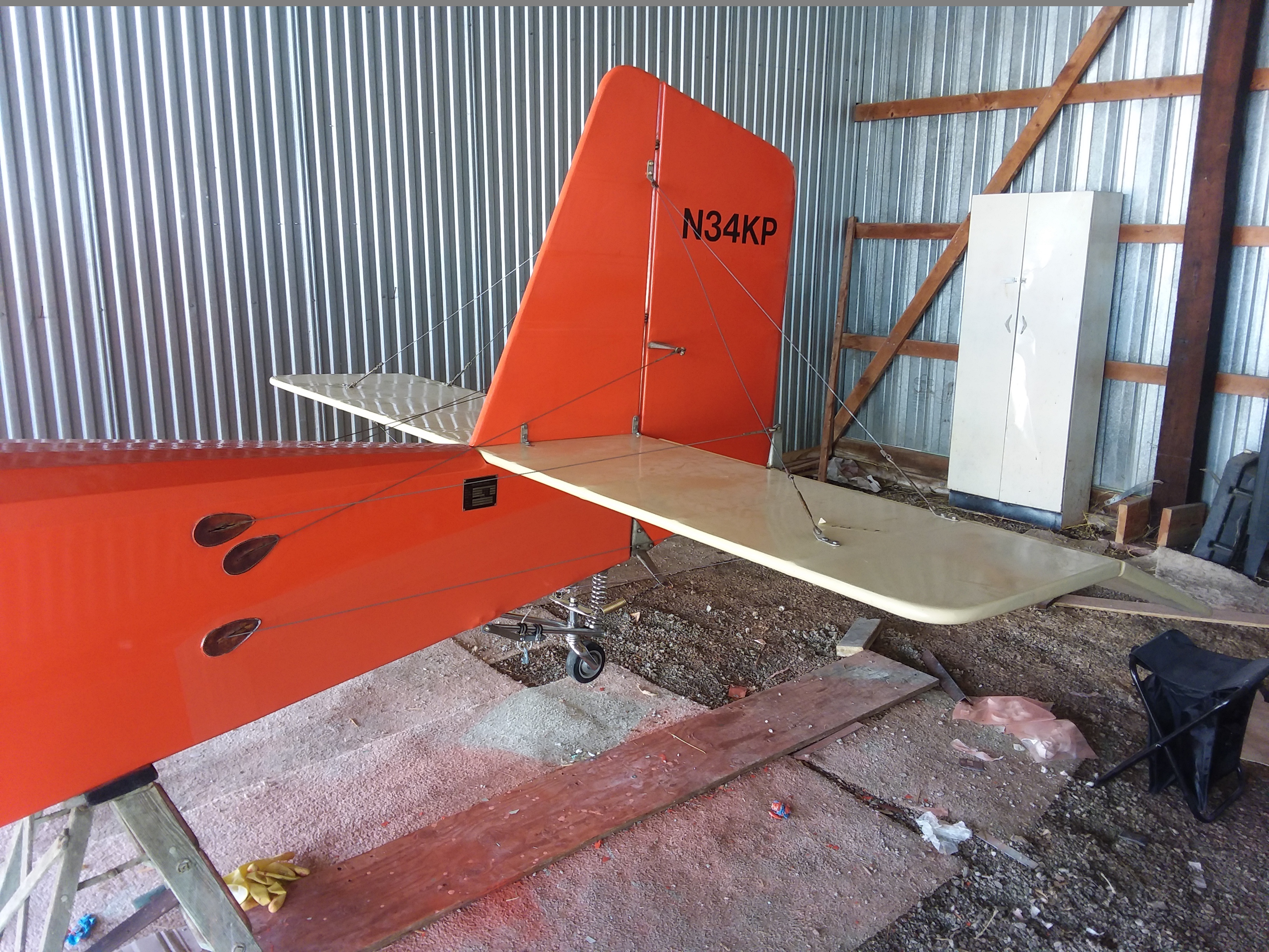

Not everyone may know, but last year on the way to Brodhead for the fly in N34KP, Ken Perkins Piet, was damaged. The tail wheel assembly was torn out of the left longeron. The repair is completed now and it ran for the first time since last July yesterday. I started the condition inspection today. A few little things have showed up that need taken care off, but the airplane is in good shape.
I did my first fabric work since 1977 with this repair. Things have changed! I thought it turned out pretty good, though the paint shade is off a little. In either case, next time everyone sees it, don't be to critical!
N34KP should be back in the air soon.
I don't know why, but when I post photo's, they end up upside down.

Fixed the pics.

At the cross bar, there’s a red adel clamp holding a cable attached to a mysterious gizmo.
Pray tell, what is the function of this device?

Tow hook re-purposed as a releasable tail holder-downer.
If you are storing paint long term for touch-up down the road flip the can every few months.
Paint in the can often won't match up anyway because of UV degradation in the paint that's on the plane.
