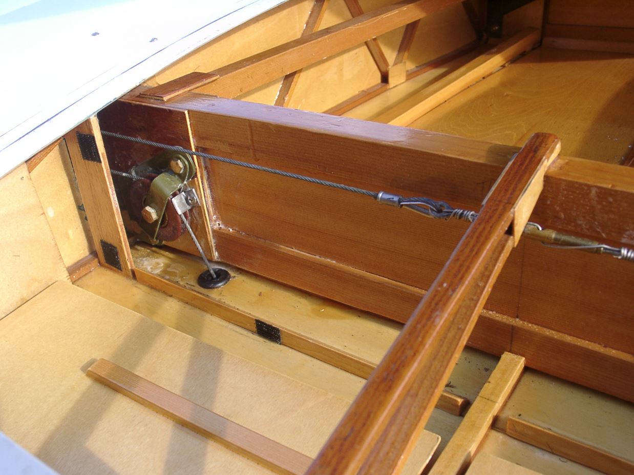

The third cable is the crossover that connects the port and starboard ailerons to make them work in unison, one up and one down. That crossover cable must have a disconnecting link in it somewhere along its run, and that's in the centersection of the wing. Mine is accessible when I lift the "flop" section that I flip up and out of the way to get into the cockpit easier, but not all Air Campers have that flop. Some have a cutout in the aft part of the centersection, while others may provide access to the crossover by opening a removable cover on top of the centersection. The aileron cross-connect has to be separated and I'm 99% certain that you'll find a removable link or coupling somewhere in there. If you can view pictures, here's a picture of how it is inside Mike Cuy's Piet, with a turnbuckle on the cross-connect to tension it properly.
