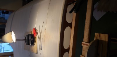

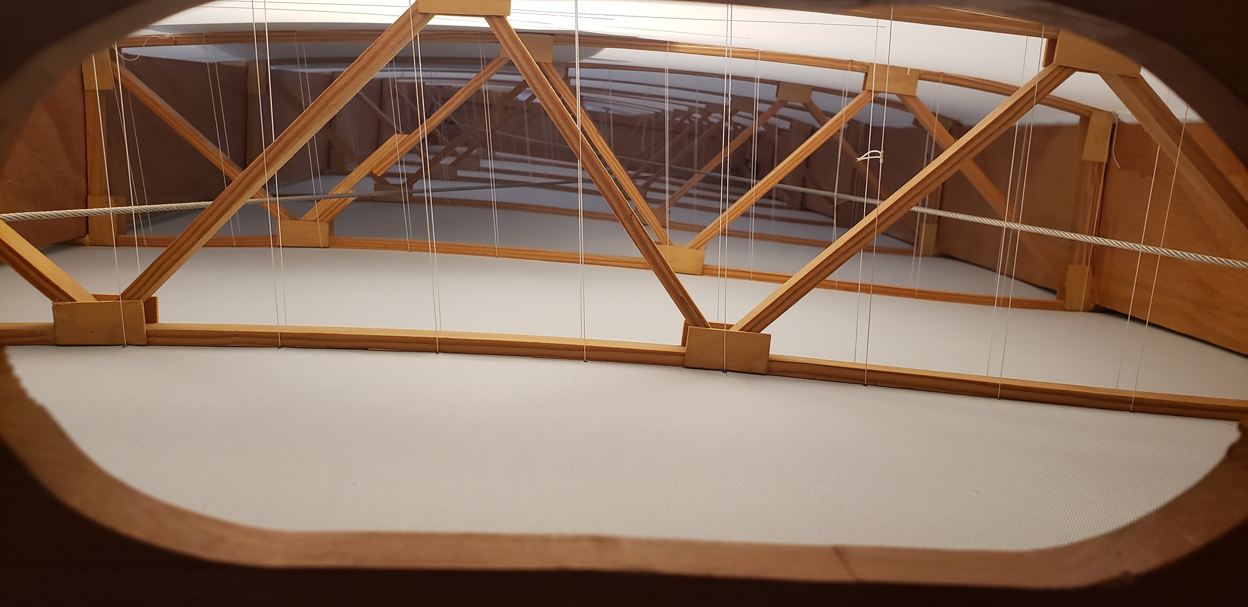

Last stitch on the first wing done
r1200gsDave
Posts: 65
Location: Monroe, WI USA
Post by r1200gsDave »
Wow am I happy to report this! 186 stitches complete. Now time for the picked tape.
Tomorrow....
Have a great day folks.
Re: Last stitch on the first wing done
Looks great! I did exactly the same with a few intercostals in my wing panels to give the cross-brace cables clearance. Cheers, Ken
Posts: 719
Did you do the little soldering iron trick where you touch the tip of a soldering pen to the fabric where each hole will go? I can't tell from the photos. The largest thing I've covered has been my vertical stabilizer when I made repairs on it, and that little trick made it much easier to hit the holes with the needle.
r1200gsDave
Posts: 65
No I haven't heard about the soldering iron trick till just now.
Posts: 719
Melting tiny holes in the fabric where each stitch enters and exits makes it much easier to hit the right spot with the needle, and it's easier to push through. Your tapes cover the stitching and the holes anyway. Worth experimenting with, if you haven't tried it.
The trick I learned was to punch the holes with a pencil. That leaves a darkened ring around the holes that is easy to see. When the tapes are applied, the pencil lead that surrounded each hole is no longer visible. Cheers, Ken
Posts: 719
Ken: that's even easier, yes!
