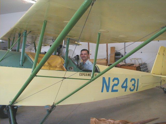

Now, see-? THIS is the value of these groups! Meet other builders and pilots, ask questions, share ideas, "harvest" tips and tricks from others, and network/connect. Although I had been flying for 30 years when this happened, I never gave the Air Camper a thought until the day I met Ernie Moreno and visited his hangar. There it was! And I got to sit in it! And it was love at first sight! This was 20 years ago, and although my hair has gone grey and the mustache is now gone, the smile isn't!
