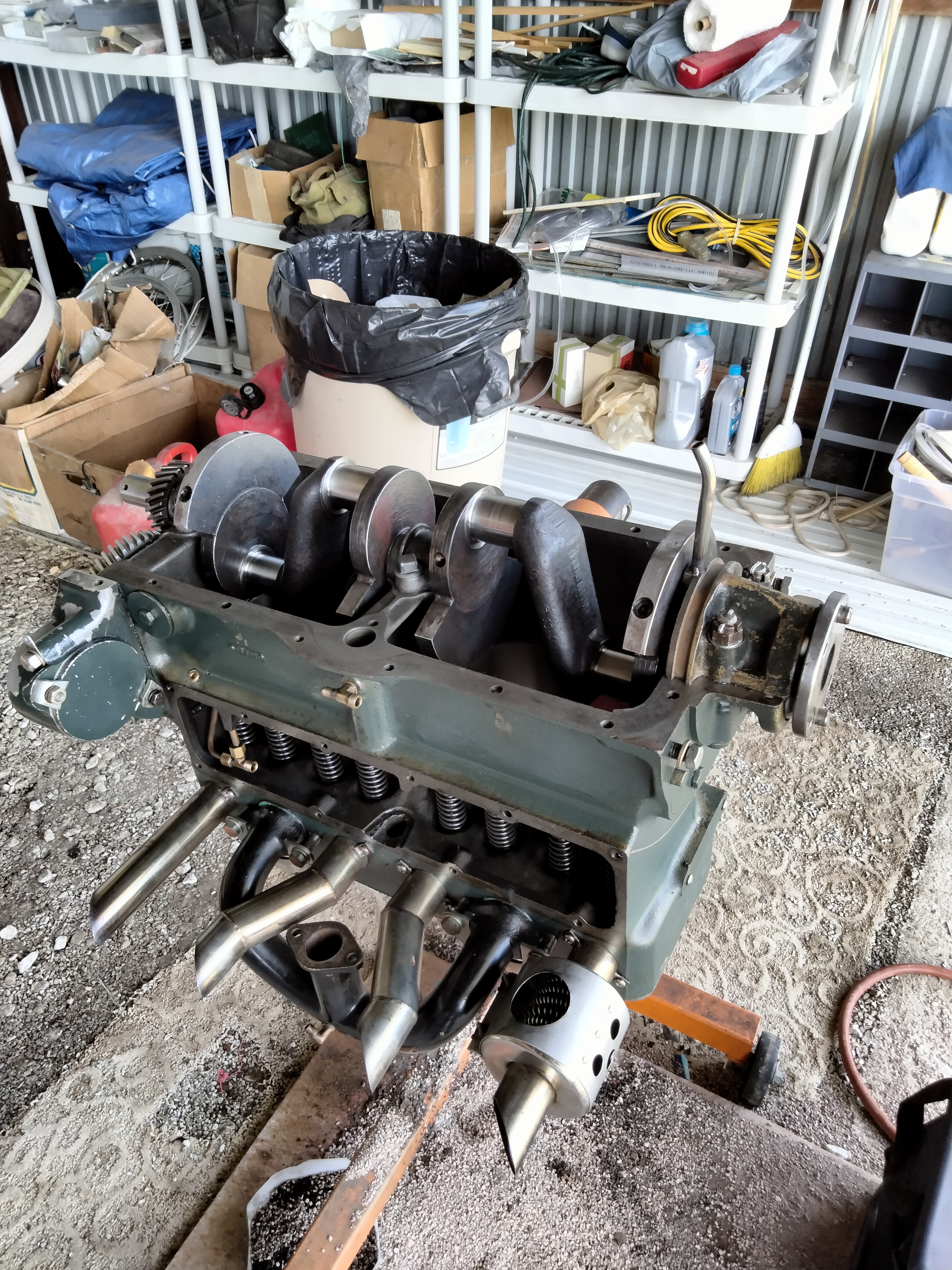

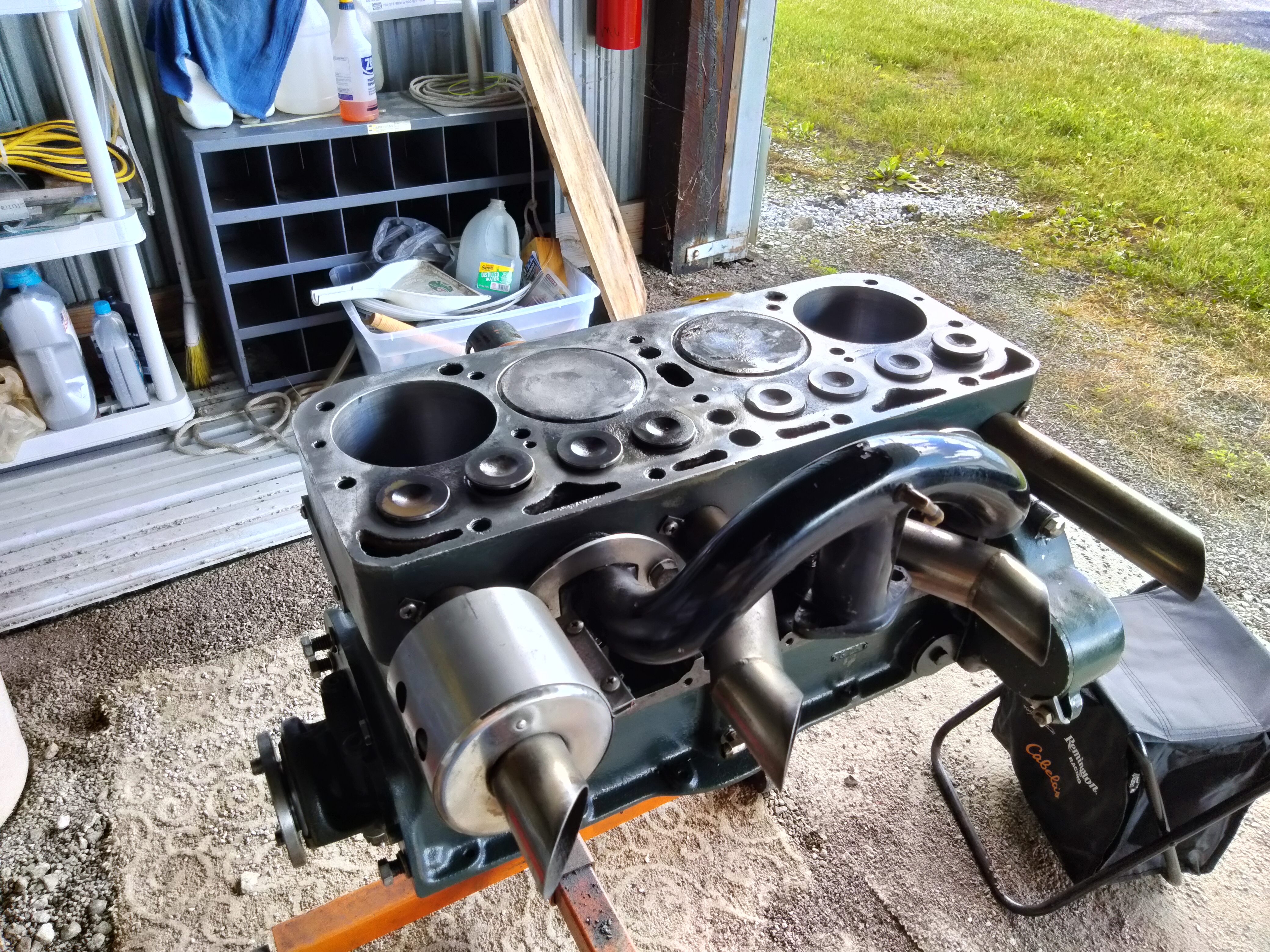

The engine for 34KP is going back together. Clearances on the crank bearings checked today. The crank is now installed and the caps torqued.
Posts: 357
Re: N34KP's engine

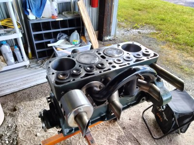

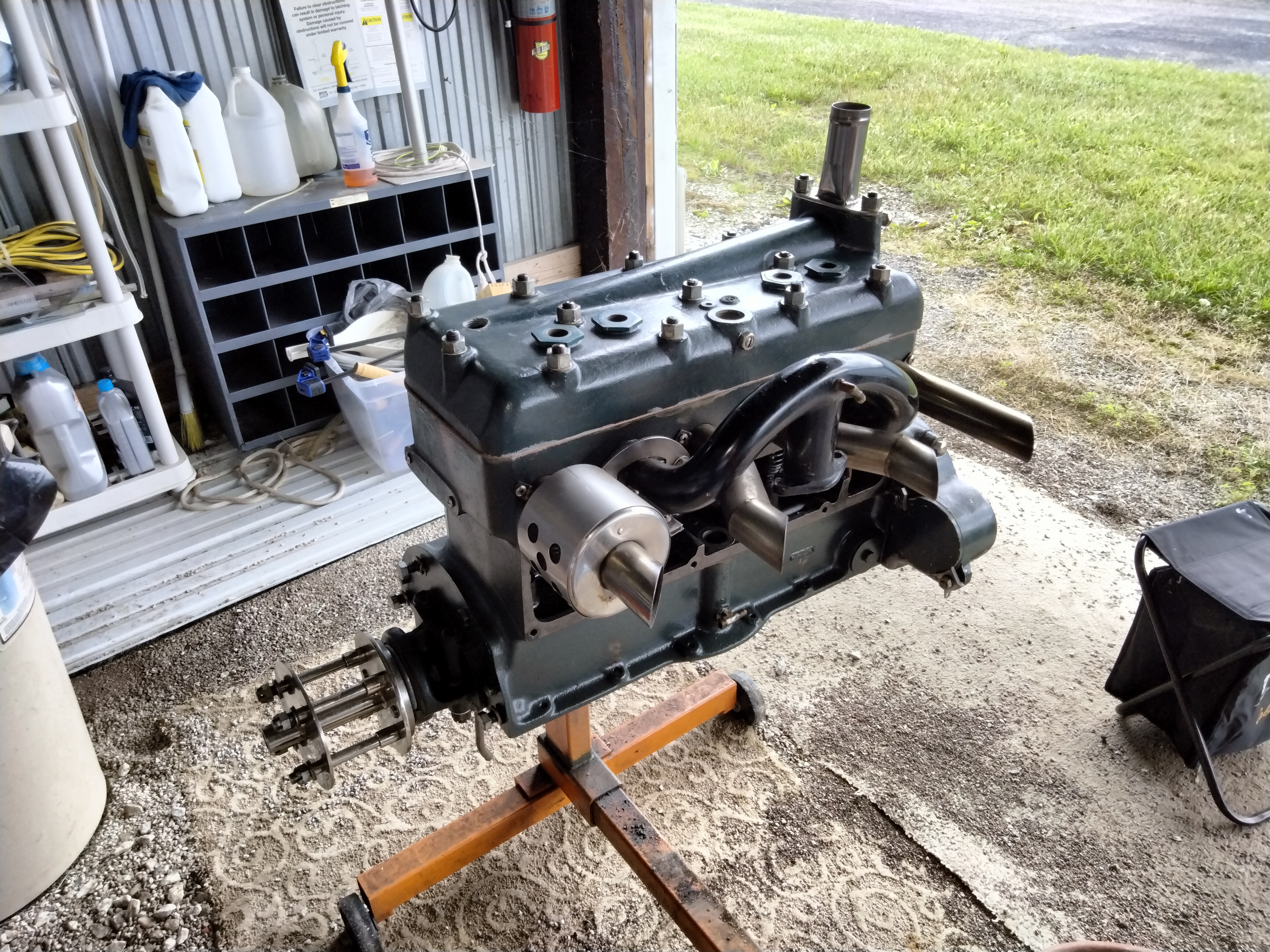

Pistons in, head on and initial round of torques completed.
Re: N34KP's engine
Nice and clean. Very pretty engine.

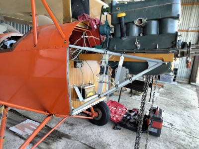

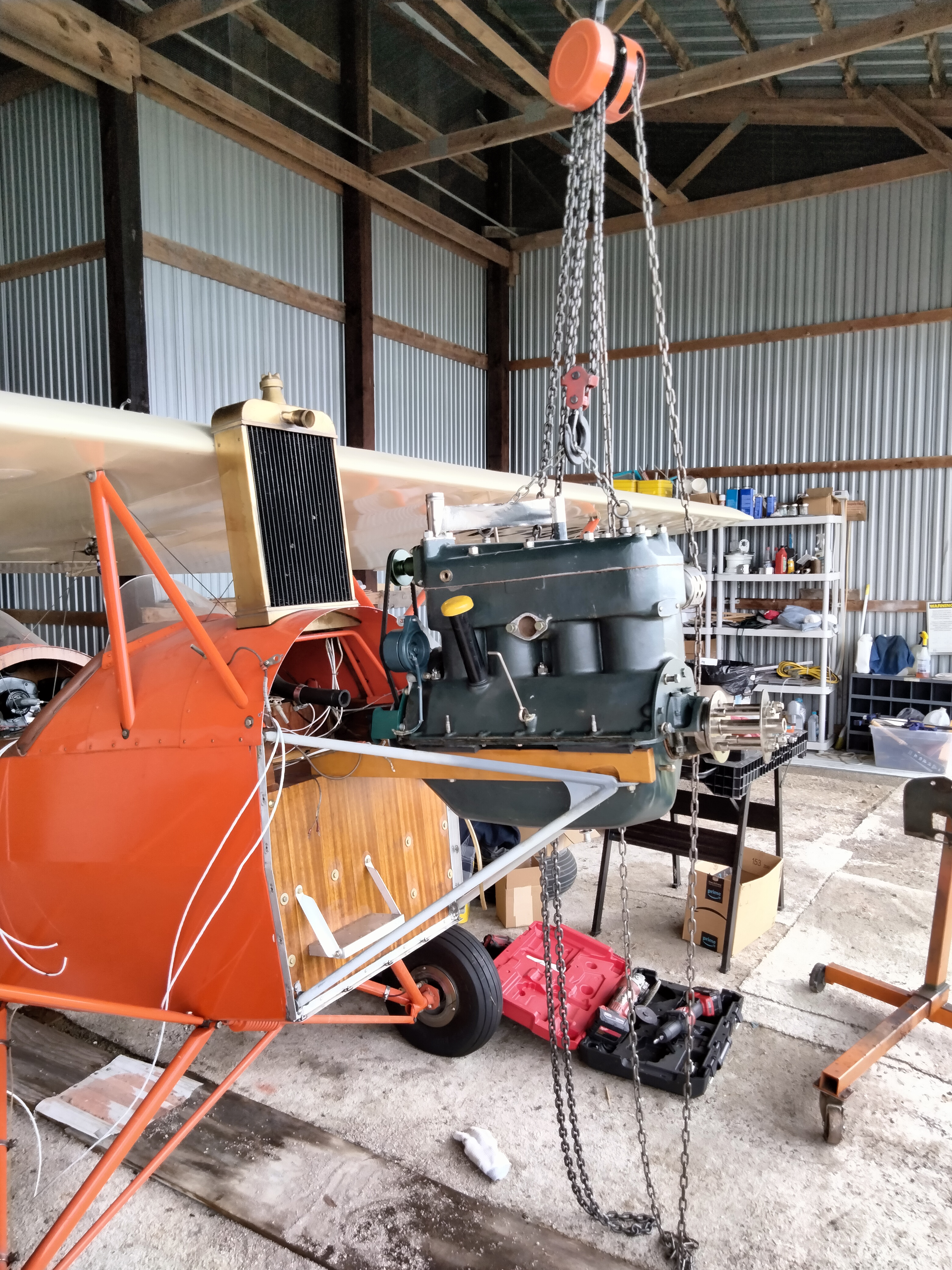

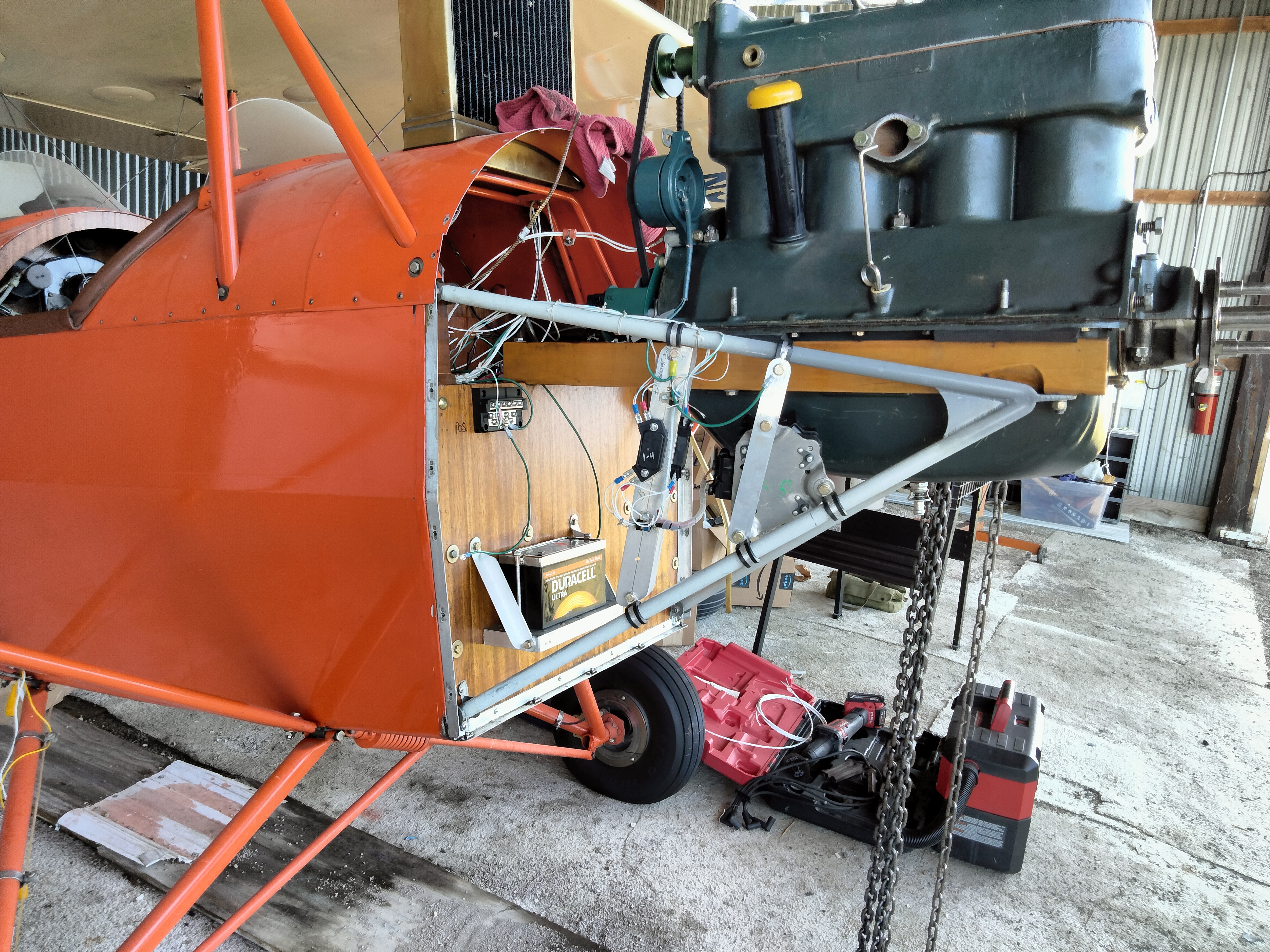

Back on the mount.
Re: N34KP's engine
A marriage made in Air Camper heaven! Nice work, Richard.

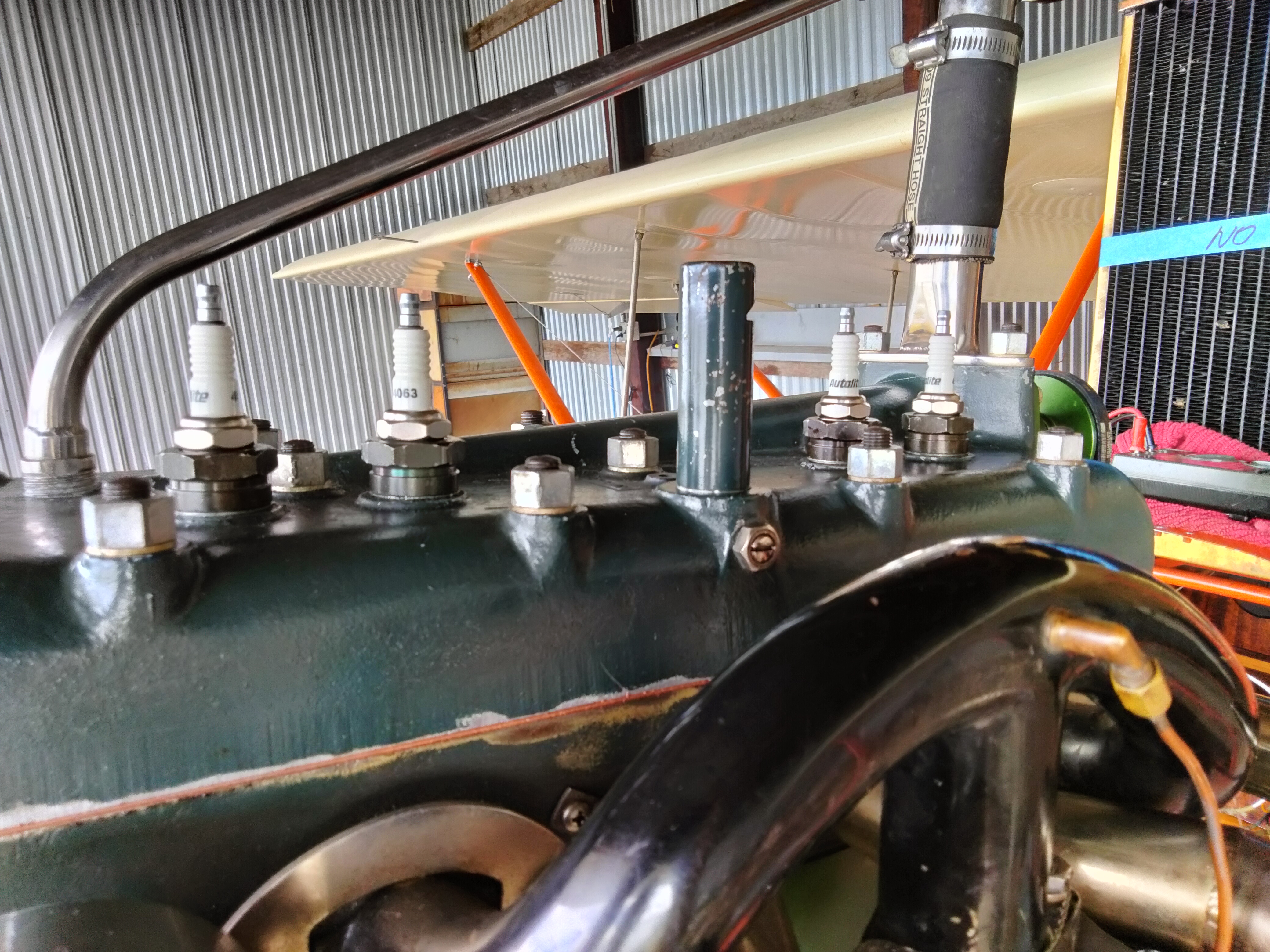

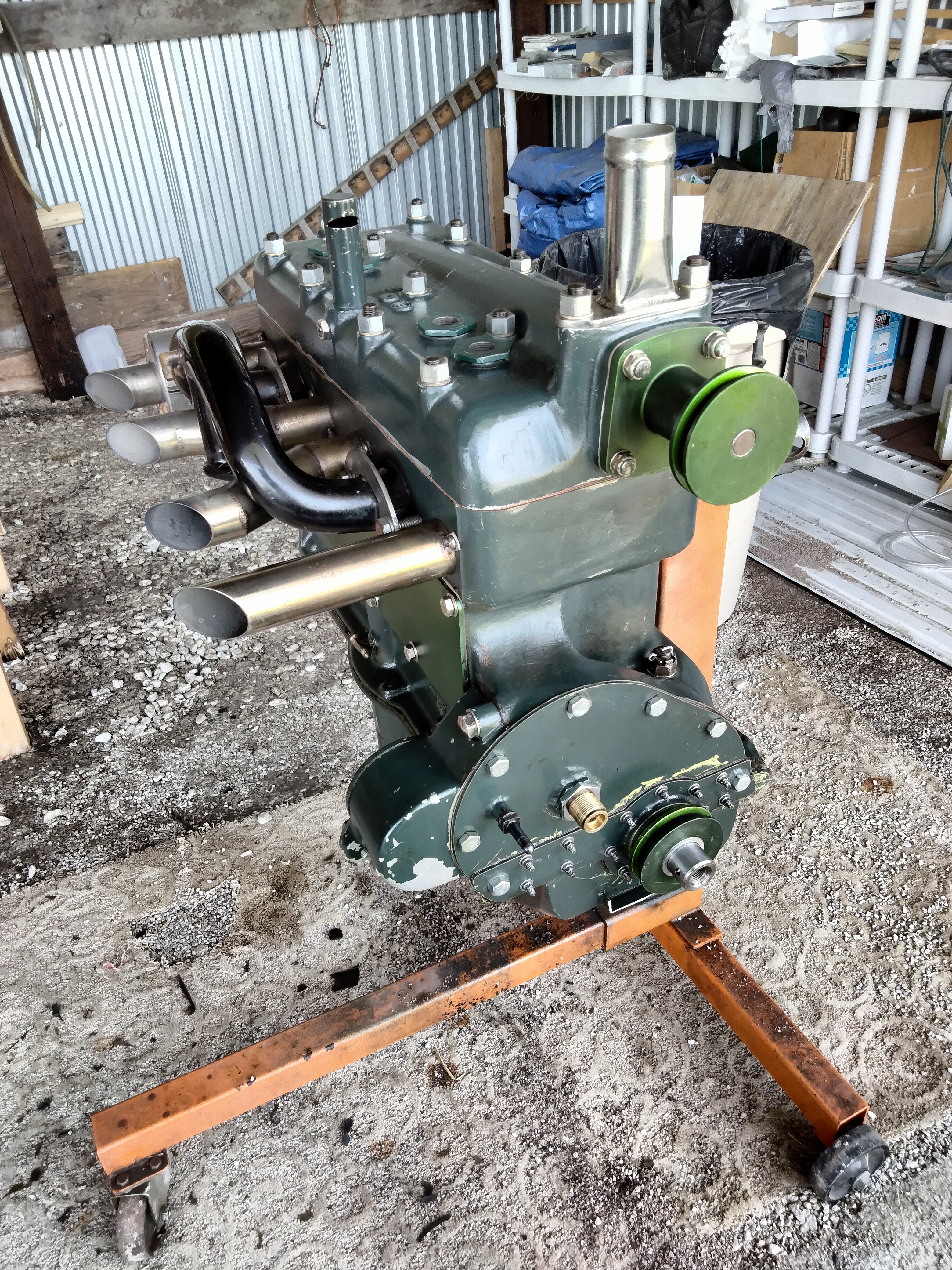

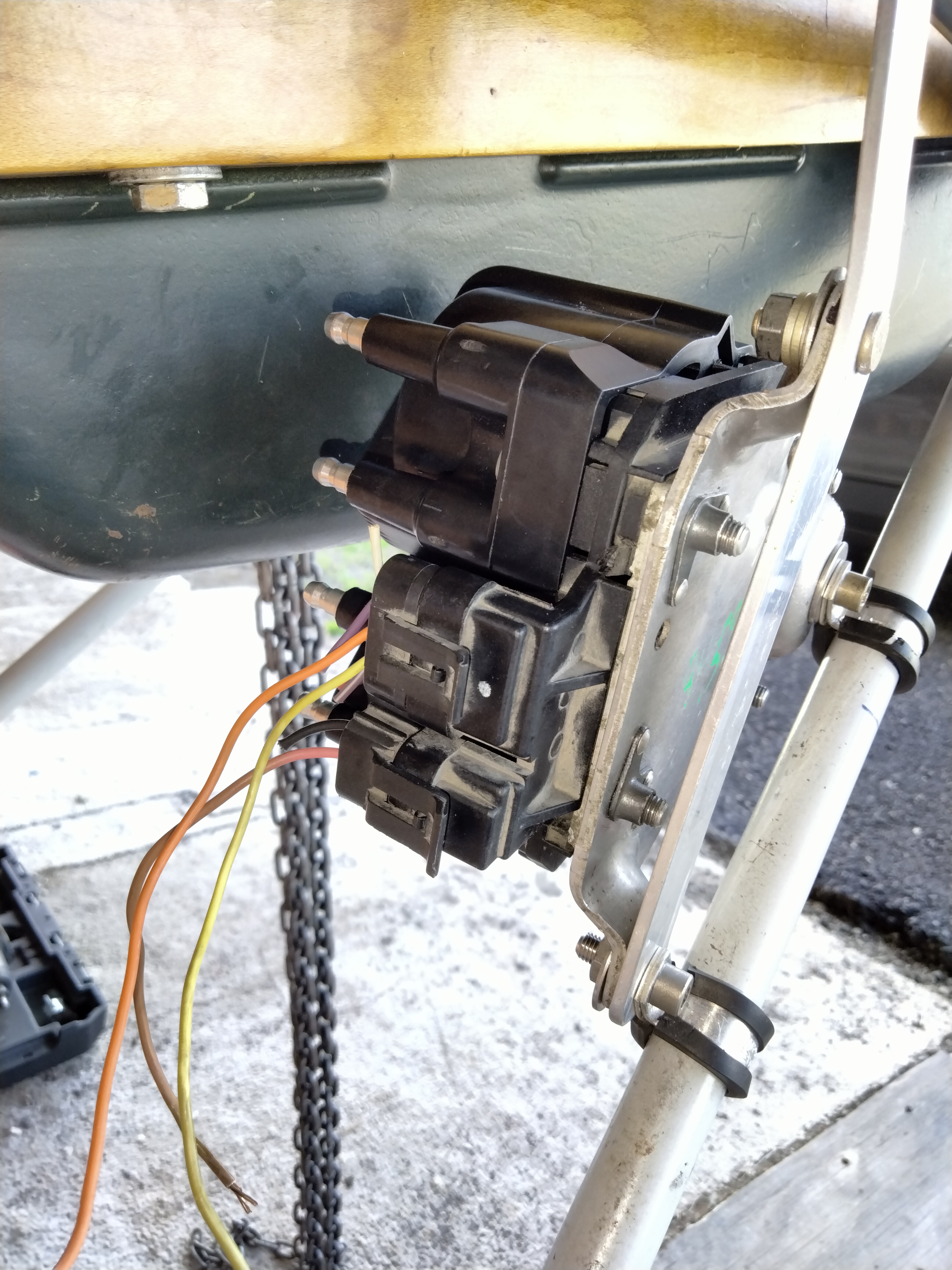

Well, the Ford ran great after I got the new ignition system figured out. Just prior to leaving for Brodhead it started shooting oil out of the seal on the prop end, so I ended up driving to Brodhead. When I returned I thought I'd try an experiment to see if I could stop the leak. My theory was the only thing to cause that much volume in the leak was a plugged drain back tube. So I thought I'd put vacuum on the block and try to suck whatever was blocking the tube out. I put 3 inches of vacuum on the engine. I could hear the air sucking back through the seal. I gave it about 20 minutes worth. I took the Piet back out for a test run. It started spewing oil out within 20 seconds. So, I pulled it back off for disassembly to see what's up.
