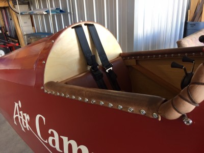

I'm thinking I'm going to try to shape some aluminum tubing (small diameter) into a shape that follows the outline of the front cockpit and fits snugly over the coaming. Then one or two fore & aft stiffening tubes with pulled rivet gussets, then an aluminum skin riveted onto the tubular frame. What I'm trying to do is make a cover that can be secured with some simple bungee cord tarp tiedowns (those loop things with a ball on one end) from inside the cockpit. Easy on, easy off. I'm going to mess around with some poster board to see if it might work.

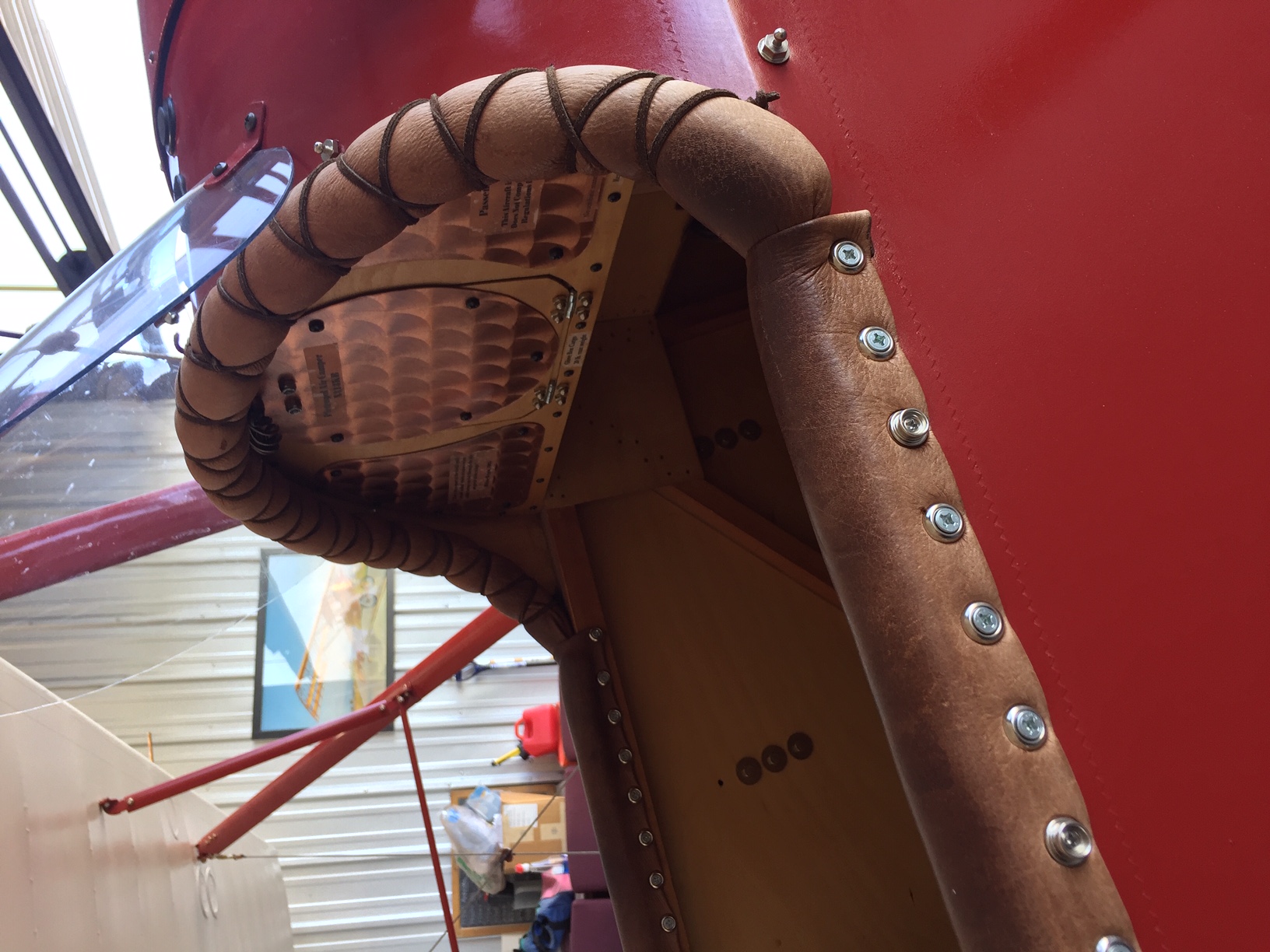

Re: cockpit covers
Oscar, Richard,

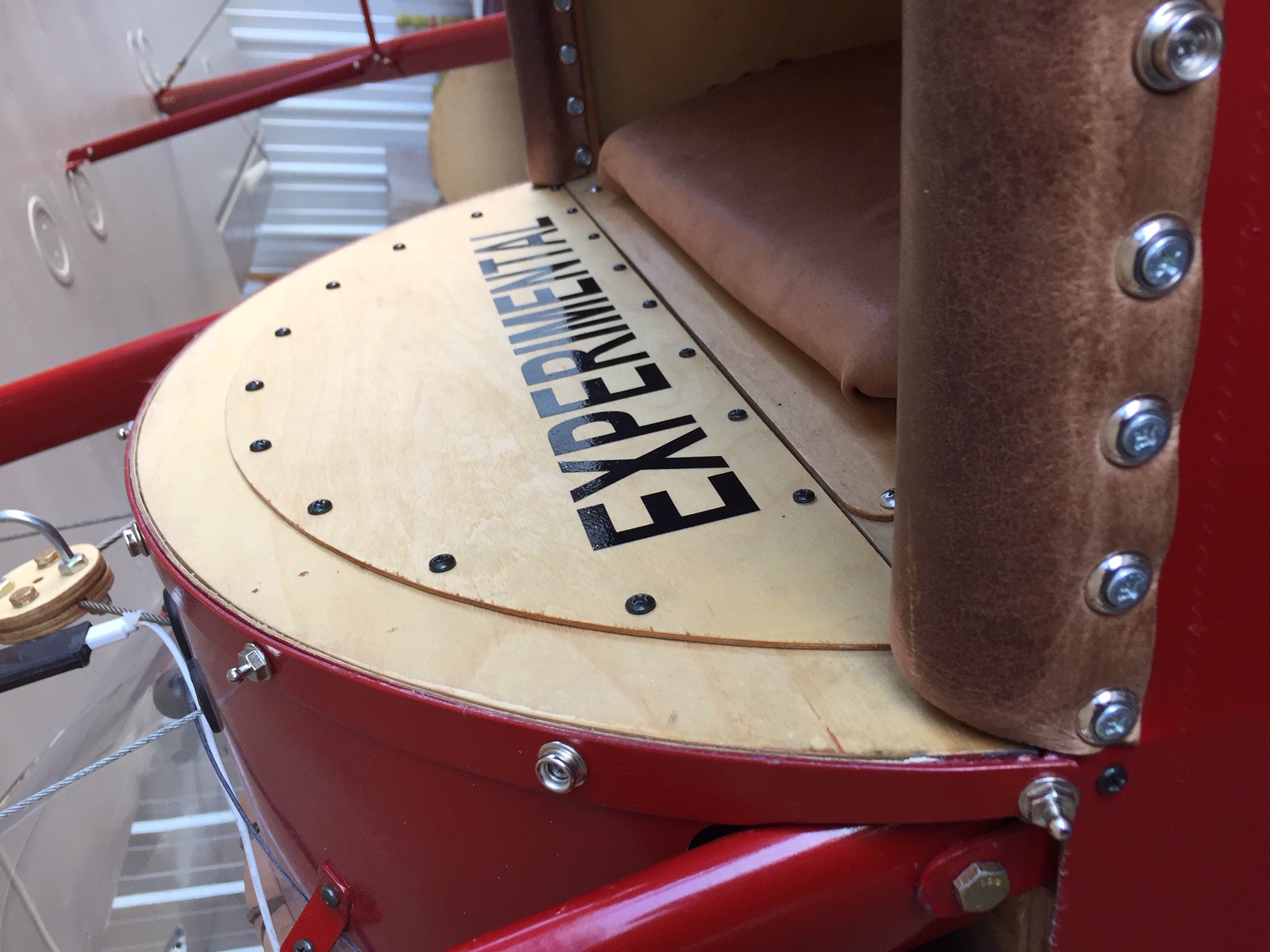

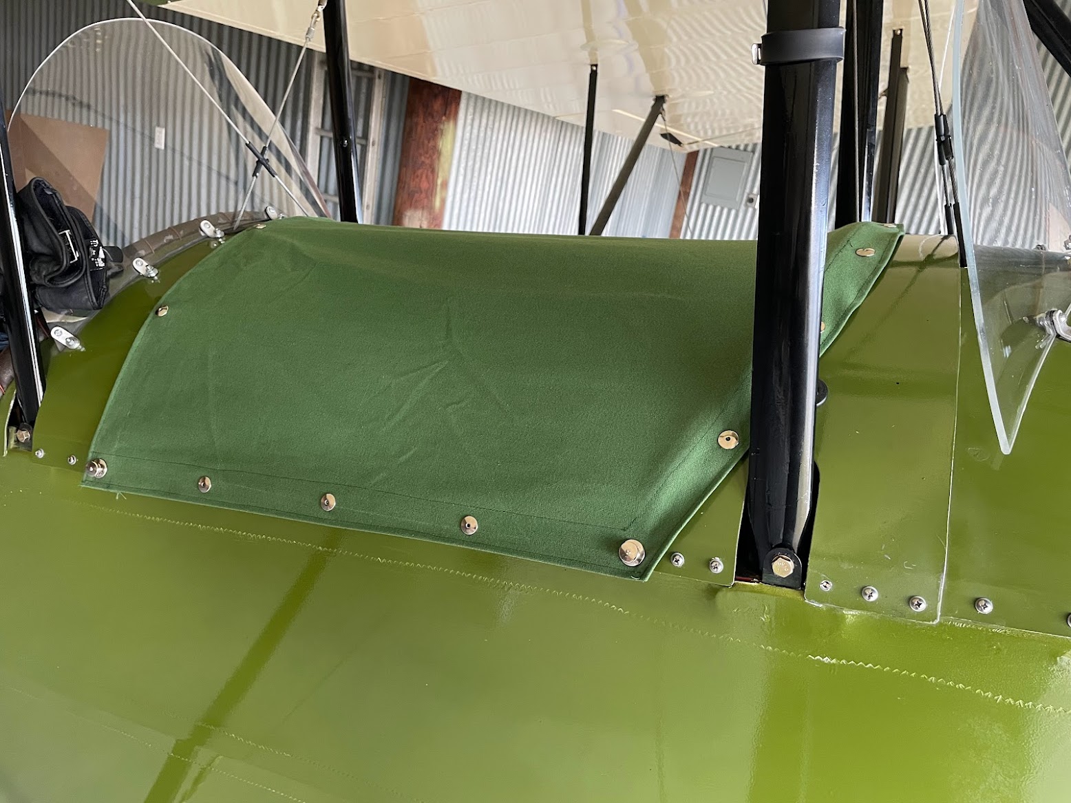

I made my covers using Sunbrella marine grade awning cloth. My seams aren't the prettiest, but they do just fine.
On the forward pit, every other fastener is the a stem and ball type that requires positively pulling on the clip to put the fastener on or take it off, with snaps for the alternating fasteners. My thinking was that snaps might come loose in flight, given all the turbulent air that beats down around the cockpits. I don't want a cockpit cover coming loose and fowling up controls or tangling in cross-brace wires.
On the rear pit, I used snaps all the way around. I only cover that pit when rain looks likely. And obviously it is never covered when in flight -- though that would be a way, I suppose, to replicate IMC conditions in a Piet
The secret to making these was a a little tiny tool sold by (I think) Sailrite. It screws temporarily into the position where the permanent fastener will be located on the fuselage. It has a little needle on the top of it. It looks a bit like a WWI German helmet of the sort in Colonel Klink's office in Hogan's Heroes. This allows the fabric to be stretched to remove wrinkles before installing the fastener into the cloth cover. Working your way around, it makes a nice clean installation. Fun, too.

Re: cockpit covers
I'm in luck. It turns out photos of the fasteners had been transfered to my computer. Meanwhile I'll look for some with the covers in place.

Oscar,
Yes, the front cover does seem to keep my feet and legs a bit warmer in flight. Also it appears that I pick up a mph or two in cruise speed when the front cover is in place based on a constant throttle setting of 2400 rpm.
Note that I have positive locking stem-and-ball fasteners across the front of the forward cockpit and the locking stem-and-ball fasteners alternating with fabric snaps on the back of that cover. On the two sides, I have only regular snaps. I don't think I would fly with it in place were it not for the locking stem-and-ball fasteners.

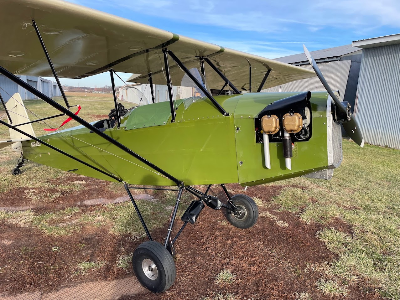

Re: cockpit covers

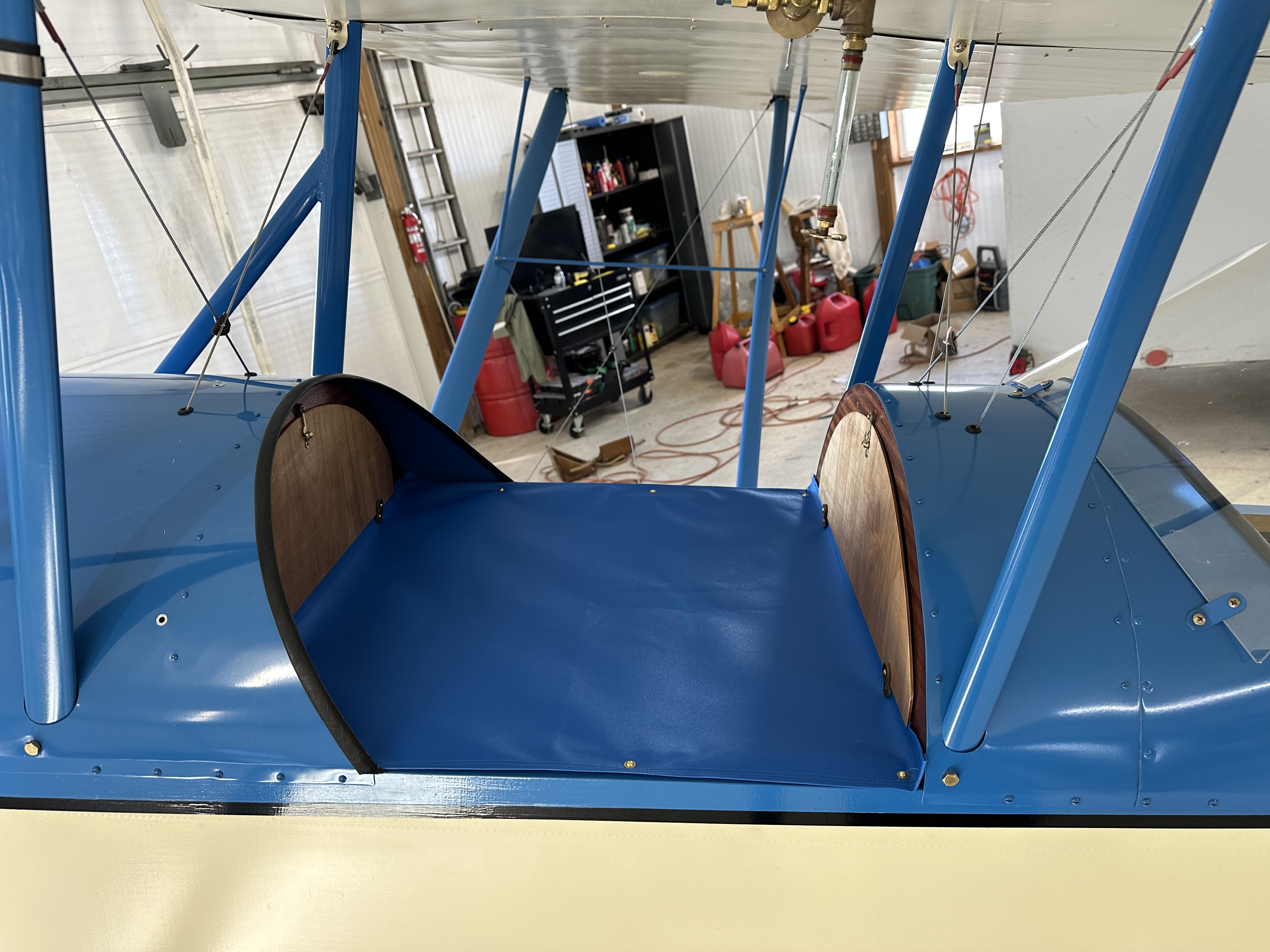

I tested this cover out today and it seems to work pretty good. It’s just screwed in place for now just to see how it does. Definitely keeps the draft out and I didn’t notice it flopping around at all. I will change to easier fasters at some point. The fabric is “Top Gun” from Joann.
Re: cockpit covers
That style of cover should ride out of the slipstream, so less buffeting and drumming than covers that follow the top curve of the fuselage. I'm going with the curved style since it should also serve to shed rain.

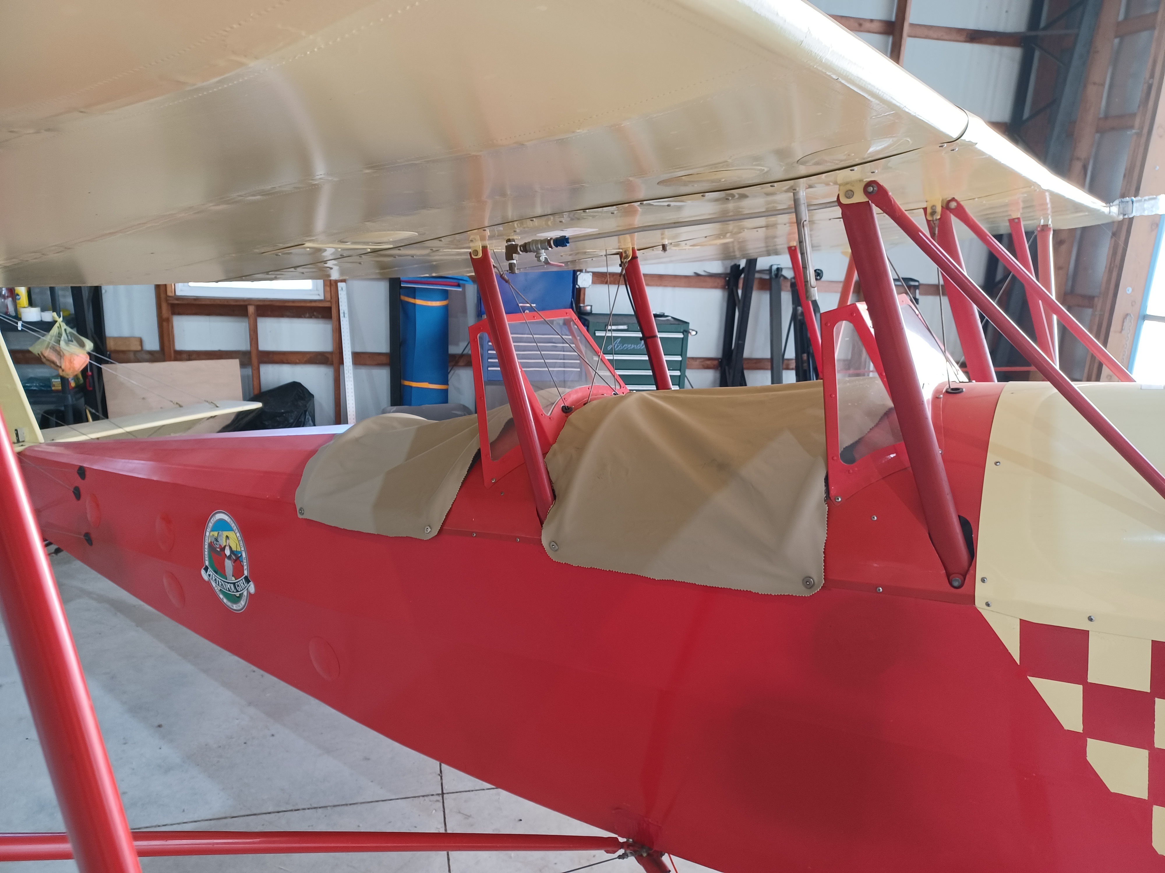

Re: cockpit covers

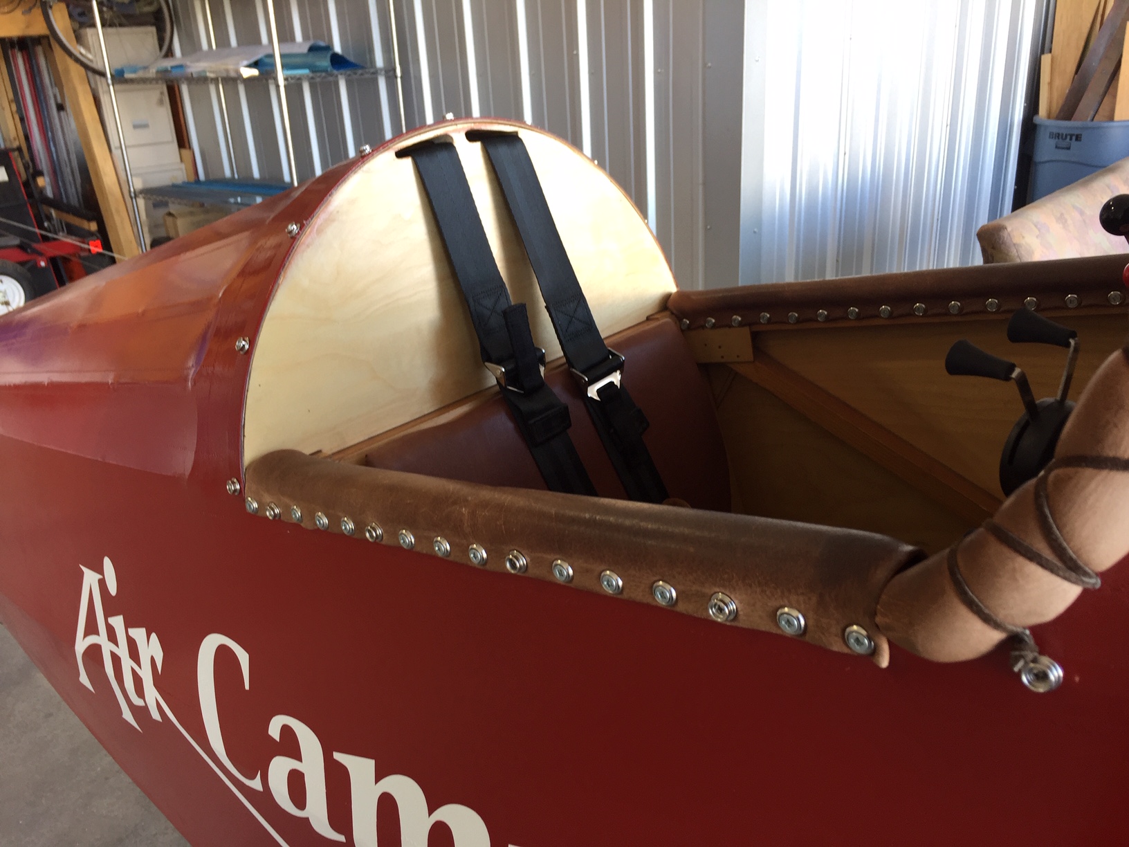

A few weeks ago I made a set of the curved style covers for my piet. I had originally intended to add additional snaps to the forward cover to facilitate flying with it installed but after seeing Dan's across the longerons cover it got me thinking that a simple 1/8" ply plate installed in the same fashion would be a terrific solution for my cold weather flying.
Thanks for the idea!

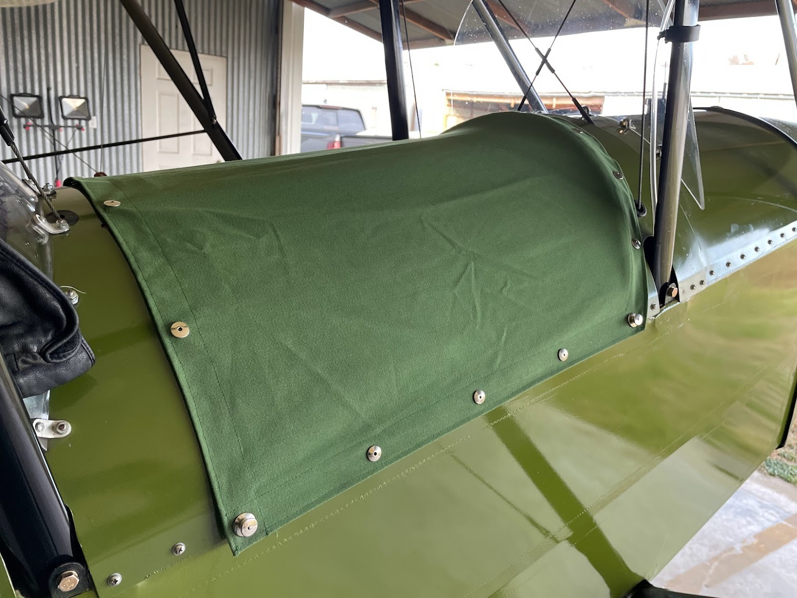

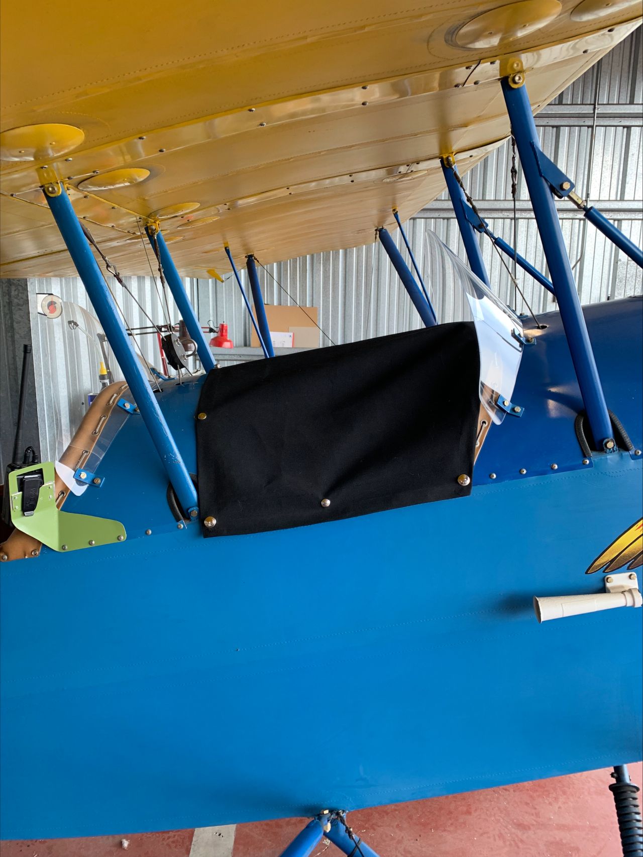

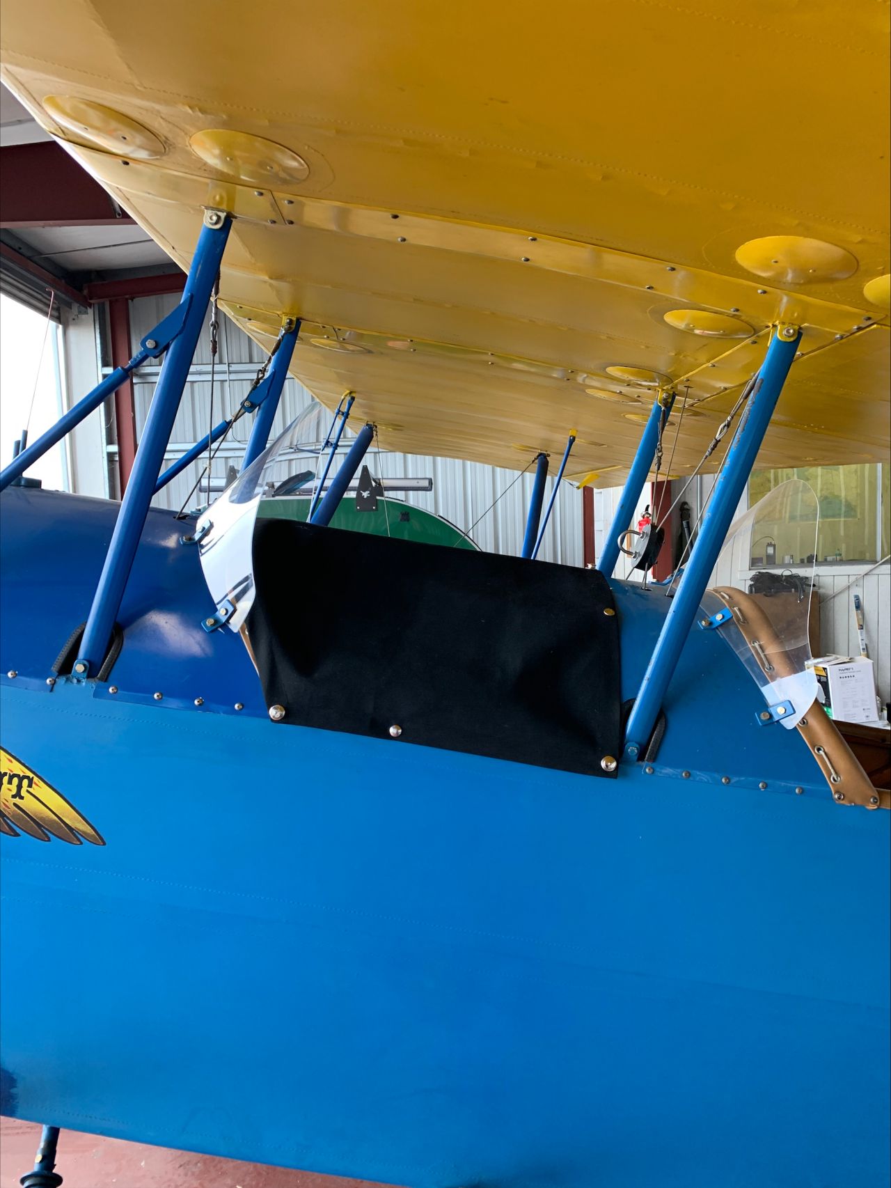

Re: cockpit covers

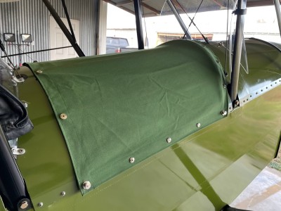

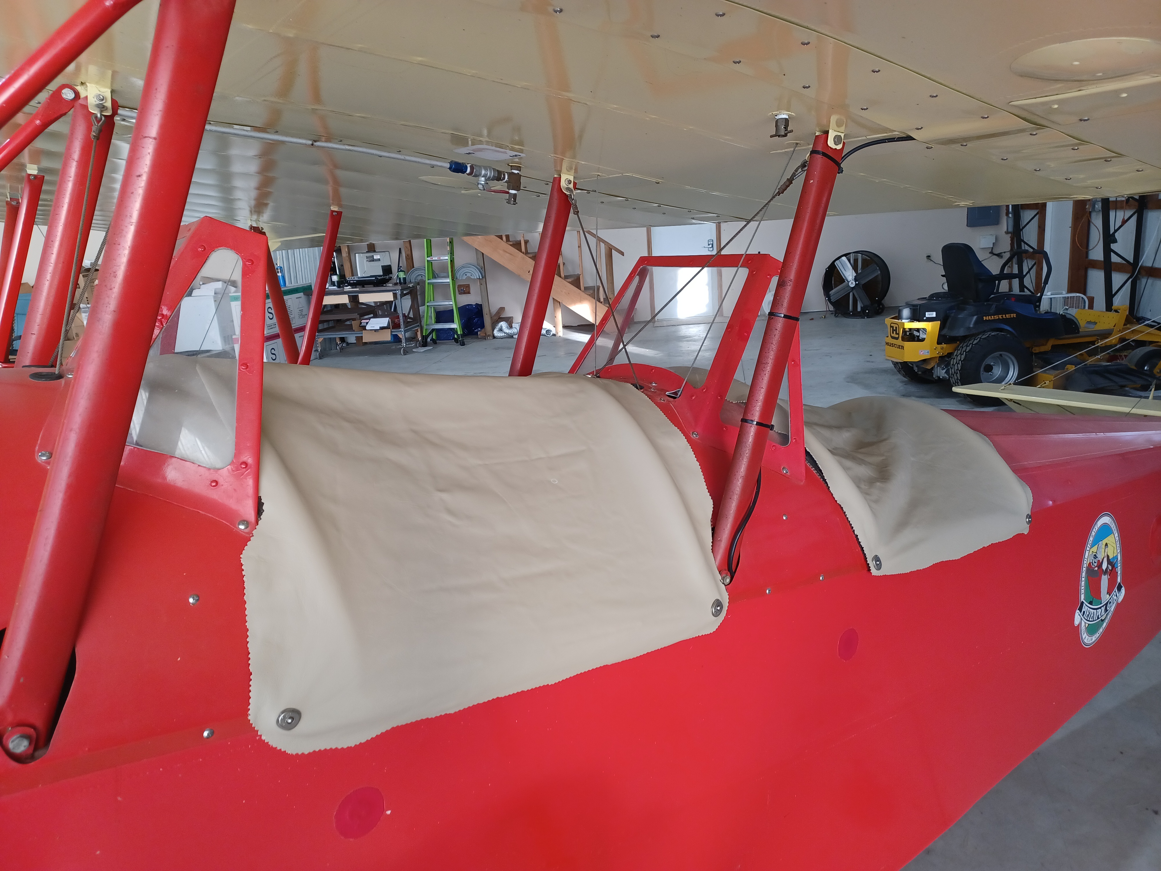

Okay, so I finally got my front cockpit cover fabricated and installed. My thanks to Ken Bickers for the excellent narrative and photos of how he did his, and also the source information for where he got the fasteners and tools. I followed Ken's design but limited mine to only one cover for the front cockpit since I already have one for the rear, which I would never have in place in flight anyway. I also limited the number of fasteners used on mine so as not to make any new holes in anything. The fasteners are very, very secure but I have yet to taxi test or flight test with the cover in place. And mine is nowhere near as nicely fitted as Ken's is but it should be good enough to cut the gale force wind that comes shooting into the front cockpit and back into the rear when it's cold.

Looks good, Oscar.
Soon it will be time to go out and give the new cover a test. Here, we have finally had some days above freezing for the first time in the new year. Today was in the 40s. Still a bit too frosty for me to venture out in an open cockpit, even with the front pit covered.

PIREP: my first experience flying in cold temps with the new cockpit cover (thank you, Ken Bickers for the construction tips!). My report: talk about a world of difference! For me and my plane anyway, having the front cockpit covered during taxi and in flight made a tremendous difference in my comfort. No more cold air blasting up my pant legs or up into the rear cockpit and into my face. I think it's also a tad quieter in the cockpit this way, too. Cold weather flyers: try a front cockpit cover when flying solo, but go for some good attachment hardware. The stuff that I used, on Ken's recommendation, is from Sailrite and is designed for boats and awnings and things like that. Snaps that really snap, and some nifty "Loxx" fasteners that attach and release quickly, but when in place, they hold VERY securely. The plane came with some naugahyde cockpit covers that are fine for keeping dust and debris out of the cockpits in the hangar, but I tried the front one and the ordinary hardware store snaps popped open just in taxi and propwash so I decided to copy Ken's covers. Also, take extra time fitting the cover snugly when you fabricate it. Nothing worse that having a loose-fitting cover drumming around right in front of you in flight.

Re: cockpit covers
Nice job of color selection, very nice installation of the fasteners, and the cover looks nice and taut. Let's have a PIREP once you fly it!
Re: cockpit covers
Looks good, Bob. Nice job on the cover.

Re: cockpit covers

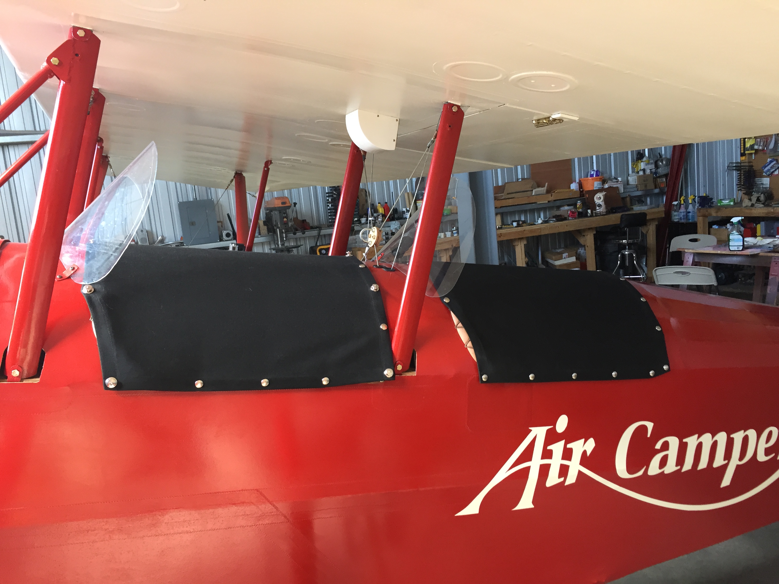

Thanks for the kind words, Ken and Oscar. Pirep: quieter, warmer and less drafty.
- I think I have about the right number of fasteners -- I went back and forth on how many to use. Not like a certified plane or kit where you just follow the instructions.
- Standard snaps from Sailrite. Loxx are super easy to install, after making a hole they just screw on to the fabric.
- I used a Harbor Freight tarp which is truly tough and has zero stretch. I did try to get it taut without going crazy with it while installing with the spikes that Sailrite sells.
- I got some samples of stretchier faux leather that color matches better but I have a plan to redo all the aluminum coaming along with the cowl anyway, so the new covers will be different.
- Happy with just the 4 Loxx fasteners in the corners. They are an insurance policy, as there is no way the cover is coming off of those 4 points. Fear would be damaging the plane with a flopping cover.
- folded back and marked a 1" hem and had a local tailorshop do the sewing - $35
