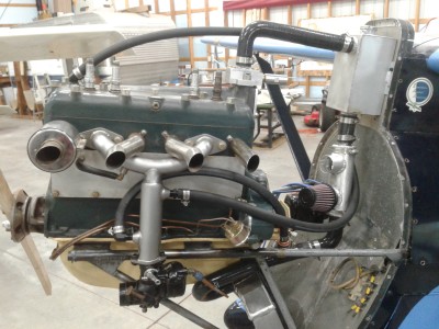

It has been challenging getting the Ford engine and all of the engine systems mounted in the Corben. The underslung radiator and tight cowling have created the main headaches. I think it is getting close to run-able.
